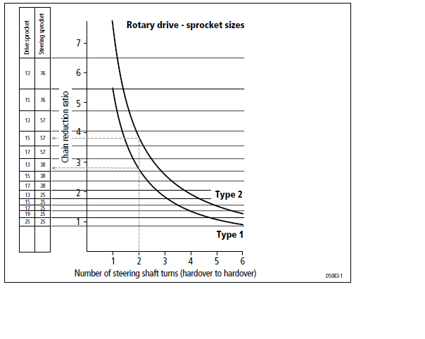

Hi I have a rotary drive type 2 for my hunter sailboat and I need the sprockets and chain to complete my installation....
question
who supplies the chain and the sprockets
and what info do I need to know, so that I get the right size gears (teeth) to work with a EV400 sail
is there anything else I need to know would be a great help
