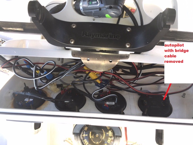

here is a picture to show the instrument set- with autopilot bridge cable disconnected. As soon as I plug in the bridge cable to the autopilot , autopilot comes onto E7D screen BUT you cant calibrate the autopilot- no matter how many turns or how long you wait- also if you now select auto , the course will drift to either port or stbd- depending upon which correction direction was last selected by about 1 degree every 30 or so seconds. My marine elec. said it is simply a case of new not wanting to talk to old?? but raymarine say this shouldn't be a problem??
Feb 6, 1998
11,711
Isolate the Seatalk ng to Seatalk 1 cable to ONLY feed the AP head. Remove all other Seatalk connections from the AP. I see some real sketchy SeaTalk1 splices. If it works the issue is likely in your SeaTalk 1 bus...
eianm
Jul 7, 2010
523
Hunter 42 Sydney
the marine elec did in fact try this last week- but no good- He said he thinks the type 300 computer maybe too old to talk to the new E7D??
