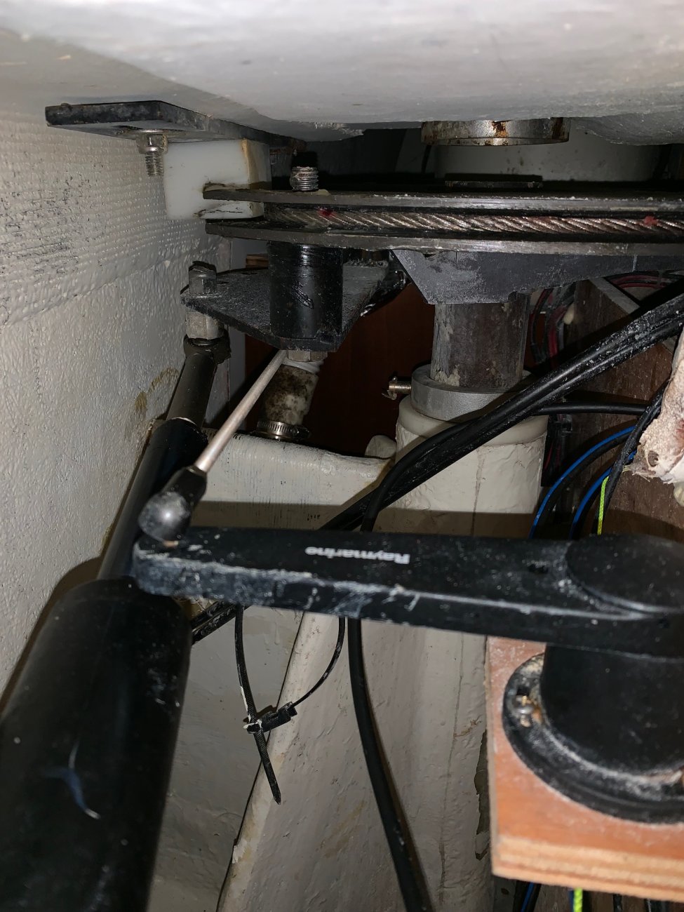

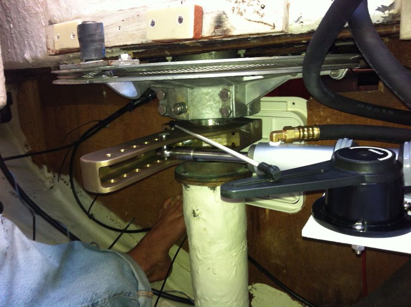

Has anyone else on here installed the EV-200 autopilot on their 2-cabin B361? There was a thread a couple years ago in which an owner of a three-cabin B361 installed the EV-200 with pictures, but my installer is struggling to figure out how to mount the below deck tiller RAM (or whatever it's called) to the rudder.

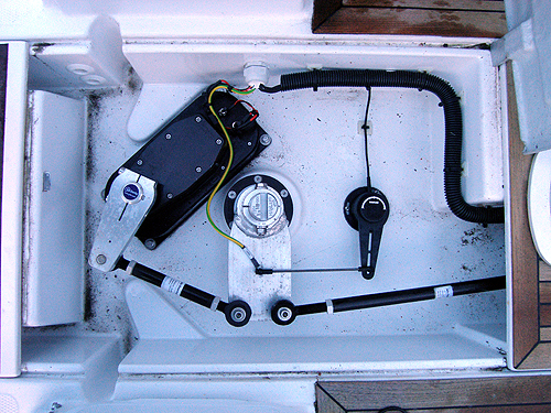

Attached is a pic from that thread you're talking about. The other pic is showing the arm you're also talking about, I think.
It is not from a Bene. It doesn't look like there is enough room to mount an arm and I believe that's why the method in the first pic was chosen.

Thanks Philip and Joker. Yes, I agree there isn't enough room for the autopilot steering arm (RAM, I think it's called?), which if I understand correctly Philip made work by having a steel piece fabricated. I think that's what I need.
Nov 23, 2009
437
Beneteau Oceanis 361 Clipper --
That fabricated stainless steel piece is nothing special. Anybody dealing with s/s work can make one and you can attached it at the quadrant.

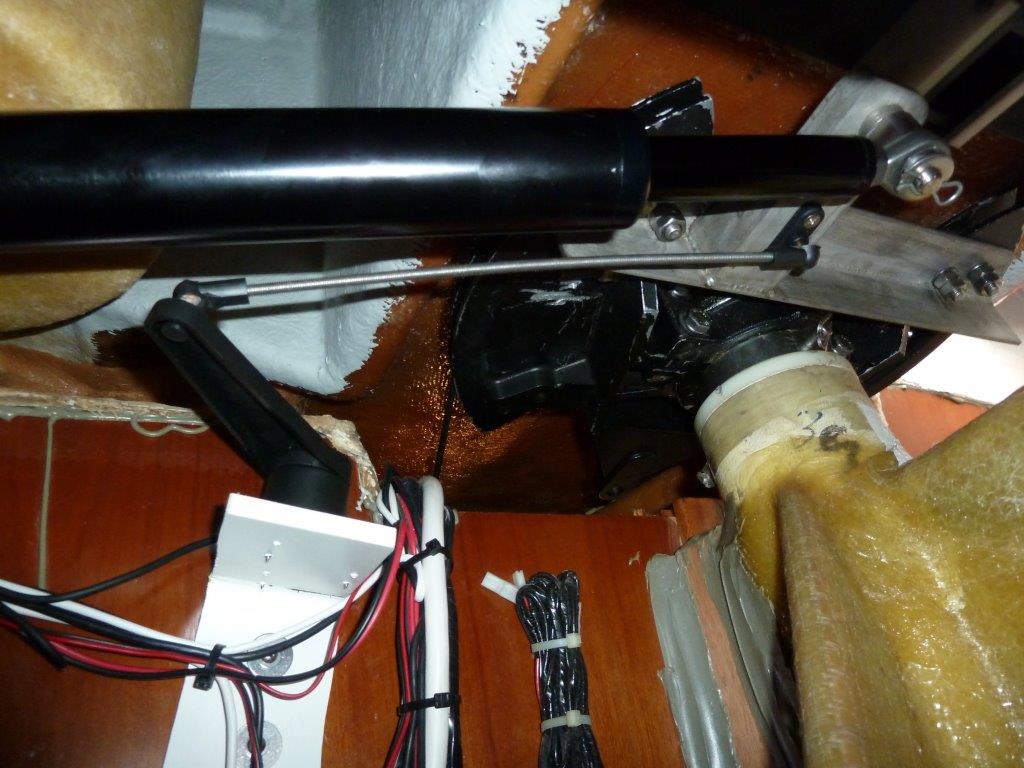

3.) open up an area to access the rudder shaft where the manual arm would attach. Also an expensive option. See attached pic
which is not a Bene 361. I don't know what that area looks like on a 361 but it gives you an idea.

My installer thinks we can still make it work, possibly by having a piece fabricated like picture number 2 of your post above (post #2).

There is a guy who I conversed with who had a factory installed EV-200 linear drive installed in his Beneteau 343. Evidently Beneteau had a bracket fabricated and thru bolted to the steering quadrant as an attachment point for the linear extension arm. I will attach a photo of the bracket.
Wonder if you could contact Ward at Beneteau, SC to determine if they have a drawing of the bracket that they used on below deck auto pilots on the 361??? May be possible for them to fabricate and forward to you. Might have to cut out a panel of the aft end of the berth area to access the area for installation and use a water tight, locking panel to close the hole and permit future access.
