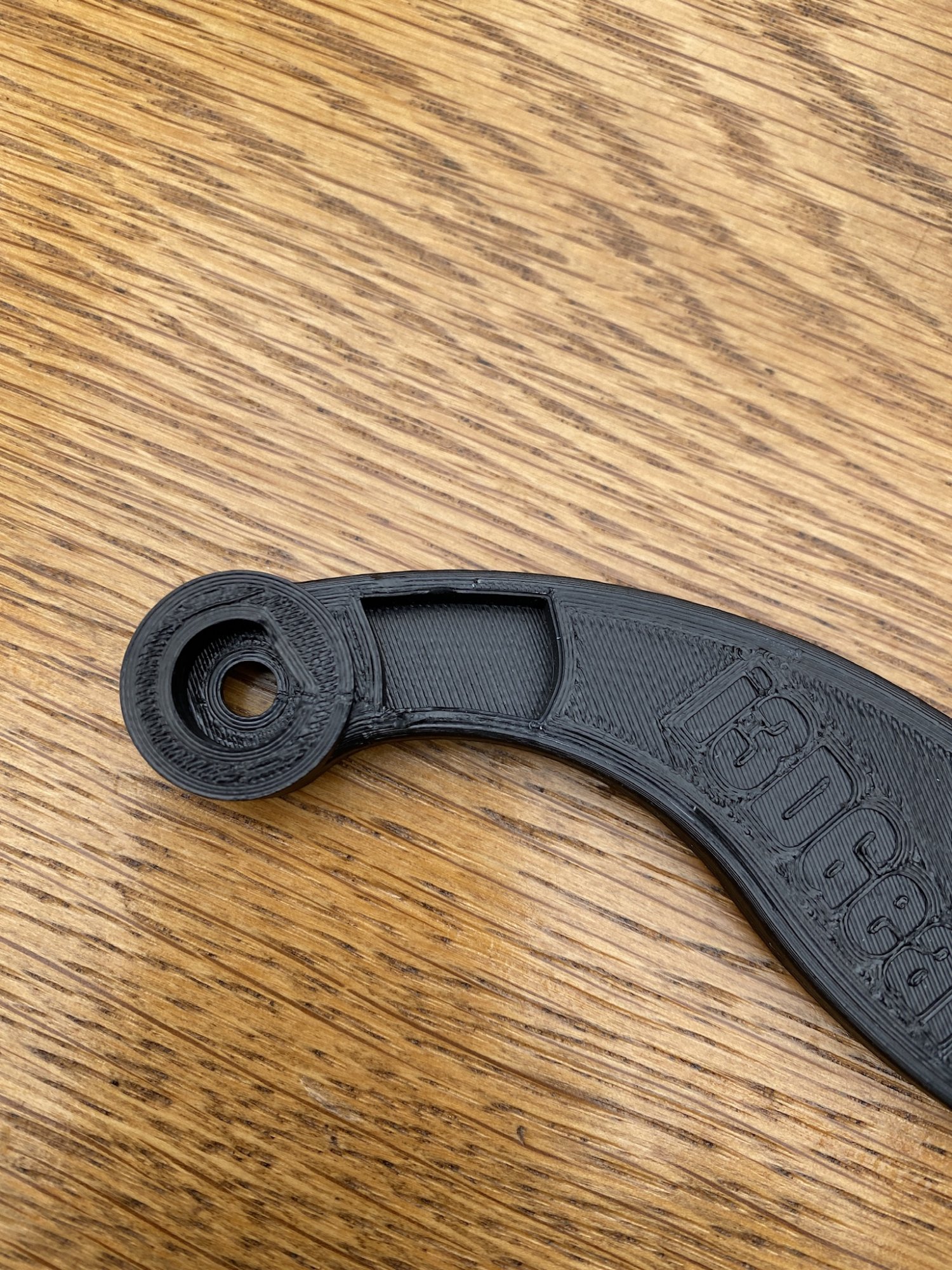

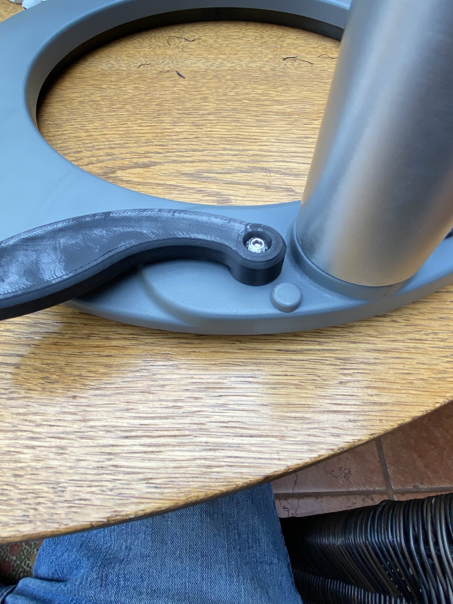

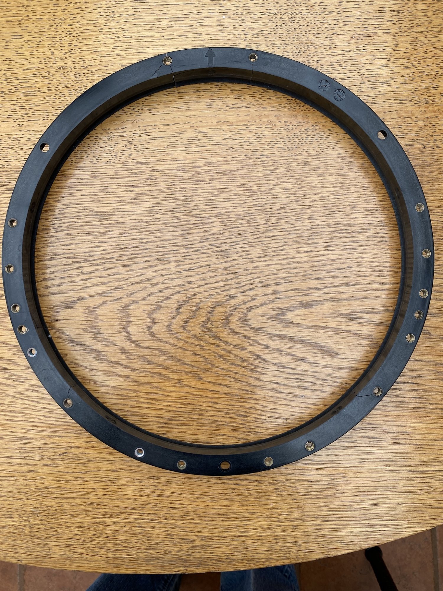

24,876
Yes. The drive ring developed cracks in the areas of the metal inserts. It eventually broke in multiple places.
the redesigned unit from 3DGear is believed to be stronger. I have not seen the finished product, yet. Here is the prototype.
The clutch uses a soft material. I worked with 3DGear to test new material,
And helped redesign the area on the under side. This new clutch has a larger under cut to better fit over the wheel nub. It is intended to hold the clutch. It is designed to release the clutch should the AP jam or under pressure. It is also Serbs to be quickly released it moved by the operator.
The symptoms I observed were
  • a jumping of the wheel,
  • Stiff resistance to manual movement. I believe this happens when the bearings get trapped in the cracks
  • Sticking or lack releasing drive ring when the clutch is released

24,876
I believe it is lighter in density. The guy at 3D thought it was the plastic they used. And the thickness of the molded extrusion at the rivetNuts. I bought it Dec 2016. Installed in April 2017. Showed evidence of issues Sept 2019. I isolated the problems and resolved them in Oct 2021 by replacing the drive ring.
2020 doesn’t count. No real sailing accomplished.
I’d guess about 150 hrs of use.
My sense is the parts are under engineered.
