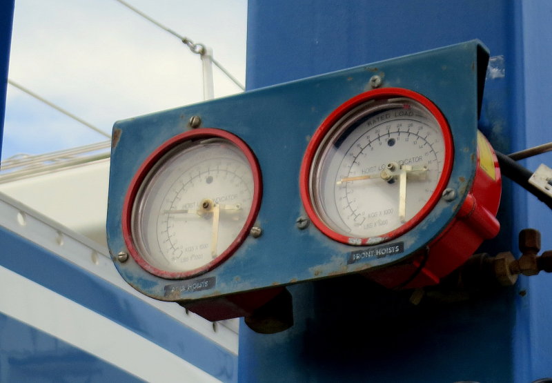

She's kind of a pig, 9600 pounds on the front straps and 9300 on the rear straps or 18,900 pounds. This scale had recently been "calibrated" but they are still never 100% accurate.
For reference this weight was no spar, no sail inventory, no water, no fuel, empty holding tank, no canvas, and most gear already removed.... She carries 100 gallons of water, has a 38 gallon holding tank and a 42 gallon fuel tank so add all that to the scale weight to see what a wheel pilot can really do.........
