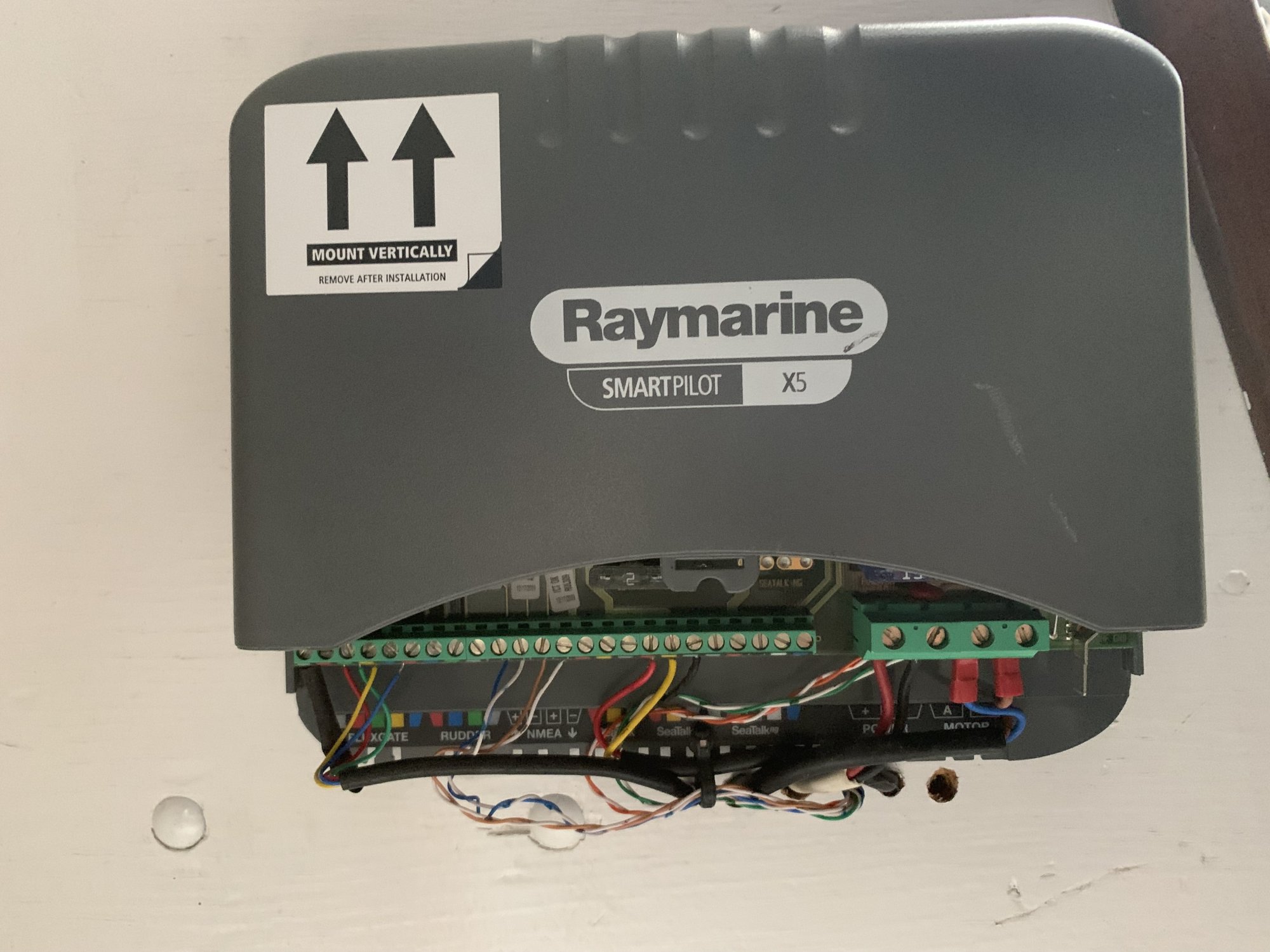

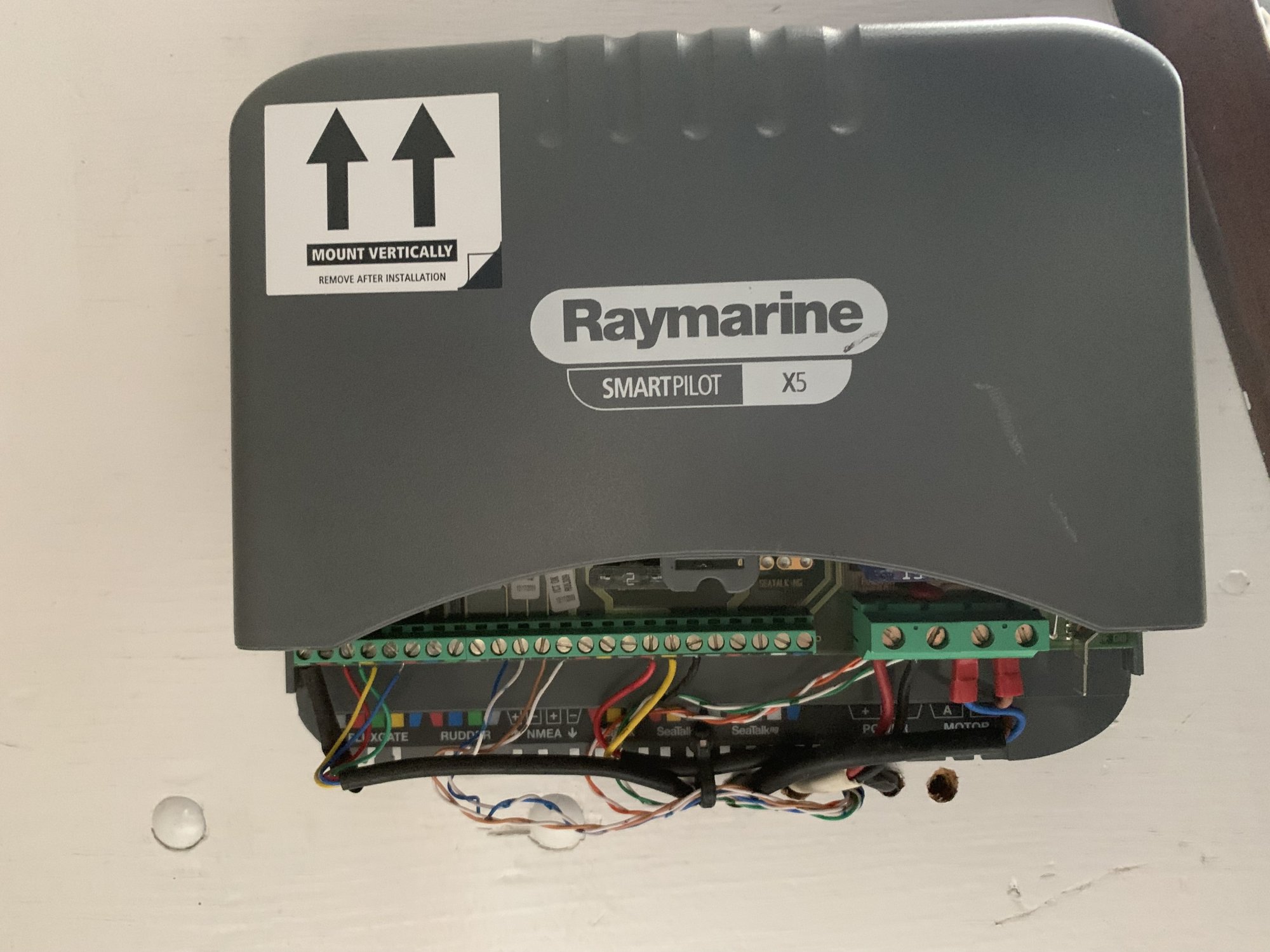

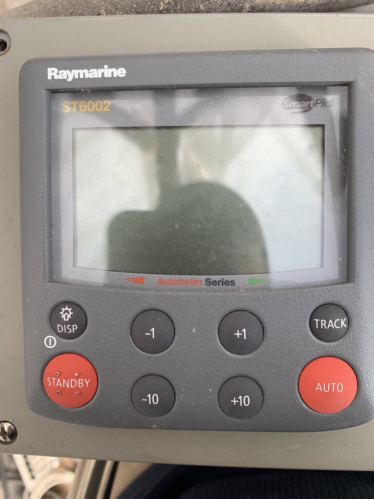

I have a Raymarine ST 6002 Auto helm thats tied into the smart pilot X5. This was on the boat when I bought it.

On the back of the ST6002 is an empty SeaTalk port, could I use this to tie in my chart plotter?

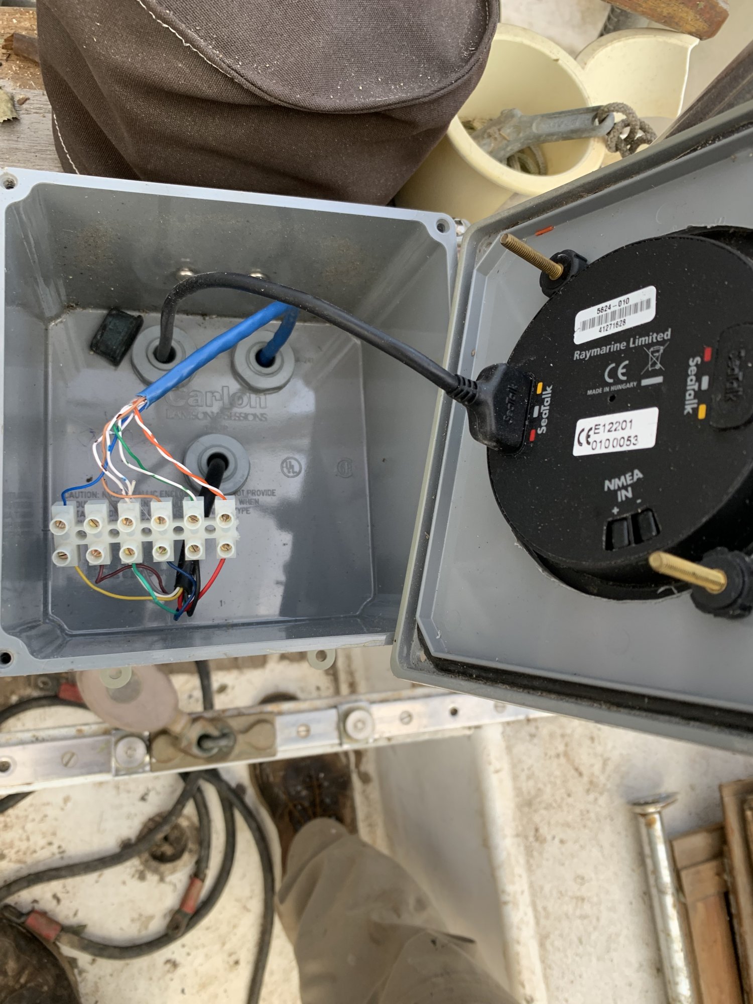

Here are some pics as to what I am looking at.
Should my chart plotter wire into the AIS or smart pilot X5, or can I adapt it to plug into the other port on the ST6002
Note: the old chartplotter Standard Horizon CP 300i is tied into that white junction block with the blue data cable on the other end going to the smart pilot X5

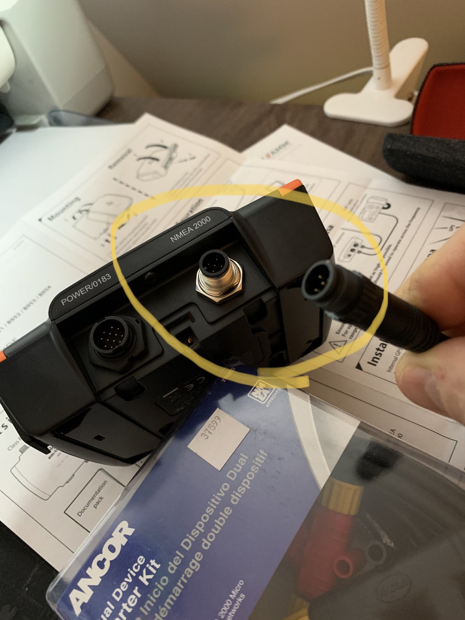

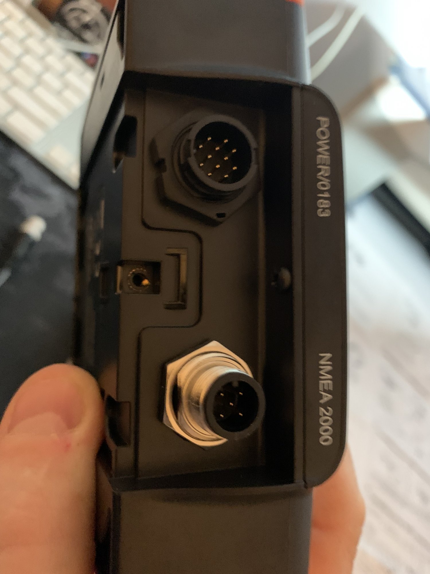

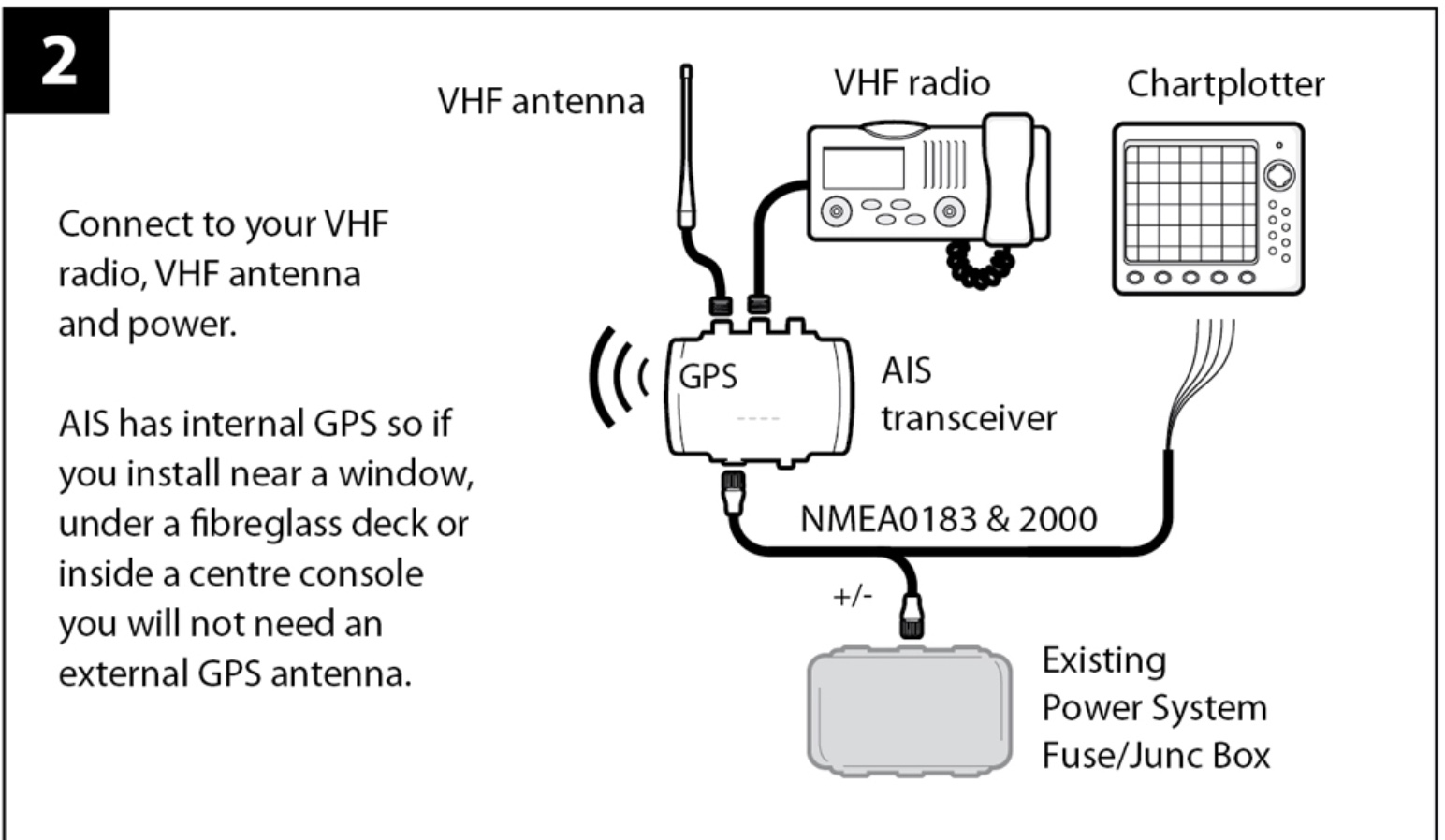

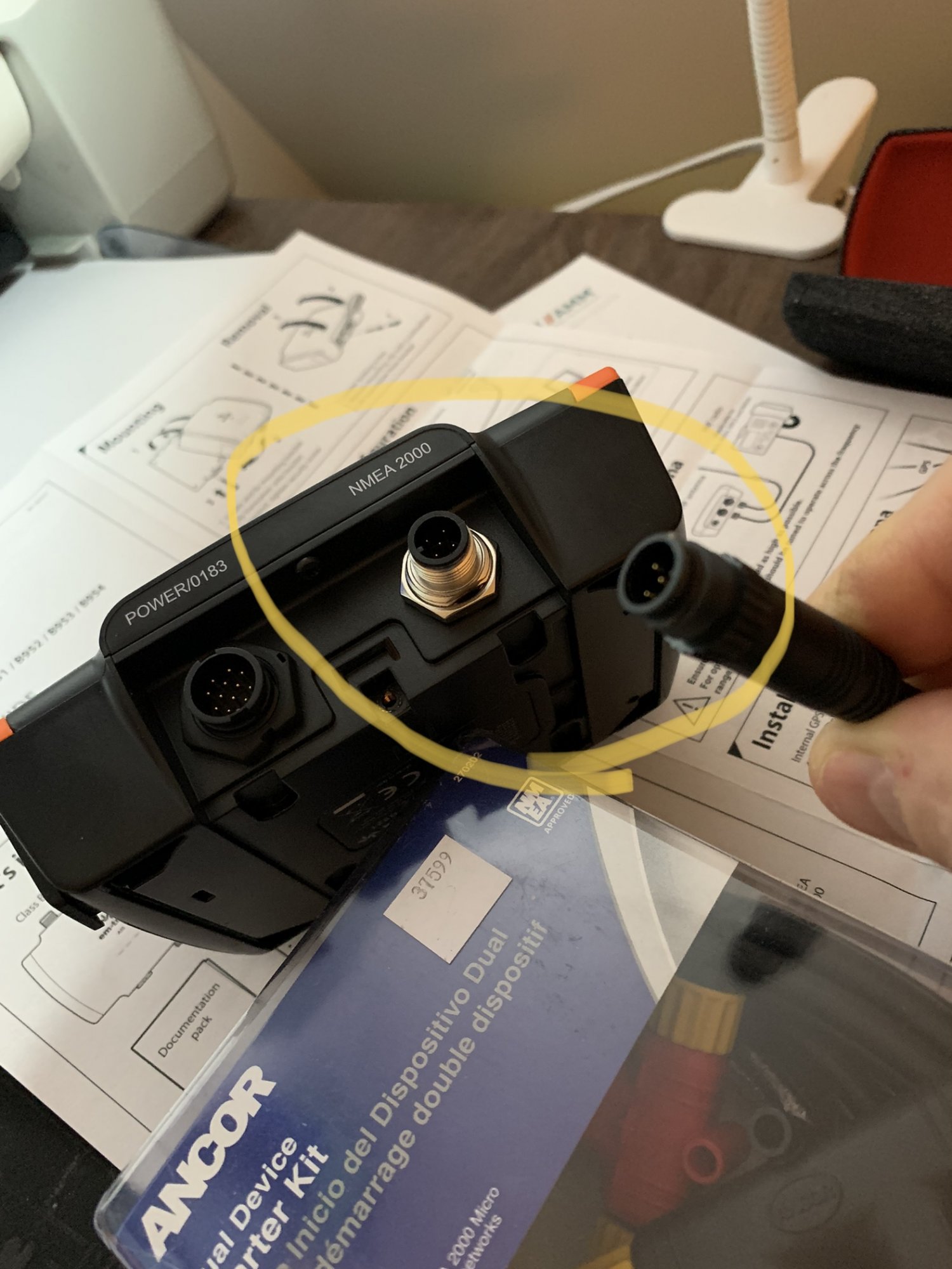

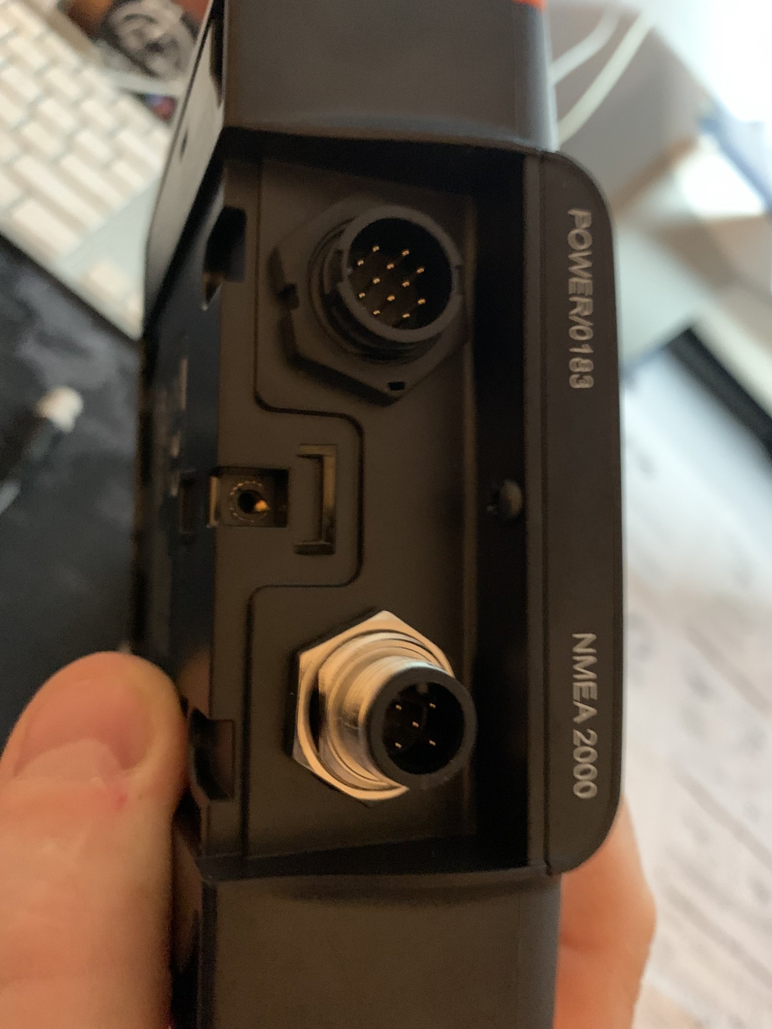

Based on the pic I have included here. I will need to use the NMEA 0183 cable that came with the AIS just for powering the unit and do not connect the other NMEA wire to anything.
Then connect the wire that i am holding in the second pic to the NMEA 2000 port and I am done. The wire that I am holding in the pic is from the Axiom and has another lead coming from it for power. Both unit (Axiom + AIS) connected to each other and powered seperately. No need to connect it to the pilot. I would just have to set my course manually on the ST6002, thats not an issue.
Do I have it figured out?????????

Hello,
I believe you are correct. Use the power cable to provide power to the unit. You don't need to connect and of the other wires, just 12V power and ground. Use the NMEA2000 cable to connect the unit to your network (plotter).
Barry

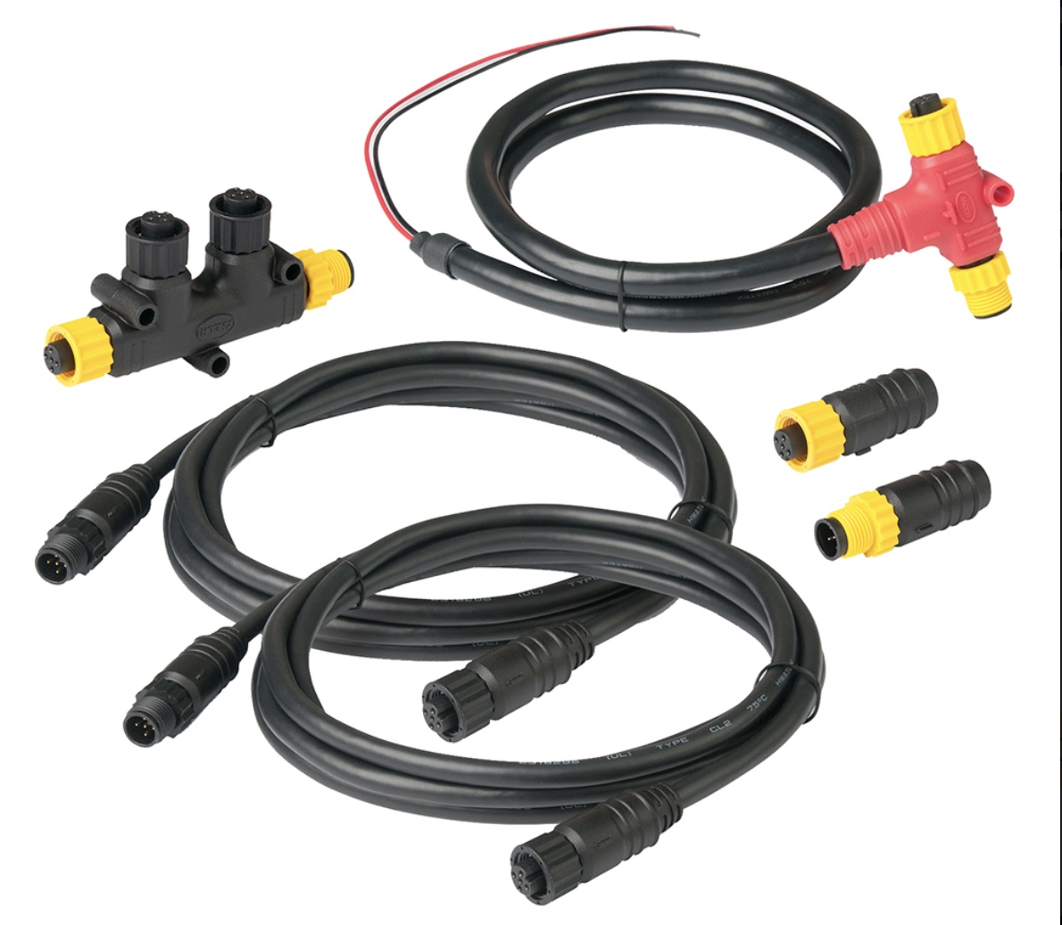

The AIS N2K port will connect to one drop port on the Ancor dual device kit, the Axiom N2K port will connect to the other. A terminator will go in one side of the Ancor double T, and on the other side a backbone cable to the N2K power cable T. The second terminator will go on the other side of the power T.
EDIT: Actually I think the power T will connect directly to the double T without a backbone cable.

Ok guys I thing we are all on the same page here and I am a lot further ahead. One other thing, and yes that is the exact Anchor kit that I have, do I need to use this powered NMEA 2000 "T" that is in the kit? The AIS will have power when I use 0183 port that is labeled "power" also. And the Axiom has the 5 pin NMEA cable coming from the larger that plugs right in.
John, the Axiom will plug right in to the Anchor kit with the cable provided.
I am thinking that the red tee is not needed in this case as both units have its own power. This maybe for some other units that may require power. I really don't know and just guessing at this point. Does anyone know for sure here guys???????????? Red Tee or not????
24,656
Frill. To answer the question you need to examine the systems you plan to connect to the backbone.
The axiom is connected to it’s own power source because it draws power at a rate greater than can be provided by the network backbone. It does not share this power with the network. The connectors to the network are data signals both incoming and outgoing.
You need to understand the other components. As an example, a wind sensor uses low power to run the electrical elements of it’s system. It gets needed power from the network backbone.
12,970
What @jssailem said... or alternatively try it with out and if it does not work then the answer is yes.;)
Yes you will need the red T. The N2K network needs power of its own independent of the devices attached to it. Some raymarine autopilot course computers supply this power if connected, but the SPX-5 does not.
