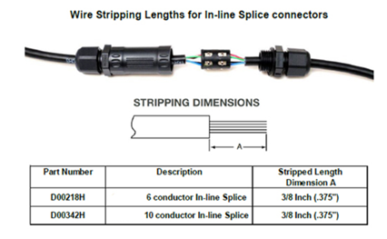

If I were to replace my Raymarine ST40 Depth transducer, can I cut the existing cable and join the new transducer to it instead of laying the new cable?

Pretty sure you can as advised by Airmar when I purchased a replacement Airmar speed transducer that connects to my Raymarine knotmeter display display on my Hunter 386 and was recommended to splice the wires using Airmar IP67 waterproof D00218H Inline Cable Splice 6 Conductor. Suggest contacting Airmar to confirm.

I cut the cable when installing a new DST-800 transducer. Used marine grade heat shrink connectors, then wrapped with electrical tape. Working fine after 1 1/2 years.

Thank you for the assurance. I intend on same.
