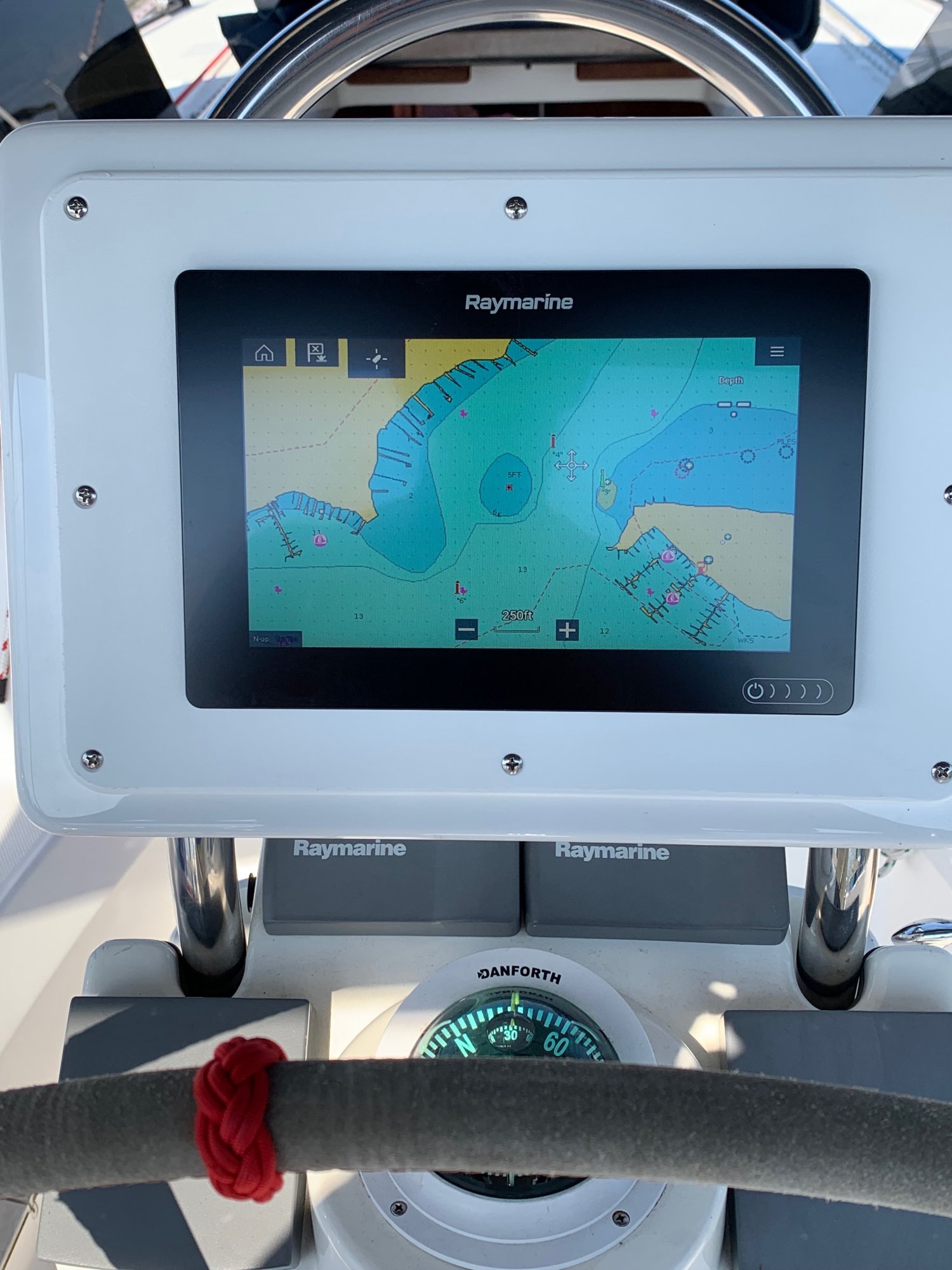

I swapped out a non-functioning C80 for an Axiom 9 in 2021 (Between chart plotters), after wasting way too much money sending the C80 out for repairs to some place in Florida. All I hooked up was the power, using the old power cable from the C80. The new Axiom has worked great for almost 5 years now.
I do sort of wish I'd gotten the 12", but couldn't stomach the price difference and I was thinking it might not fit in the Navpod, depth-wise. In 2021, the 9" was only $863 ($1421 now!). It's around $800 more for the 12". I haven't done anything to hook the old SeaTalk network up to the Axiom: I bought the converter, but have been too lazy to hook it up yet. Too many other boat projects have had higher priority.

Sounds like you already bought one! You'll like it. As I recall, the hole in the Navpod from the C80 was larger than what the Axiom 9 needed, so I bought a thin piece of starboard from some company that rounds over the corners for you, and did the cutout in that myself. I think the result looks pretty close to original (picture above). I guess the alternative is to buy a new front panel from Navpod, and then it would be perfect.
