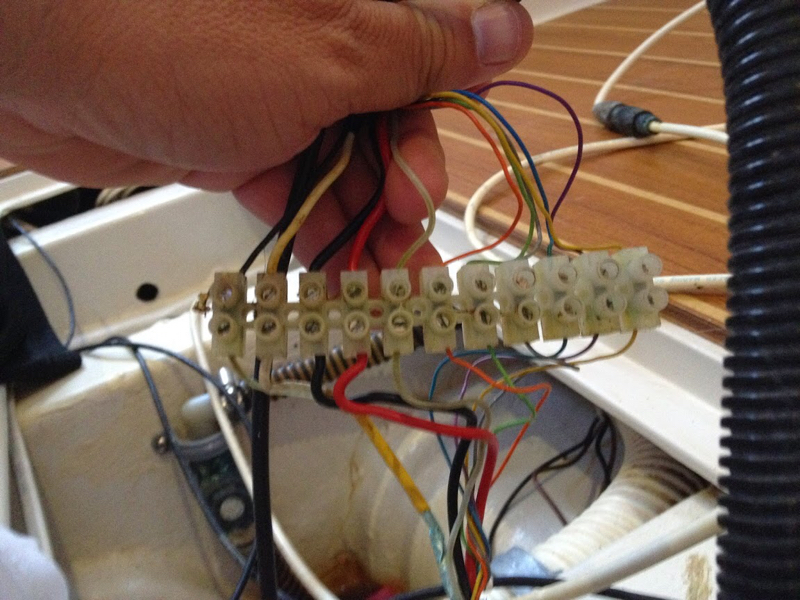

Jack, for anything & everything electrical, if there is intermittent operation it almost 99% connections. I'd check those before assuming the board in the unit is faulty. Good luck.

JK - I have an identical rats nest inside a waterproof box in my boat - what did you replace yours with?

There are many opinions on making terminations, but about the worst thing you can do is put a small wire under a screw and tighten it....real tight. Ring terminals are good for the proper application, but I find that ferrules are very good for small wires when terminated to terminal blocks. I have a small junction box inside the base of my mast that terminates the wind instrument wiring. I dropped my mast this year for maintenance and when I reconnected these wires I used ferrules on the wires in the terminal blocks, then taped the whole box. I found some poor connections on the lighting connections, one of the butt splices actually pulled out when the mast was lowered. I recrimped everything with new connectors and applied heat shrink over the marine splices. Whether its a rats nest in the bilge or a poor connection in the mast, either can fail at the most inopportune time....best to make the proper connections the first time!
(Guess I should look in my bilge to see what mine look like)
