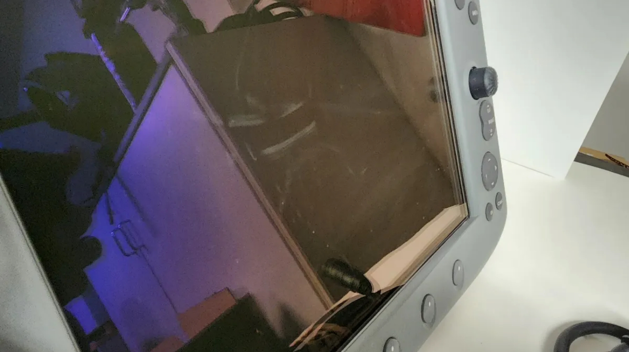

I want to replace the polarizing film on my C120 chartplotter.
DOES ANYONE KNOW THE RIGHT TYPE OF POLARIZING FILM TO USE?
There was a YouTube that showed how to do it. It has been removed.

Removed the damaged film on my C120 with a polish recommended by Raymarine. That was years ago and I never considered replacing the film. Why would you want to replace the film?
Dec 19, 2019
28
Hunter 41DS Punta Gorda

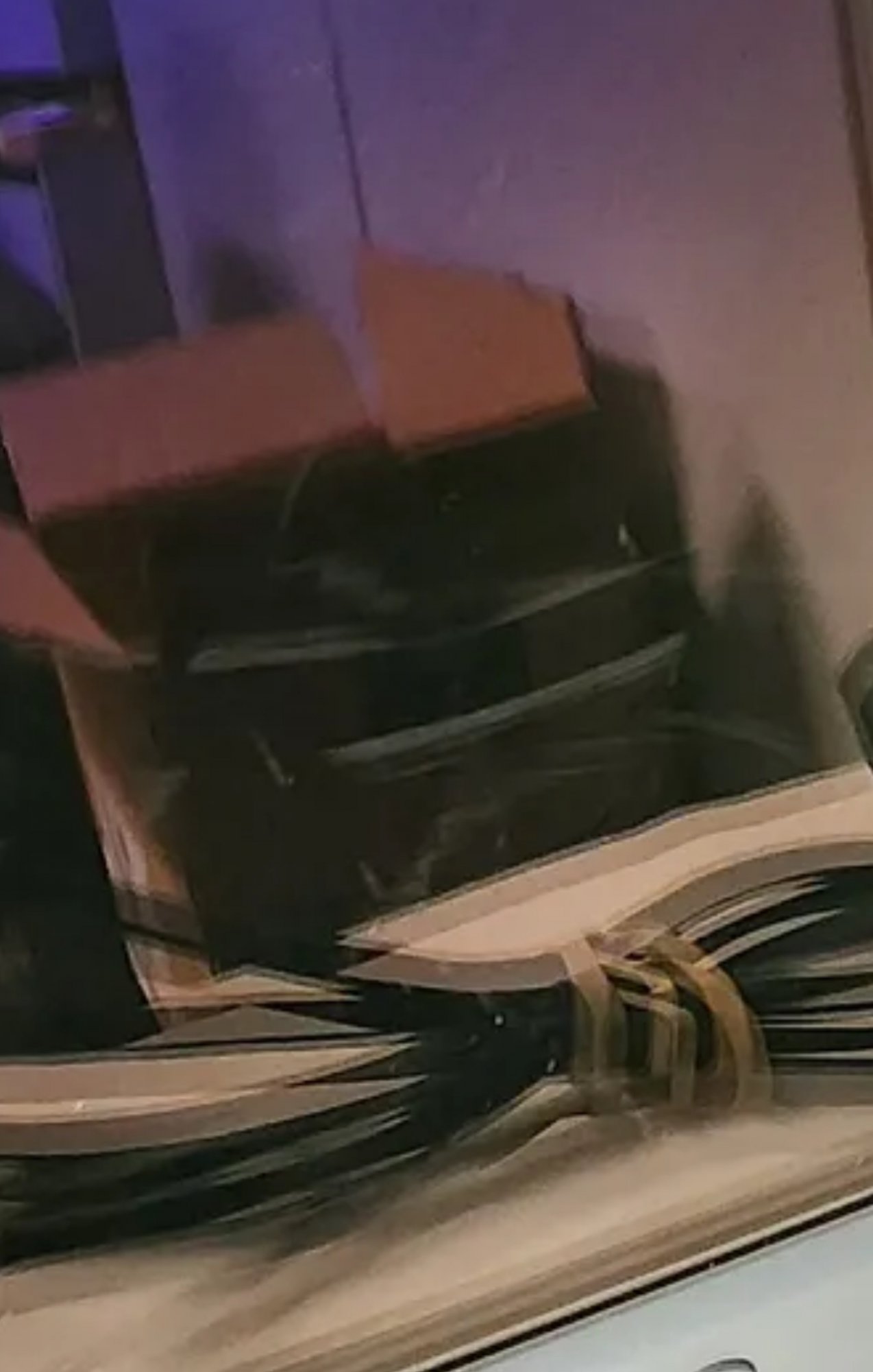

Once the film is completely removed, you cannot see any detail on the screen. This youtube shows it pretty good.
Does the Raymarine use 0 degrees or 90 degrees film? There are different thicknesses too.

Interesting. There must be two layers of film over the screen. The one I removed was very thin and polished off with little effort. This was a standard procedure suggested by Raymarine. That layer would likely be damaged if you used Windex or a similar cleaner to clean your screen. My screen without this top layer is still polarized as it conflicts with my sunglasses.
