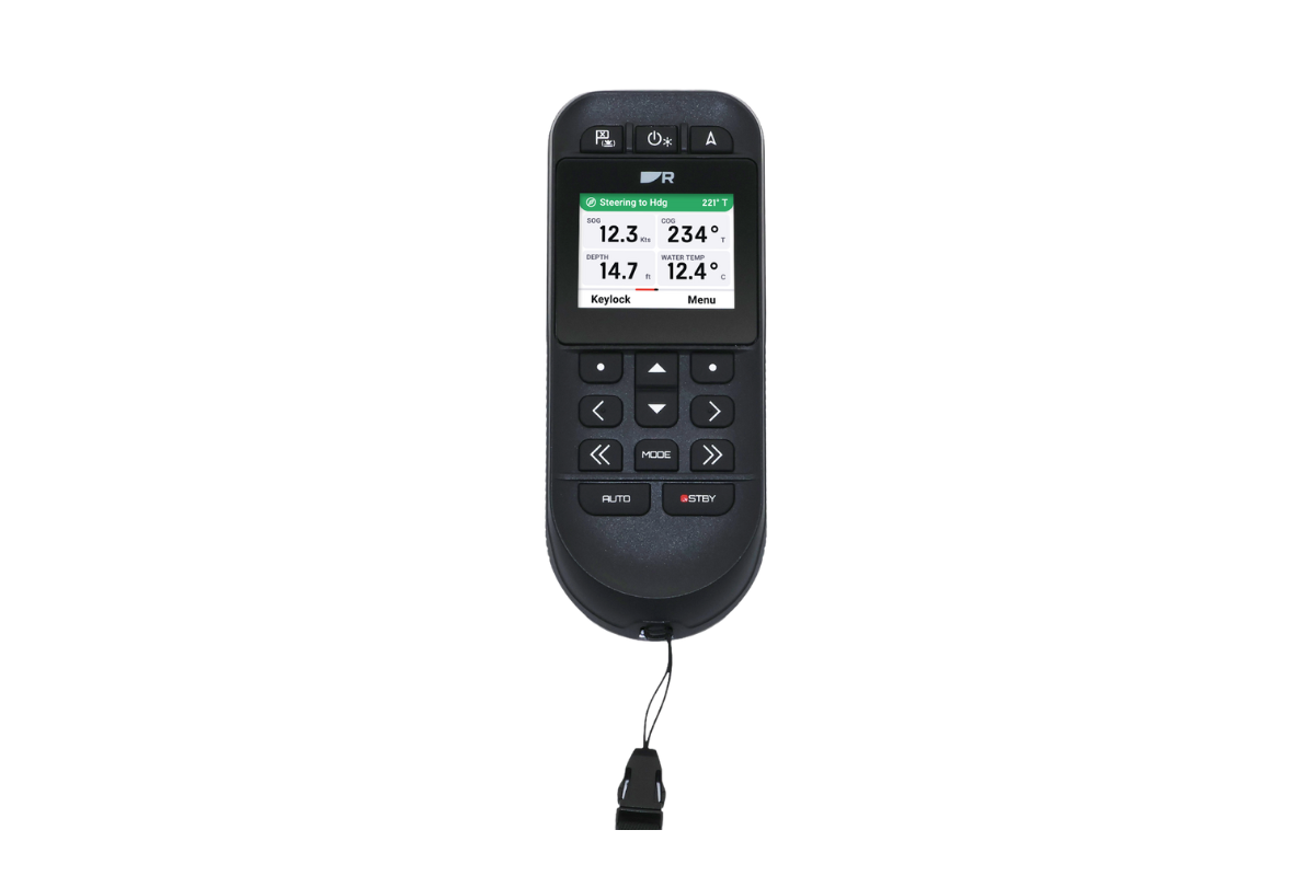

Have any of you installed the Raymarine autopilot wireless remote control (RCU-1)? If so, is the convenience worth the cost and was the installation process relatively easy?

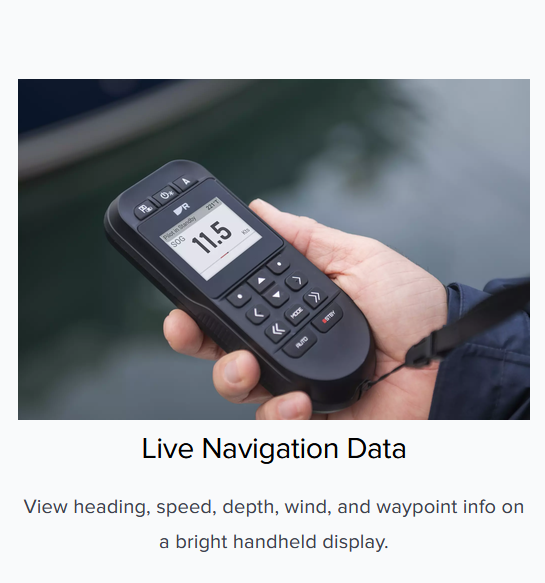

RE: If so, is the convenience worth the cost and was the installation process relatively easy?
I have a Raymarine tillerpilot with a remote controller that came with the boat. I played with it 5 years ago and haven't used it since.
However I went to the Raymarine page and check the unit that you are interested in ($299 USD).
There was the usual blurb, "Intuitive Control" and "Built for the Marine environment".
However there are became aware of some interesting features.

I have a different Raymarine unit than you are referencing. Mine allows steering and also repeats speed, depth, wind, and way point info. I use it when I'm in the cockpit on the stern seat. I can relax, have an excellent view forward, and use the remote to dodge lobster pots.
