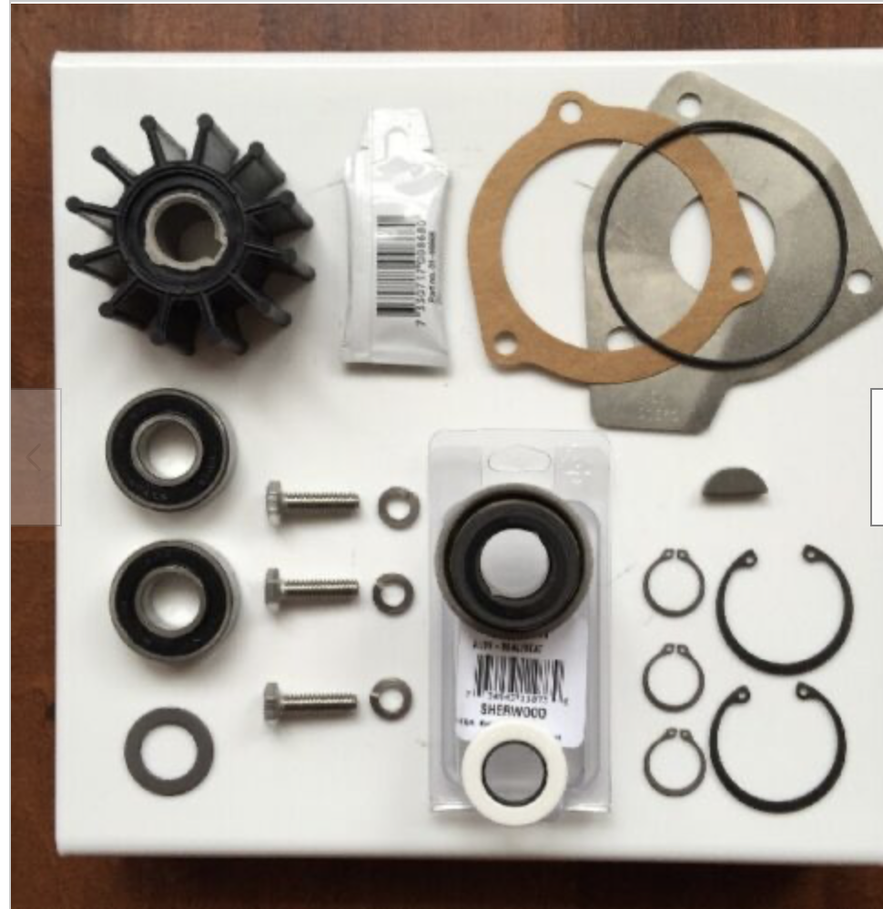

My guess is your new water pump impeller was not installed correctly
Jim...

If had looked up the Owners Manual, like I did, and told West Marine it was the
SHERWOOD WATER PUMP NO, 302648
He would have gotten the right parts.
But...
We all had to learn about our water pumps , the first time.

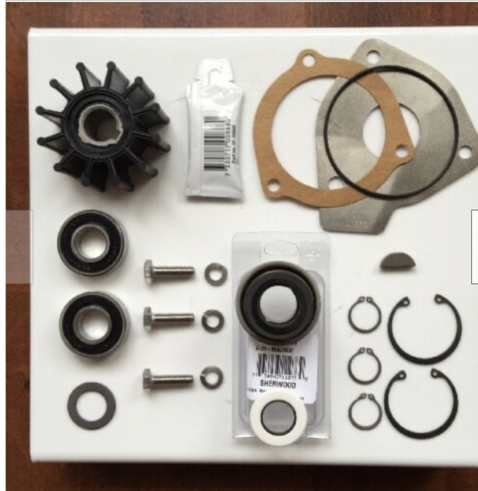

Even part #9 :facepalm:
Jim...
PS: @ToddH read your Engine manual.

Sorry my bad should have said item number on the list that James gave us. There was no part number listed for that item with the note: Not Available Order #13. The short explanation wasn't clear to me as to whether the pump wasn't circulating or waye wasn't being circulated.
