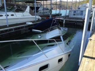

Seacock related sinking here in Maine...
Boat US:
"If the boat must be left in the water, the thru-hulls have to be protected by closing all seacocks and gate valves.
Failure to close thru-hulls is a major cause of loss in the BoatU.S. insurance program. In a recent study of 40 winter-related claims, seacocks or gate valves left open caused or contributed to the sinking of seven of the boats in the sample group.
If the boat must be left in the water, the thru-hulls have to be protected by closing all seacocks and gate valves."
"This boat in Maryland sank when it's plastic thru-hull was shoved underwater by the weight of the snow. the intake was broken by ice"
This boat sank due to a failed sea strainer, which is after the seacock. 100% preventable, if the seacock had been closed...
