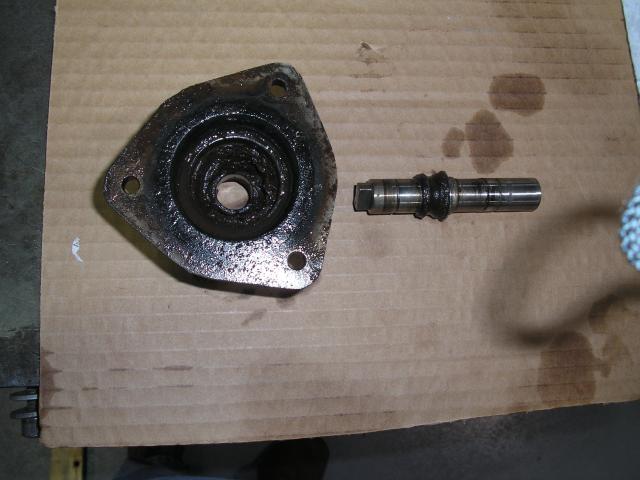

Wow, I got the shaft out of my raw water pump. If you look closely you can see the inner race of what remains of a bearing still on the shaft. I soaked the pump in mineral spirits overnight to loosen up the gunk before trying to remove the shaft. I have a small arbor press but if I didn't I would not have been able to remove it. There where 3 very rusted balls left from what was once a bearing. There was a 1/4" play in the shaft before I started to remove it. This was a disaster waiting to happen!
Stephen, where did you buy the Oberdorfer?
