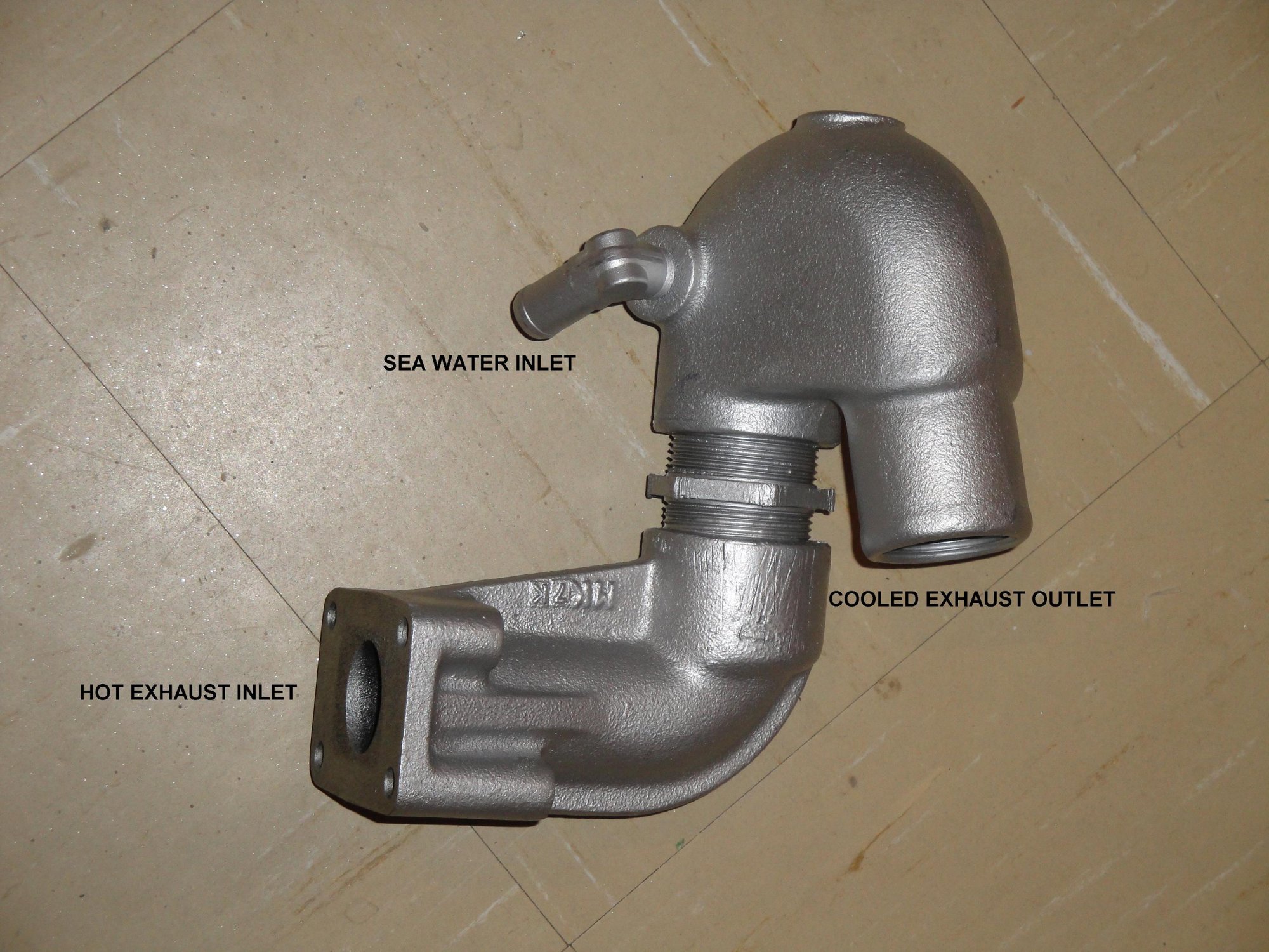

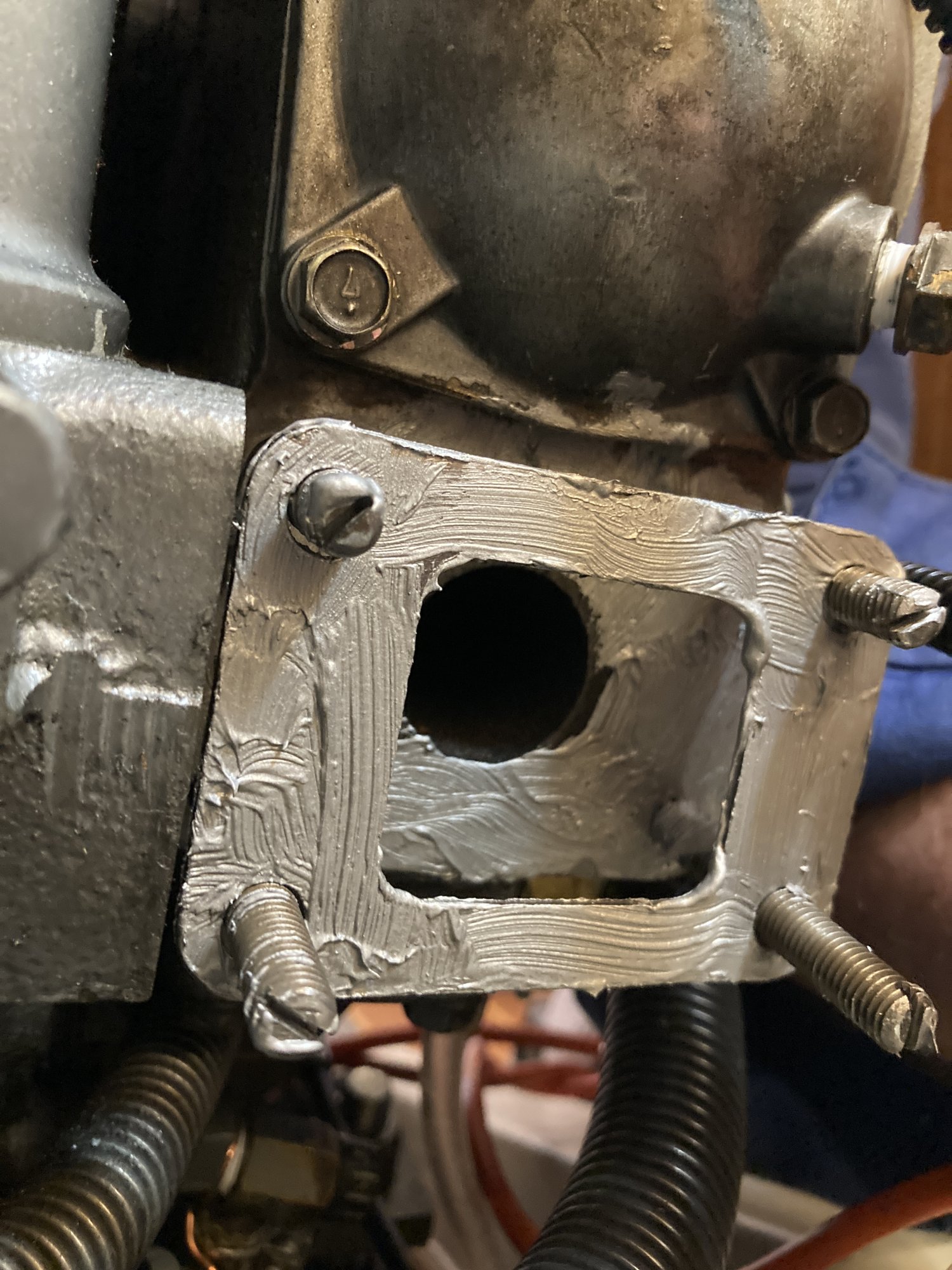

One thing I have learned over the years where you are stuck trying to attach anything to the block using bolts is to screw a few temporary studs into the block first to act as a guide. Below is the most disagreeable task imaginable on the rear of my engine .................. removing and inspecting the mixing elbow every few years:
The four studs are only temporary, hold the gasket, and the monster piece below slides into place along with its slippery little gasket:
............. the studs are then removed one at a time and replaced with the original bolts. I know, I know, I could leave in the studs in but I'm not happy until it's back to its original condition.
This has gone from one of the worst jobs of trying to handle everything with 1.25 hands to a one handed piece of cake.
