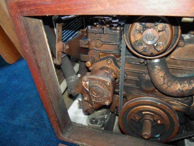

Is the part number for this Oberdorfer pump: part# N2002M-15
This is a Universal M25XP on a '89 Catalina Mk II

The pump is the Oberdorfer 301357. Torresen Marine says the 202m-15 can be used as an alternate or replacement for the 301357 in most cases.
http://www.marinedieseldirect.com/universal/200142/oberdorfer-water-pump.htm
http://shop.torresen.com/ships_store/index.php?p=details&mfc=OBERDORFER&sku=202M15&frm=g
I don't know if it really matters, but it looks like your v belt is installed backwards.
