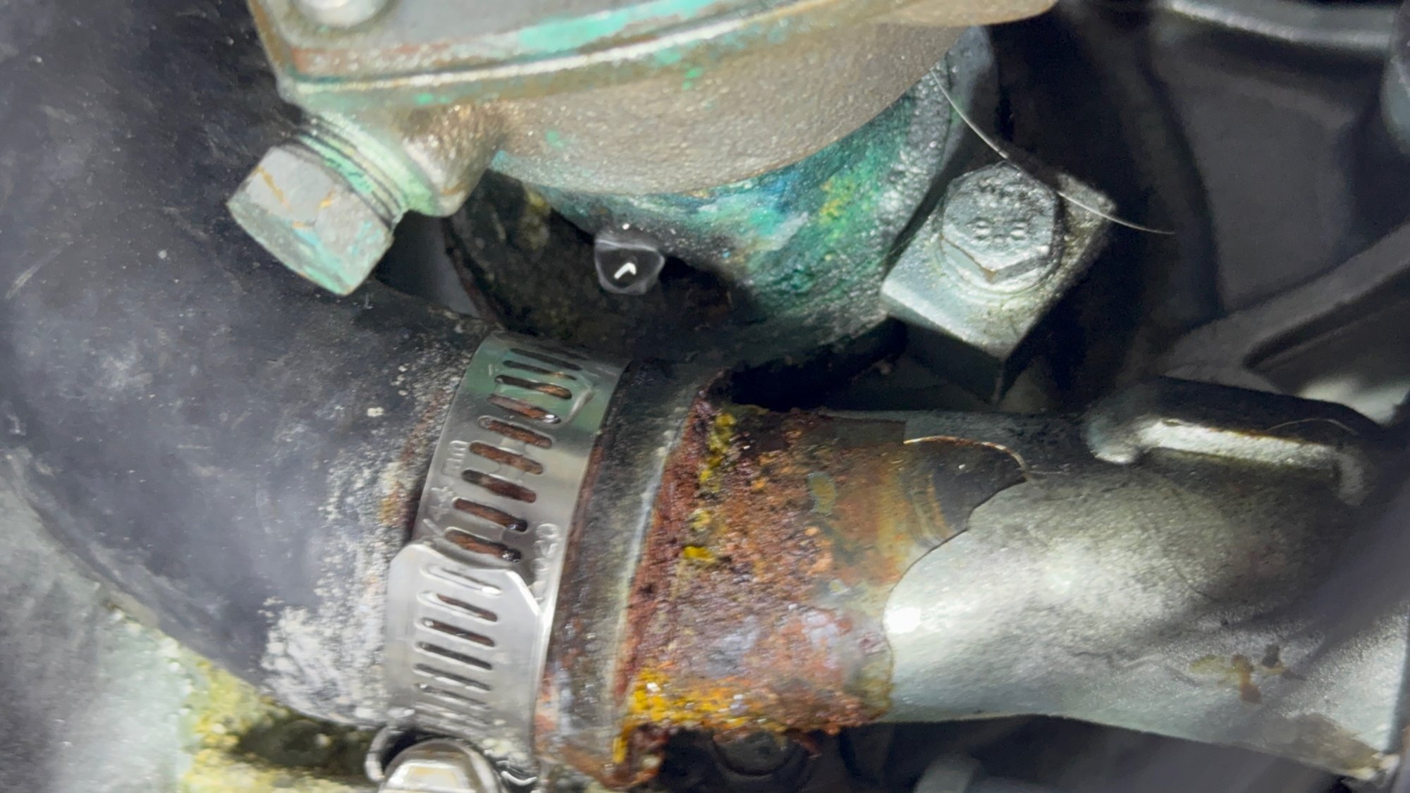

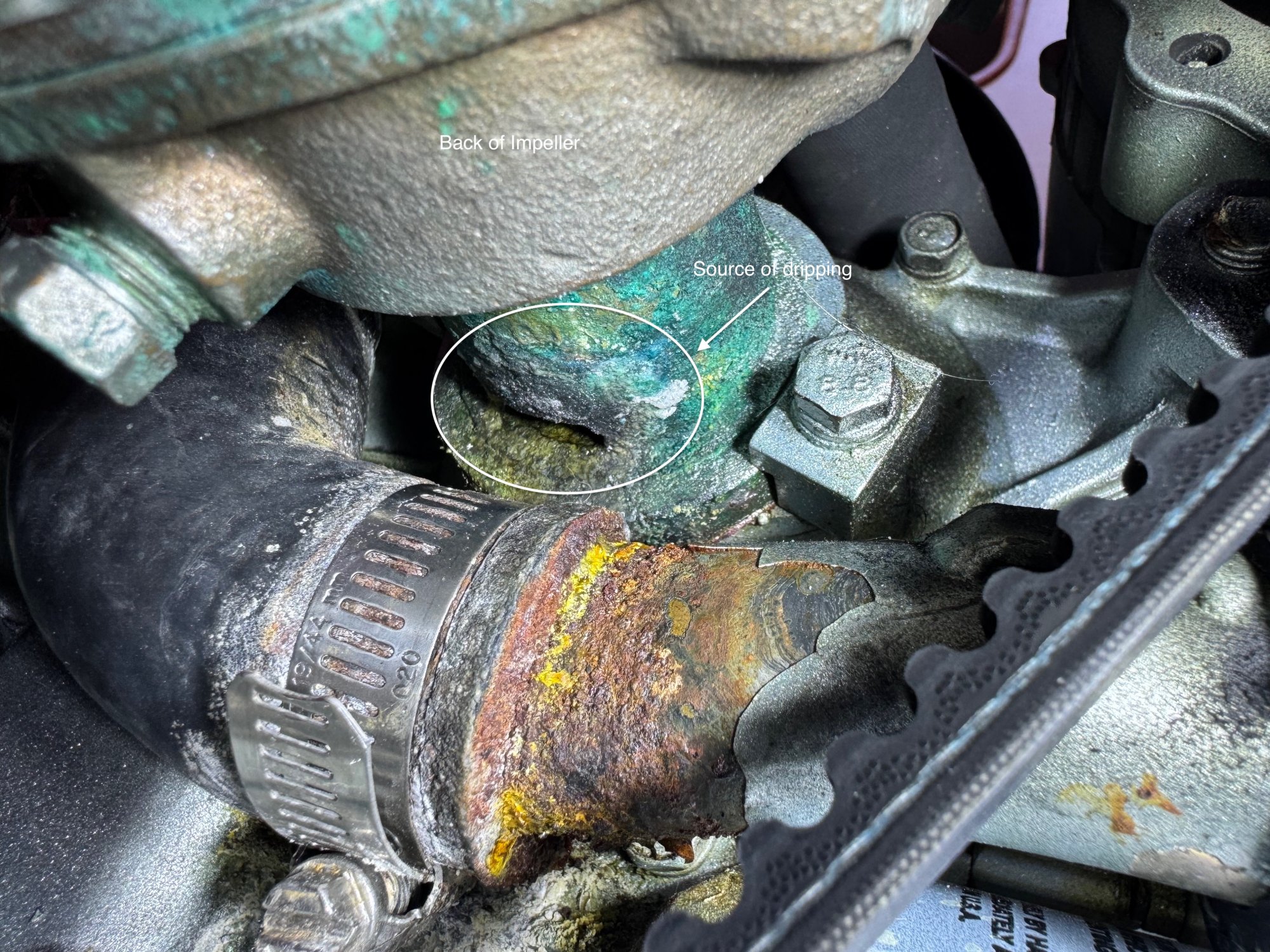

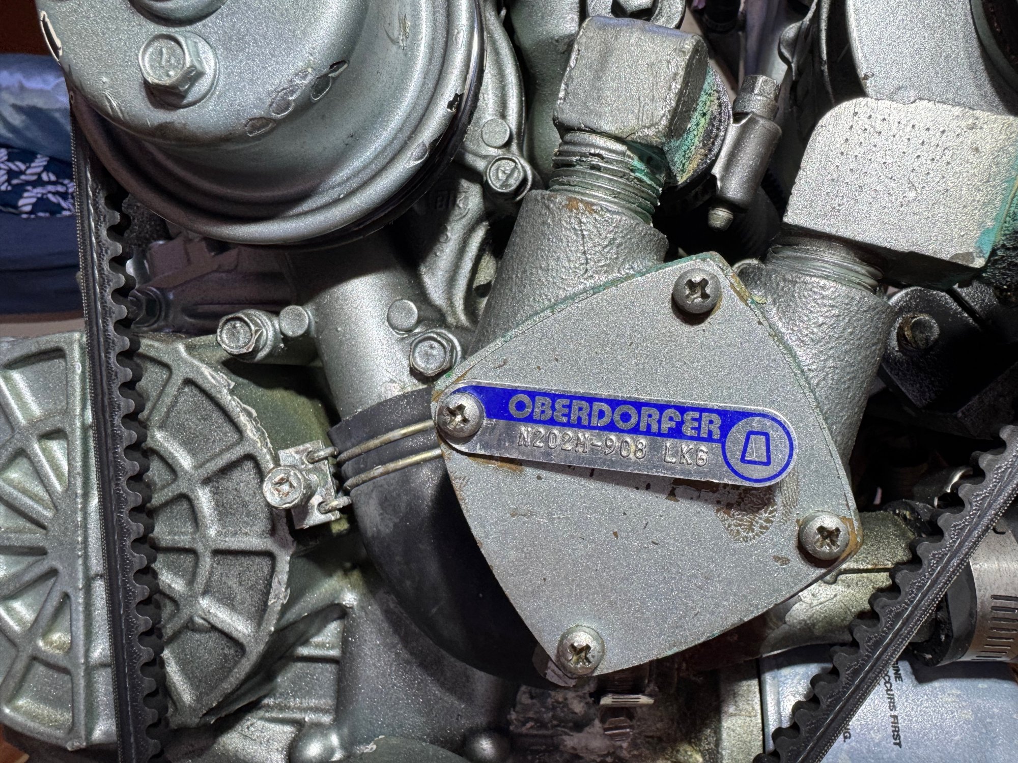

Hi -- this weekend, I found that the raw water pump has a slow leak (less than 1 drop/second) but it's been going on long enough to have corroded some of the parts beneath it. I have an Oberdorfer impeller (N202M) on a Westerbeke M-25XPB engine. It looks like the water is leaking from the holes on the engine-side of the impeller housing unit. I'm pretty sure the leak is from the back of the impeller housing (the side closer to the engine) and I suspect it may be the seals and bearings around the water-pump shaft. This is based on the Raw Water Pump diagram on page 49 of the April 2013 Parts List edition.
At idle, from a cold start, the leaking is about 1 drop per seconds. After the engine warms up at I increase speed, the leak diminishes to about 1 drop every 10 seconds.
Any advise on how to address / diagnose further?
