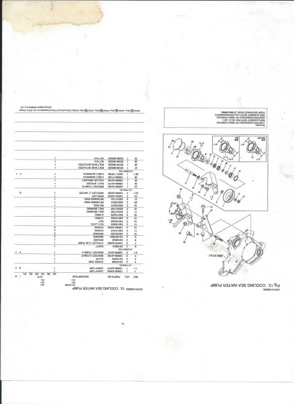

Hi Bob,
Attaching the 2 diagrams I have FYI. You can rebuild it yourself if you find the parts. Depending where you are you might be able to fly the parts in from USA or get the pump rebuilt. It cost me $135 in Canada some years ago instead of $395 for a new pump. When I looked at the old parts it looked like a mechanical seal, similar to what is on a washing machine.
Sep 15, 2009
6,244
S2 9.2a Fairhope Al
Hi Bob,

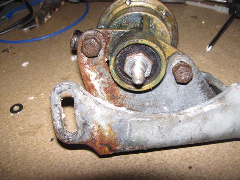

they look like this the seal that is

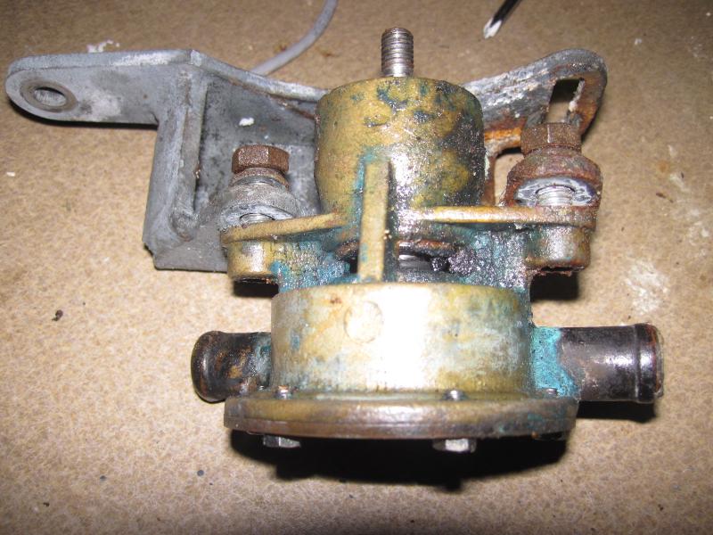

Pump
I am pretty sure you could just replace the seal and seal washer with out
dealing with the bearing and than change the bearings at a later time.
From looking at photo take the locking ring from where pulley side is and
than where the impeller is knock the whole shaft and everything out and than can replace the 2 parts seals.
When you take the shaft out with all the bearings on you can check if the bearings are spinning free and pretty sure the leak doesn't go into the bearings.
Looking down on my pump that space in middle is where it leaks.
