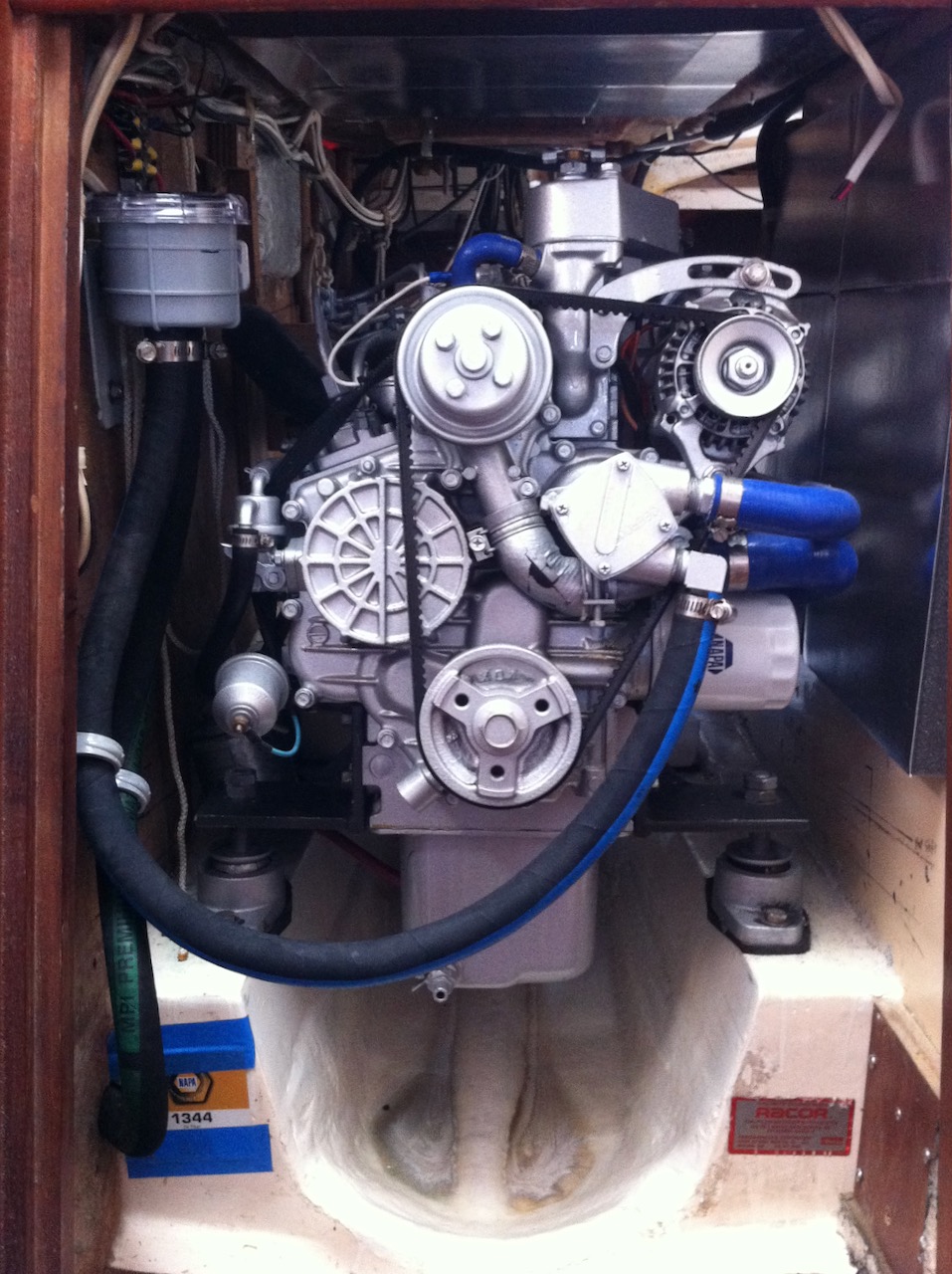

I installed one in my engine compartment a few years ago. Before that I only had the original slotted scoop type through-hull but those are a problem in some waters. I put the strainer above my primary fuel filter, about at waterline level, maybe slightly above. Could have put the fuel filter above the strainer, but thought it would complicate filter change cleanup. Also need clearance above to remove the strainer basket. I have to lift the strainer off it’s bracket for wrench access when I change the secondary fuel filter, but that takes seconds. The bracket is designed for exactly that situation. It’s Groco brand. Don’t know the model number, but it was likely the smallest available. Don’t use the plastic ones in the engine compartment. They’re smaller and less intrusive, but they get brittle with age and the heat from the engine may accelerate that.
Edit: One more thing. For solid mounting of the brackets, I cut out sections of the insulation, inserted wood blocks and covered them with mylar insulation seam tape. Everything is through-bolted in the locker below the galley sink.

Dalliance, I love your clean engine and ample space. Would it make it easier if you exchanged the oil and water filer locations?
Yes and no. Wouldn’t have to take off the strainer for secondary fuel filter access, but need clearance above the strainer to pull the basket out anyway and didn’t want diesel dripping over the strainer when I change the primary fuel filter. The bracket is designed to easily lift off the strainer. Just release the bottom strap and the upper bracket is in two parts; one bolted in place and one integral to the top of the strainer. Just need to allow a little slack in the hose length so there is no need to deal with the hose clamps.
BTW, I mistakenly called my fuel filters oil filters, which I just corrected.

We have a "plastic" strainer on our H36 - re-powered with a Kubota 4-cylinder. It is mounted a few inches above the water line. We keep her on the mid-southern Chesapeake Bay - it doesn't catch too much "junk" - but it does it's job I guess. BTW - that's got to be the cleanest engine compartment I've ever seen on a 80's Hunter! Kudos Dalliance.

My Catalina came to me with a very small cheap plastic Shut Flo strainer. I replaced it with a bronze Groco ARG series strainer. Same type Dalliance shows in his pic. Works very well catching the sea grass. Quick and easy to open, clean the basket and close.
