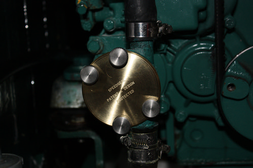

I have a Speed Seal on my raw water impeller housing. What it does is replace the screw in backing plate with 4 large knurled head screws, a new backing plate with an O Ring gasket.
Now I’m not sure if there is a model for your engine but it’s worth looking into. I believe I purchased mine from a company called TOAD Marine years ago and it has served me well. It all depends on the type of impeller housing you have, but it’s a start.
In an emergency, it allows you to loosen the screws, slide the plate off, remove and install a new impeller. That sounds easy, but in a real life application, I’ve never had to do it. And I’m not complaining about that, but it does make yearly or biyearly replacement much easier and would eliminate the gasket.
it’s something to think about.

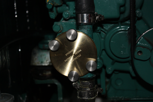

Alas, Speedseal is no more, unless some enterprising person bought the business. It was a good product, I had one on my last boat.
