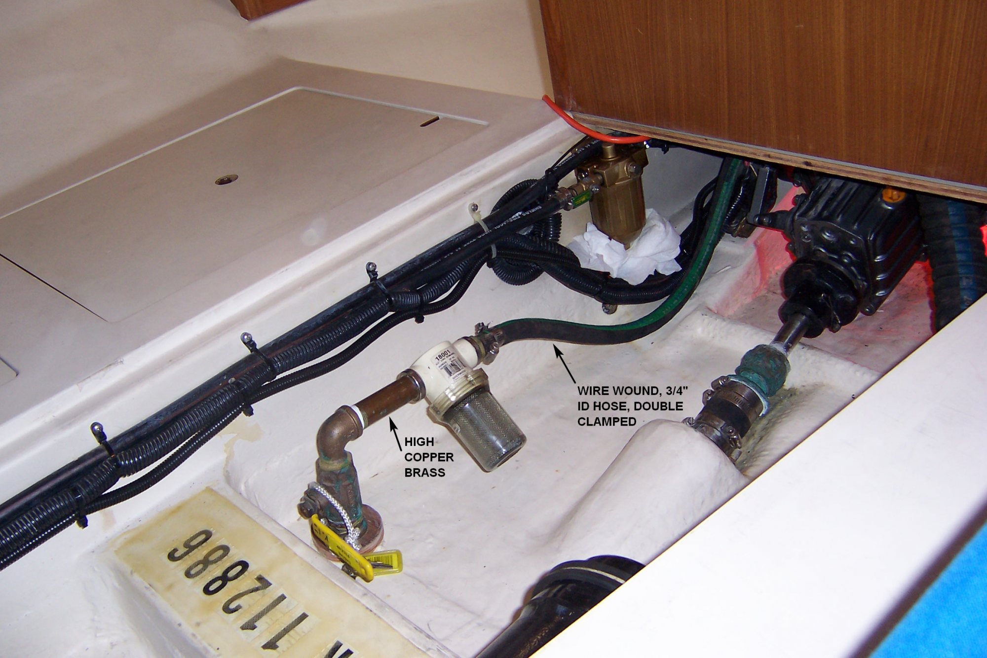

Ditto to everything above, except multiply by two. The only place you will find solid pipe supplying cooling water to an engine is in large ocean going vessels. This is what we have:
