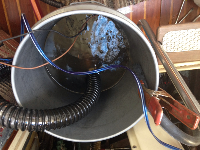

Plan on doing a flush of my raw water system this weekend using Barnacle Buster and a circulation pump in a bucket. Has anyone done this on a similar size engine and know about how much fluid it will take in the closed loop?

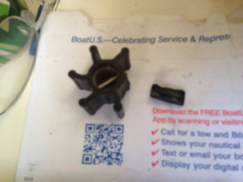

Close the inlet on the raw water inlet. Pull the impeller and thermostat. Pull the hose off where it comes from the inlet strainer to the engine. This is where the bilge pump in the bucket will push the cleaner into the engine. I will pull the hose after the exhaust elbow and this will be the return line to the bucket. Creating a closed loop through the engine and exhaust manifold.

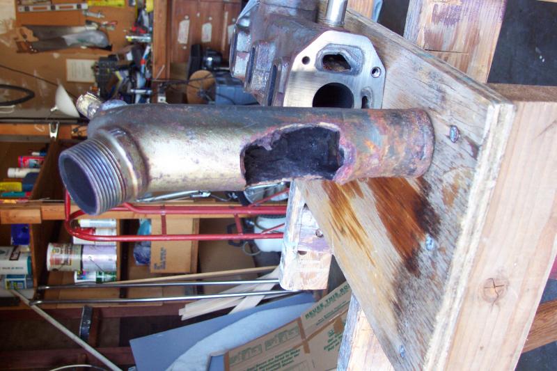

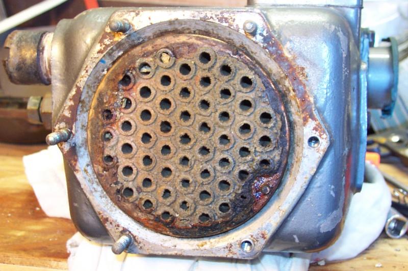

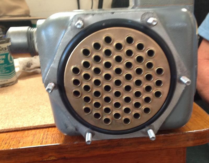

To be honest I don't know if that is going to achieve much. I have had to scrape out the water passage in the exhaust manifold, replace the mixing elbow and overhaul the heat exchanger at various times and just feel like the kind of crud that had to be removed just would not respond to flushing, but what the heck, it is worth a try.
For grins I have attached before and after pictures of the heat exchanger and also the mixing elbow showing the piece that dropped out with zero warning. The mixing elbow was surprisingly unclogged.
Good luck and please let us know how it works. Doubt the volume will be anywhere near 4 gallons.

I have wanted to flush the system for a while. My engine seems to be always at 175 to 180. On the trip from Hudson to Clearwater she ran around 170 doing 6 knots. The next day I was moving the boat 4.5 knots to keep her at 180. I found out why when prepping for the flush.
Flushing the system now.
