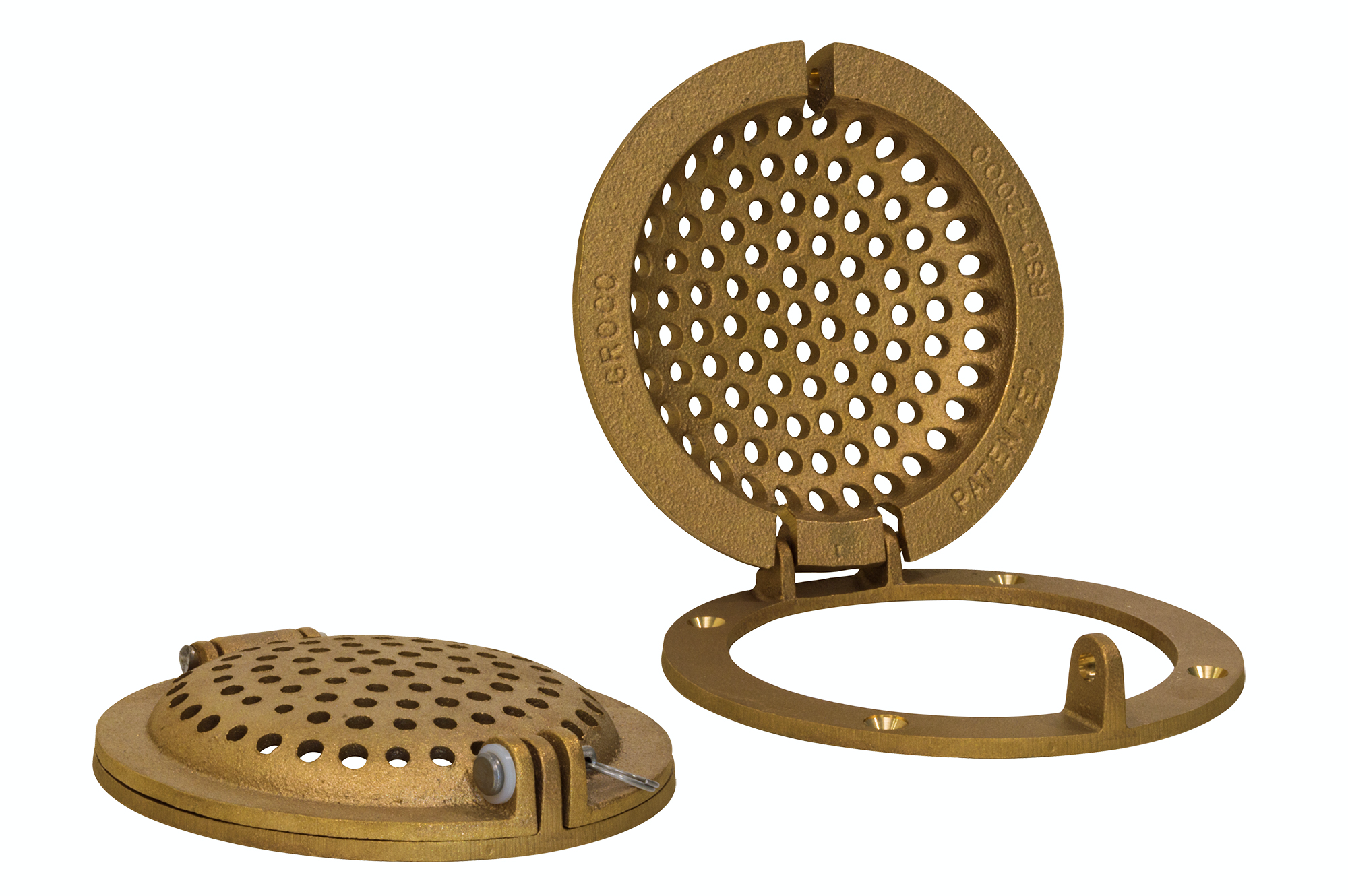

Went to Groco website but did not see any "exterior screen" for thru-hulls. Are you sure those are the right folks?
RoyS
Jun 3, 2012
1,742
Groco has several different styles. Here is one called "RSC" on their web site. Since it installs over your existing thru-hull be sure to get one large enough to cover the fitting without interference. This is what I use.
RoyS
Jun 3, 2012
1,742
One more point if you go this route: These will not conform to a curved surface. The hull must be flat. Groco also makes thru-hulls with a fixed strainer on the exterior. These have a smaller footprint and with the proper sealant may install in a slightly curved hull surface.
Jul 5, 2011
770
Oday 28 Madison, CT
Much obliged, Roy. Not sure how I missed those on their site. Will wait until end of season and have a look at the hull curve at that location, but in principle this is a very good idea. Thanks again!
