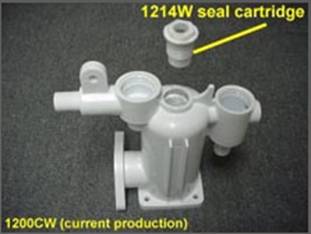

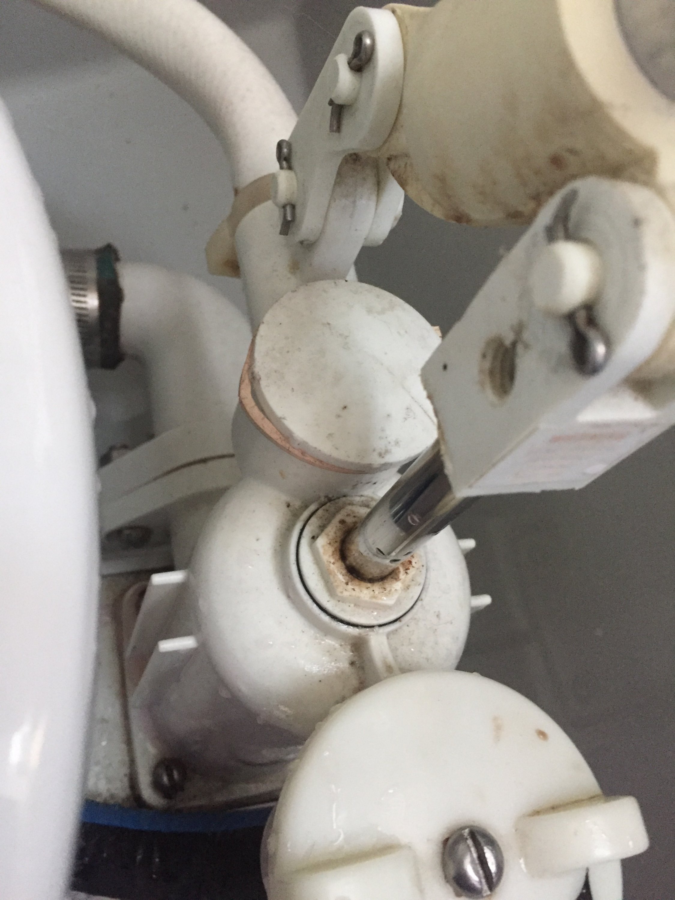

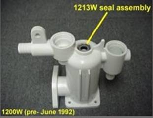

Hey Peggy,
I stopped by the boat today to look at my Raritan head.
Am I wrong in believing that the 1214W seal cartridge is the correct way to identify a post-1992 Raritan PHII?
Mine has a hex nut visible that the piston passes through. The pre-1992 does not appear to have this hex nut visible.
IMG_1533.JPG 2B93DCC4-F142-4072-86EA-2CAE73DBA656.jpeg 4810806D-9F07-440F-8140-F65F6DD30126.jpeg
Before I order a rebuild kit, would like to make sure I get the right one.
I was able to remove the wet/dry valve while at the boat, cleaned it up and lubricated it. Turns much easier now. But I noticed that the flat gaskets are pretty stretched out of shape or cracked.
Thanks for the identification link...very helpful....if I did it right!
