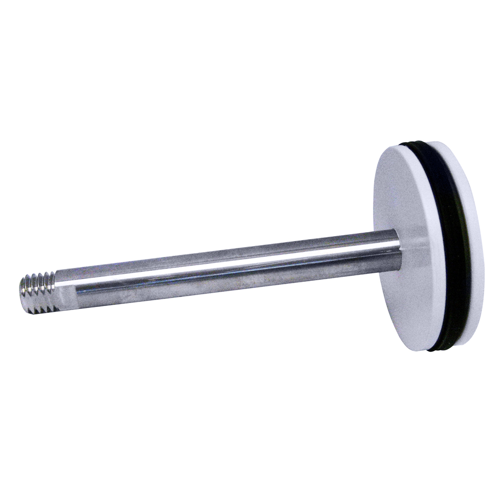

1. It's not actually the piston ROD that needs the grease 'cuz it doesn't rub against anything...it's all the seals,o-rings and gaskets ON the piston rod that rub against inside of the pump housing that need the protection from the grease. Lifting the PHII pump off the base to squirt about a tablespoon of SuperLube thick grease--the grease that Raritan uses-- up into the pump (how I was taught to do it by Raritan techs at the factory) only requires removing and replacing 4 bolts...you should only have to do it annually as part of spring recommisioning and maybe once more if you use your boat year round, which beats the socks off flushing something down the toilet every few weeks that washes out in just a few flushes.

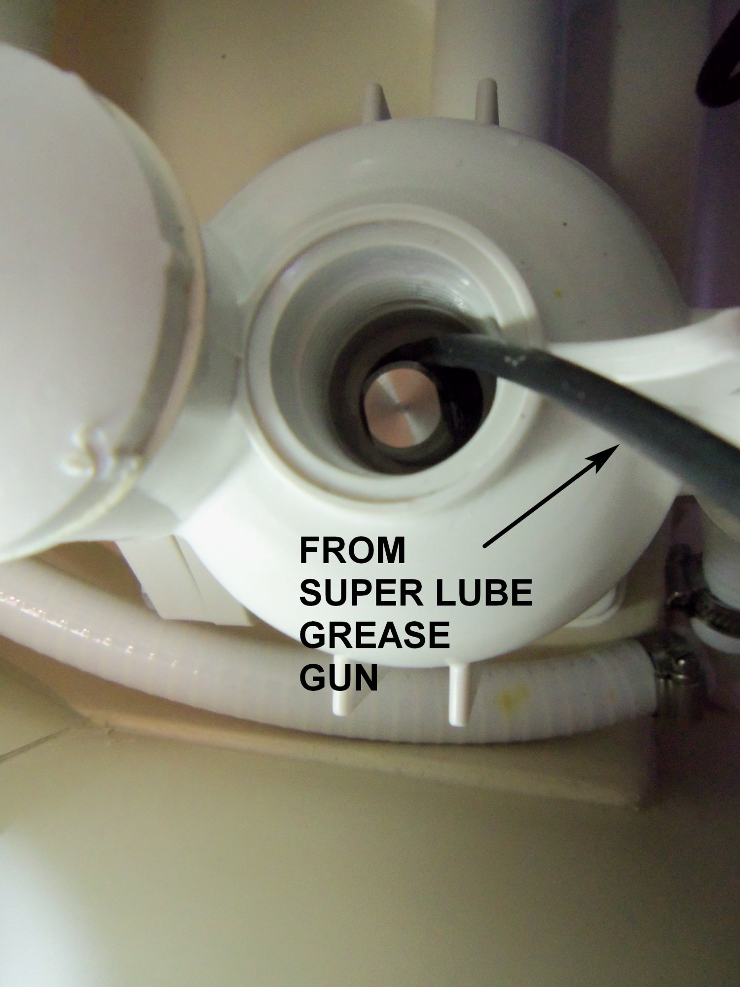

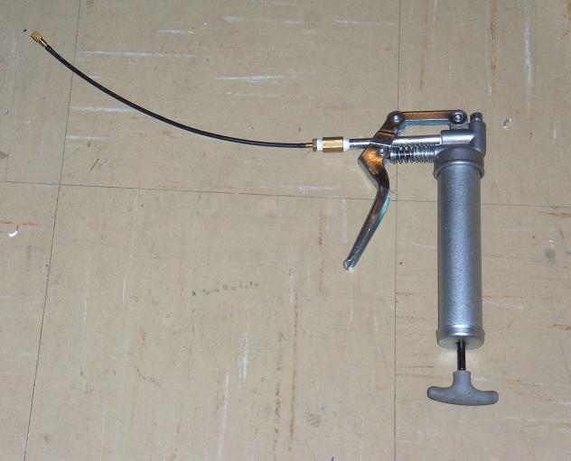

I’m curious what brand grease gun you have and/or the diameter of the tip. Clearance between the shaft and hole is tight…
The small grease gun doesn't have a brand name or model number on it anywhere. Chinese knock off for sure. I've had it for decades, before Chinese knock offs even became popular.
Shown below is how to assemble one after taking the grease fitting off the end of the 1/8" pipe. The fittings may not be the most compact as I made this from spare parts on hand.
The closest grease gun at Amazon.com is this one :
I used the smallest one as it doesn't require a full grease can of SuperLube to fill it.
The 1/8" OD X 1/16" ID poly tubing is also available from Amazon;
The 1/8" MIP X 1/16" adapter may be available from Amazon but watch the OD and ID tube sizes as the sellers are a little confused in some cases. Get an FIP X barbed fitting and you can eliminate the brass connector to simplify life a little.
After a close look at the amount of piping around the bowl which allows for a clean water flush at the end of the day, there is no way I intend to annually open either the bottom of the pump base or the joker valve housing for lubrication. I'll open whichever, when the need for repairs arises. If the Jabsco joker valve is any indication of life expectancy, that'll be many years from now with the Raritan.
I also get the impression from Peggie that you'll get an indication as to when your joker valve starts to fail.
But when the joker valve becomes worn and/or there's a buildup of sea water minerals on it, it can no longer seal tightly on the upstroke of the piston so less and less vacuum is created, requiring more and more pumping to move bowl contents.
Why the joker vlave on my old Jabsco went for so many years without any attention may be due to my previous habit of dumping a gallon of fresh water into the bowl at the end of the day while pumping on dry :
I know this raised hell with the piston ring as the upper cylinder was dry, but that's all in the past and best left there. The current Raritan sucks water from the sink drain at close up time and the cylinder is always full on both sides. Oh, how I envy lake sailors :clap:.
Also, how do you remove the o-rings without damaging them? Don’t want to turn the pump into a squirt gun…
The O ring (part #23) which acts as the gland packing comes up with the shaft and is greased with SuperLube and then pulled off the shaft over the threads. The grease always prevents cutting the O ring if you're careful. Also, keep track of O ring #24.
The process is a walk in the park after the first time you've done it. And most important to me, It's absolutely CLEAN.
Take a look at the attached cheat sheet which I prepared for a friend who also works on the boat (at very rare intervals) and wanted to do it from scratch.

Why would you need a grease gun to lube the pump??? Just stick the nozzle on the tube of grease up into the bottom of the pump and squirt about a tablespoon of grease into it.

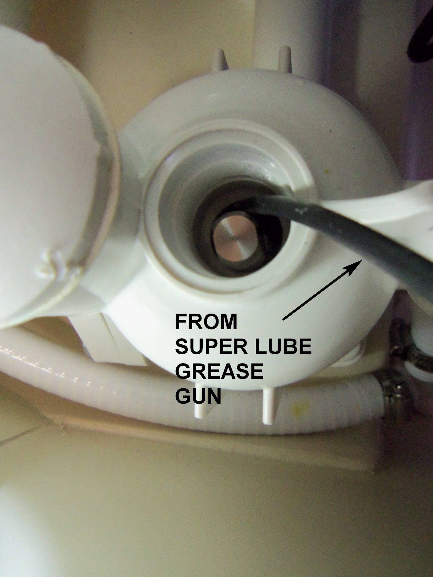

The problem (or advantage) here is is that I am lubricating the pump from the top as shown :
This requires a small 1/8" OD tube with a 1/16" ID. The grease is too viscous to go through 12" length of the small tube without the assistance of the grease gun to boost the pressure. I should mention that the piston is at the bottom of its stroke when the grease is pumped on to the cylinder walls.
Let's see how long the pump O-ring will last with this fashion of lubrication. So far so good. I can feel the stroke ease up after the pump has not been lubed for a year.
