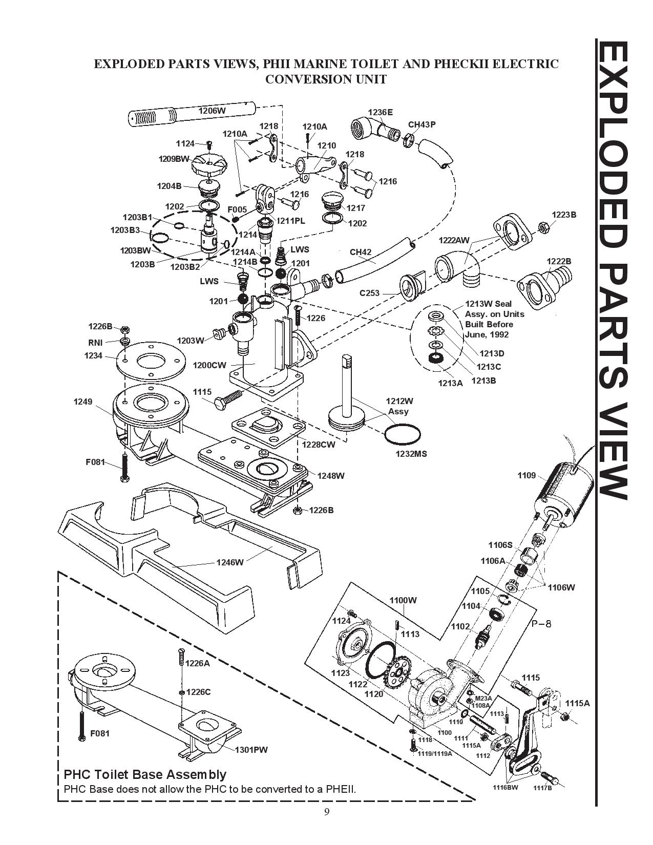

Part 1204B in the picture.
It's the cap under the flush selector.
It won't budge. Can't get a grip on it with any tool due to limited space and no corners on the round cap.
Don't want to break it.
Gasket is leaking. Need to adjust tightness or replace gasket.

A large set of Channelock pliers does it for me.
When you get the new O ring in, gently tighten. Very easy to distort the new seal.

Don't remove the selector. Just the valve body cap under it.
10,244
The selector has to come off, otherwise the plug valve will try to turn ??
