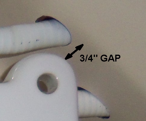

A cautionary notehere.
I installed a Raritan PHll this winter and was all set to go with the full sized bowl until I noticed this little problem at the rear of my old Jabsco:
The Raritan PHll is a Jabsco with a different pump. If the increased length of the full size bowl is split equally between fore and aft, the bowl would have been a few inches into the wall. A marine size bowl it is for me.
No walls near your head ? ? ? Congratulations ! ! !
You need a shoe-horn just to mount ours :cuss:.
