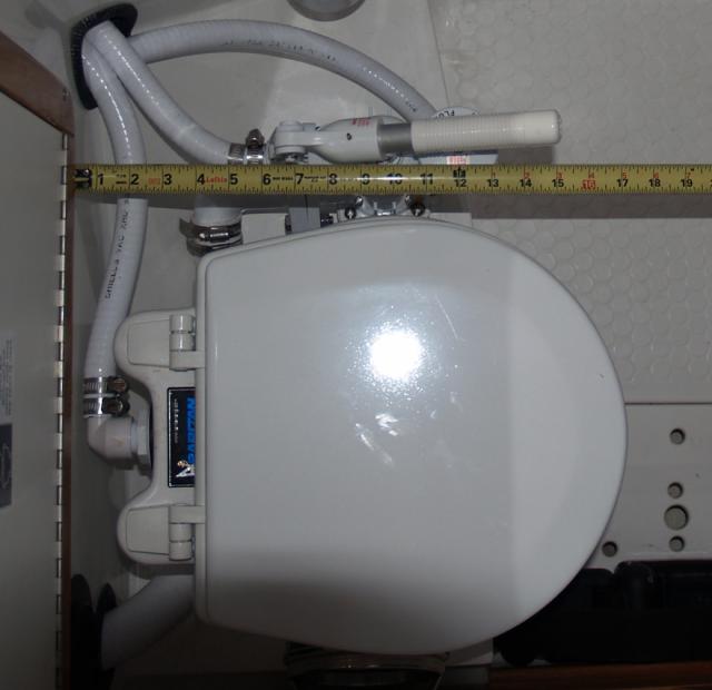

Here is a photo that may help. I only have about 1/8th inch clearance to the back bulkhead so the dimension reads 16 7/8th to the front of the bowl. As you can see the handle does not stick past the rim.
The discharge is easily adjustable to swivel in any direction you choose.
The head is a major improvement over the Jabsco that came with the boat.

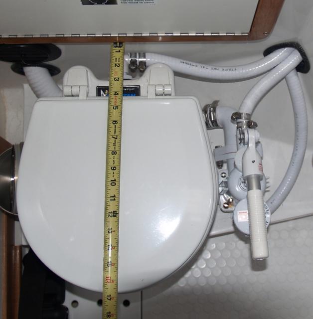

one more photo
as you can see the handle extend 15 inches from the bulkhead.

Not the same toilet, Steve
The compact II and the PHC are different. The PHC uses the same pump as the PHII (full size). It is essentially the same as the PHII except for a shorter handle and a base that does not require a trim skirt. It has a smaller footprint and thanks to the short handle it does not extend as far out from the bulkhead. Compare my photos to the drawings and that will be clear.
I think when I made that same mistake, Peggy told me that the PHC was the one to get and after getting to know it I am very impressed. It is a very well built product and works great.

Thanks
Bob thanks a bunch. That is exactly what I need to see. Did you take those pictures just for me? They're perfect.
