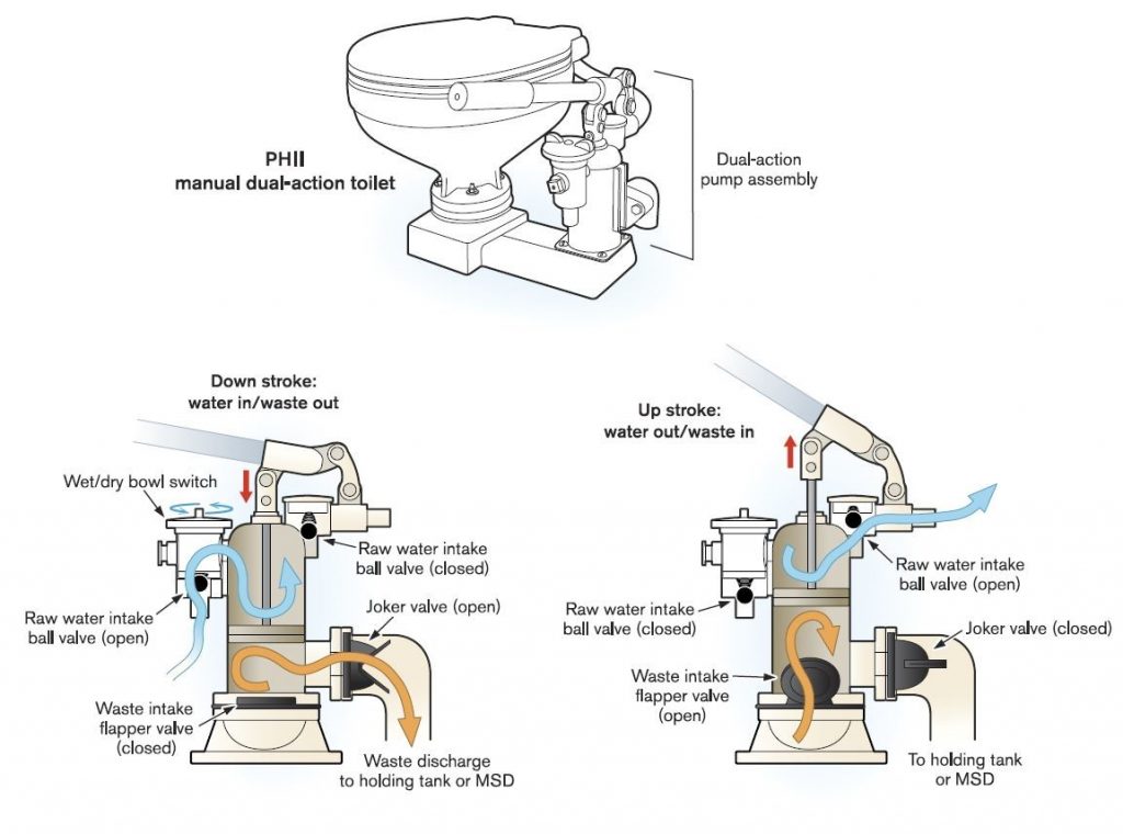

Tally Ho . Jan 7, 2011 5,999 Oday 322 East Chicago, IN Nov 16, 2017 #22 There is another thread that shows a tear-down of a Raritan pump assembly. Very helpful video. Should make lubricating the wet/dry valve pretty easy. I need to do mine too. https://forums.sailboatowners.com/index.php?threads/raritan-phii-pump-rebuild.188870/#post-1416440 Greg
