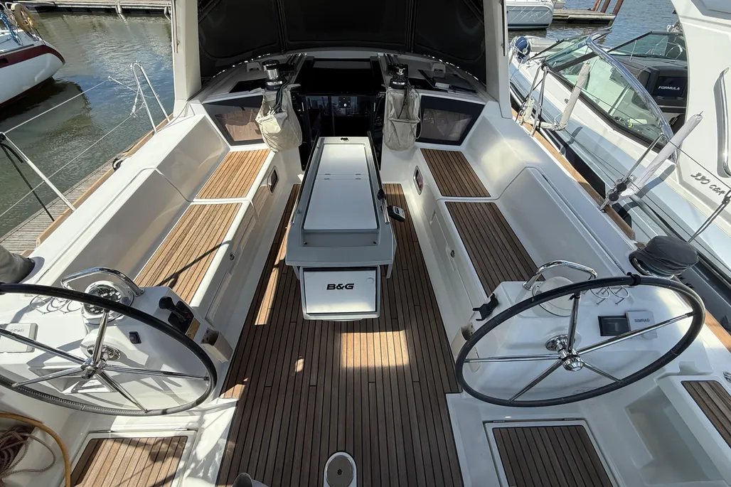

Here's a random, but very typical example from Yachtworld: a 2013 Beneteau Oceanis 41. This is almost the same setup as the 44' Beneteau I chartered.
I can't accurately say how far the plotter is from your face when you're behind the wheel, but it's got to be something like 5 feet. Think about where you'd hold a book to read it, and then move it 4 or 5 feet away. Maybe this would be ok if I were 20... probably not, though.
I think I'm done beating this horse now. Just had to get it out of my system, apparently.

@jaysweet . Those helms have ideal spots for the iPad or tablet MFD in holders on the steel bars. The image from the plotter would be in the helm's face.
As Shakespeare might intone, "Me thinks thou dost protest too much."
I understand now. I've never seen that before, but it does look like too far away and a bad angle even for a 20yo.
How would one even operate it? When I described ours as being well below eye level and a bit away, it is still within a comfortable arm's reach to operate it.
Mark
