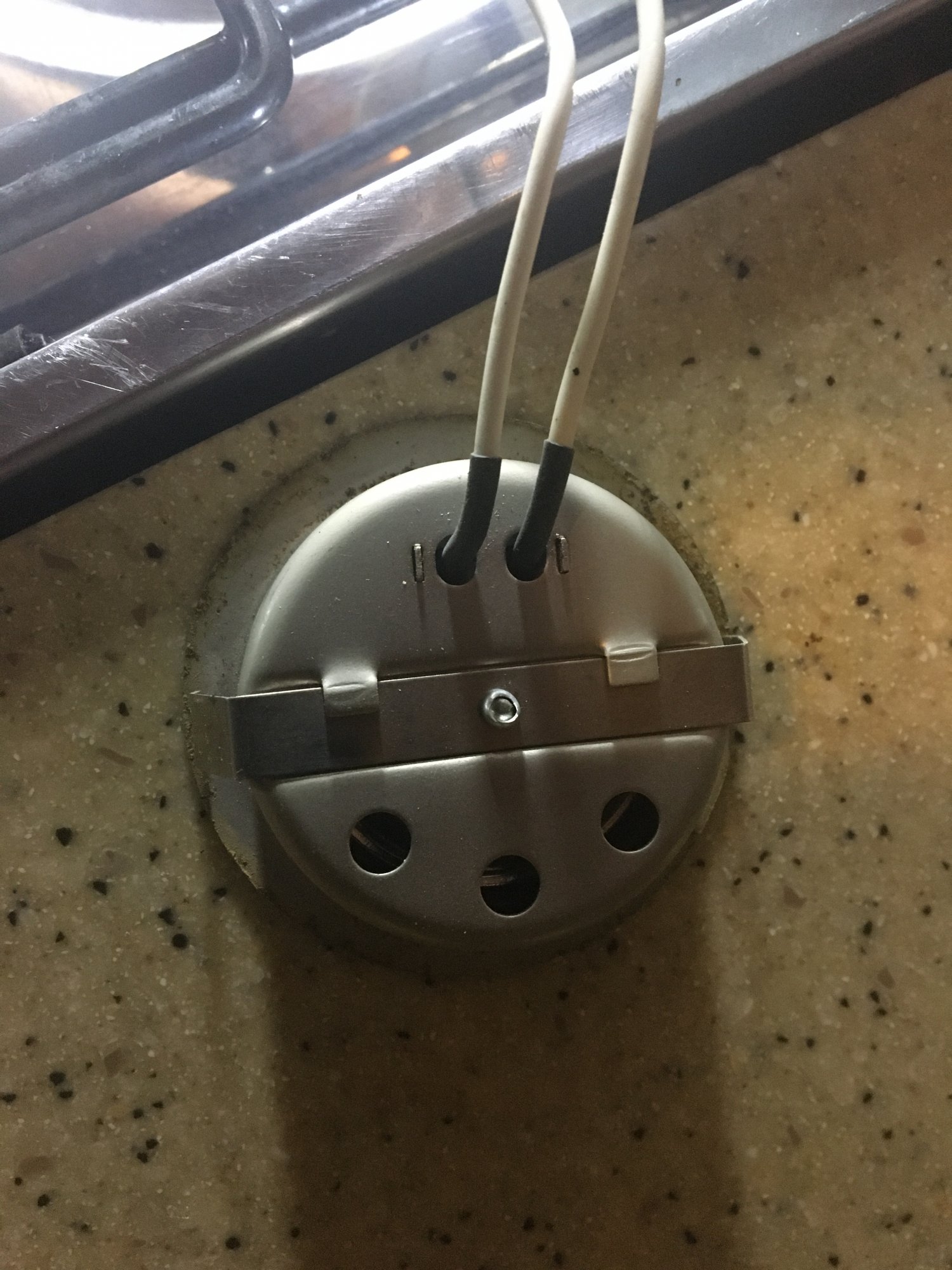

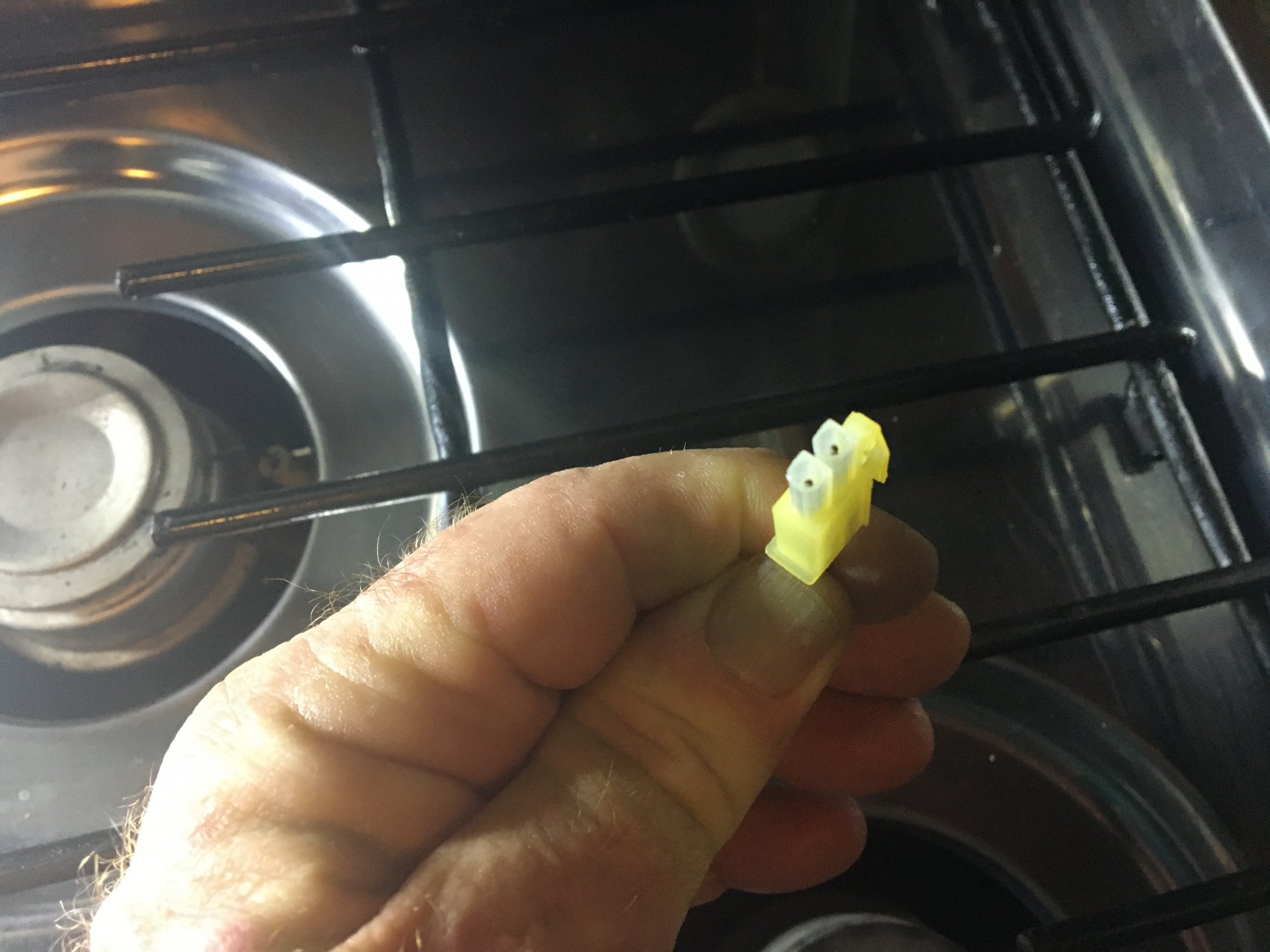

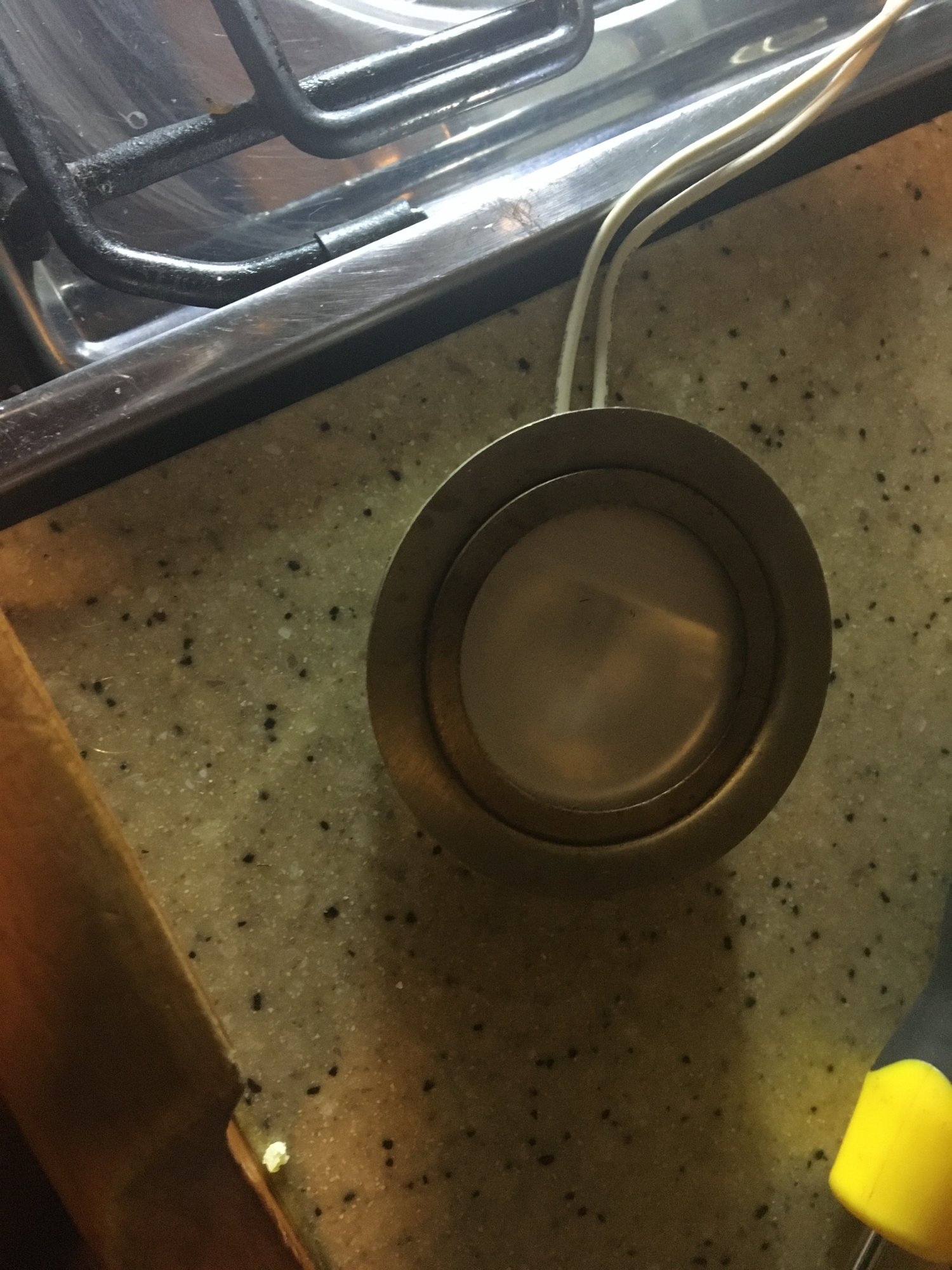

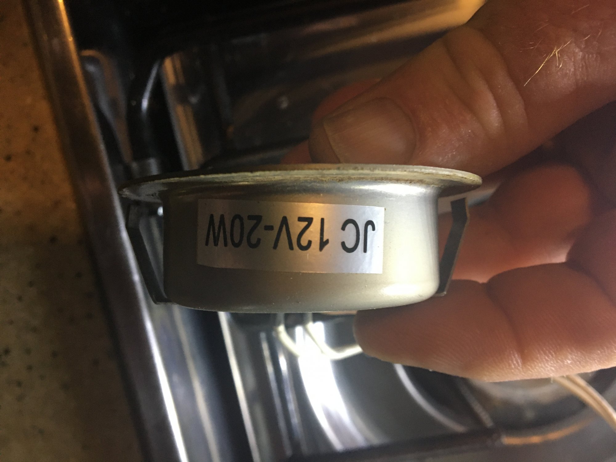

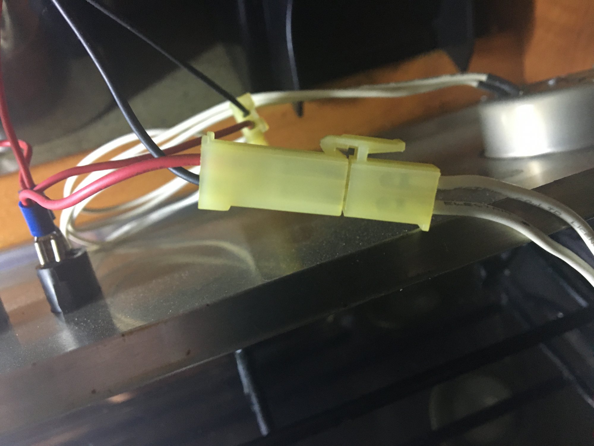

Bogart is a 2007 Hunter 45CC. A light in the range hood has failed, which we would like to replace. I have not been able to find any identifying marks on the range hood (I have not uninstalled it yet), so was hoping that someone might know who supplied these parts to the 2007 model. I have attached a few photos of the light fitting - it is a made-up unit with plug in wiring. Any help would be greatly appreciated.IMG_6361.JPGIMG_6362.JPGIMG_6363.JPGIMG_6364.JPGIMG_6366.JPG

Needing to replace the whole fixture or just the bulb? Bulb should be a jc 12v g4 bi-pin bulb - available in xenon,halogen or led from most hardware stores. Fixture looks to be a generic under counter fixture. Measure the diameter and depth then check your favourite big box store.
