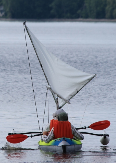

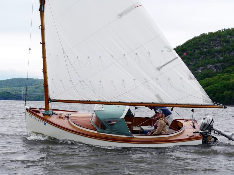

So those are interesting questions. I guess I'd want to know if lee helm or off-wind-only are issues with the lanteen rig. To my eye (I've never sailed a lanteen) the lanteen in the picture above has a sail that could be supported by an aft mast and you would have the added bonus of not having a "bad" tack due to the mast cutting the sail area when on the leeward side.

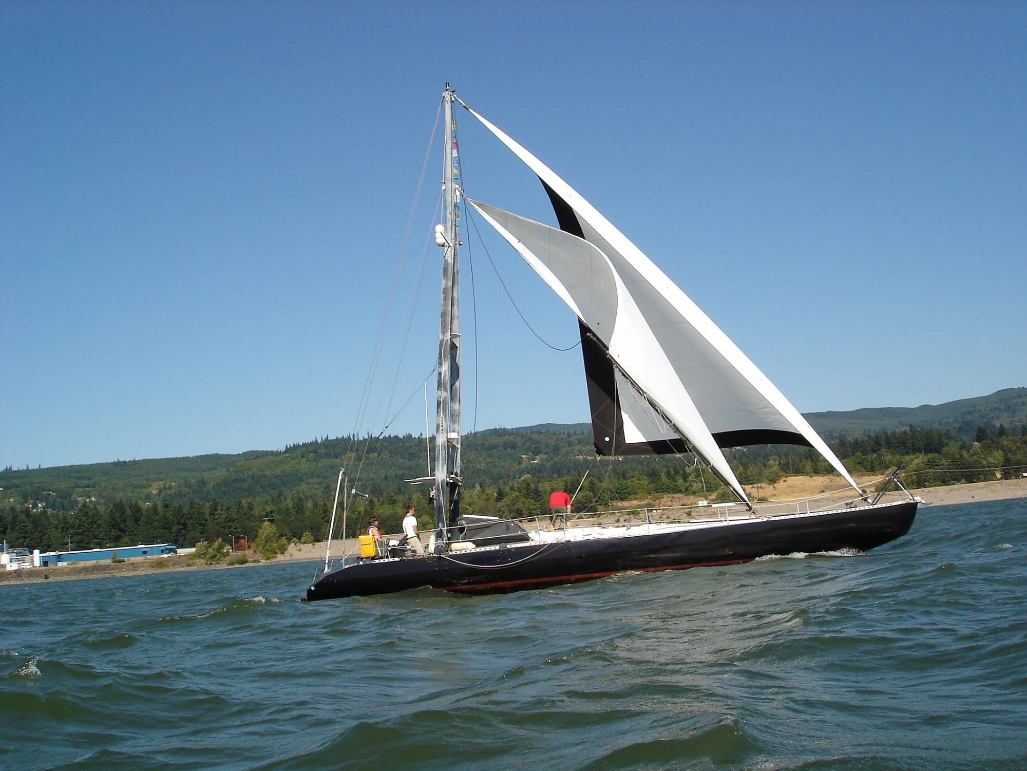

The aft-mast rig, also called a delta rig or a stays'l rig had been toyed with on and off for decades and longer. The stays'l schooner has been around much longer.
Creole, built 1927
Creole was built for the American, Alexander Smith Cochran. Launched as ‘Vira’ she was the largest yacht C&N had ever constructed. Her Bermudan staysail rig was used so that the yacht could be sailed with limited crew who would not have heavy gaffs to hoist.

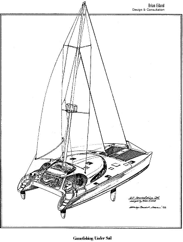

My guess is that aft-mast rigs are chosen for modern catamarans to reduce complexity for the sailor. Make them a simple as possible for a boat designed for comfort and automation over efficiency.

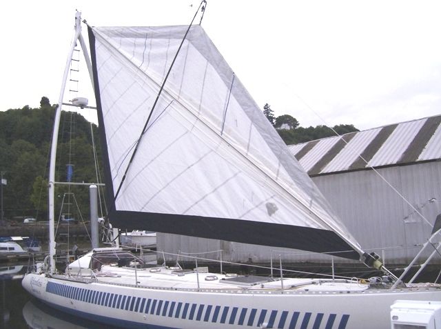

A few delta rig pics:

Those aft mast designs look like they would be difficult to get good forestay tension due to the steep angle of the backstay.

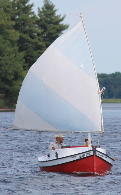

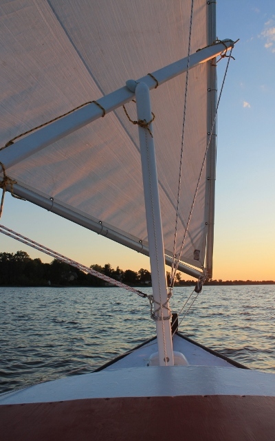

I found this photo interesting

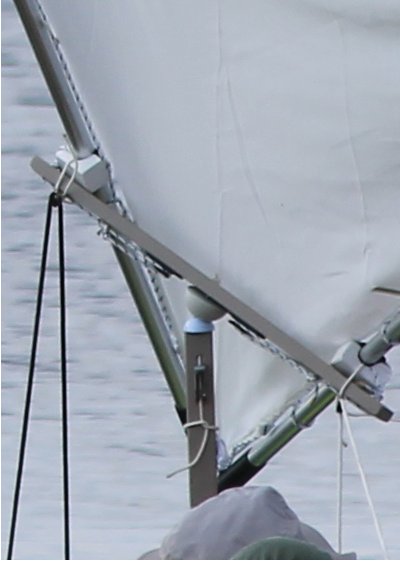

It reminds me of a crabclaw sail (something we hashed out in a post about this time of year two years ago). I wonder if you couldn't borrow some design properties and applications of the crab claw but support it with an aft mast instead of in a lanteen fashion. That would allow the crabclaw to avoid having a "bad tack" side. I also think that if you could figure out a way to tip the mast athwart, you could use the tip as a way to spill air on the crabclaw in a manner similar to the T-shaped support ideas we saw floating around a few years back...
What I'm seeing is something like this...
Where the bottom spar (boom) is snubed down by a vang on a traveler that goes the entire width of the beam. Then if the mast is designed with stays that allow you to adjust the athwart pitch (this would be the tricky part) you would move the vang to the leeward side and pitch the mast to windward and you should have a sail that looks like a crabclaw profile to the wind. If it worked, the advantage would be a crabclaw sail you could set up on a roller furler, the leading edge isn't spoiled by a spar, AND you cut the sail flat on a crabclaw for ease of sail production.
All I need now is infinite time and money to try out some of these ideas.:poop::beer:

... the T-shaped support ideas...
I really like this sail plan. I can imagine a number of benefits, from ease of wind spillage, uninterrupted airflow on either tack, lift generation that would reduce wetted surface underway, and improved resistance to heeling.
If you used a spar on the leading edge, you could go higher with the aftmast and use less backstay support. You could still have roller furling around the luff spar.
