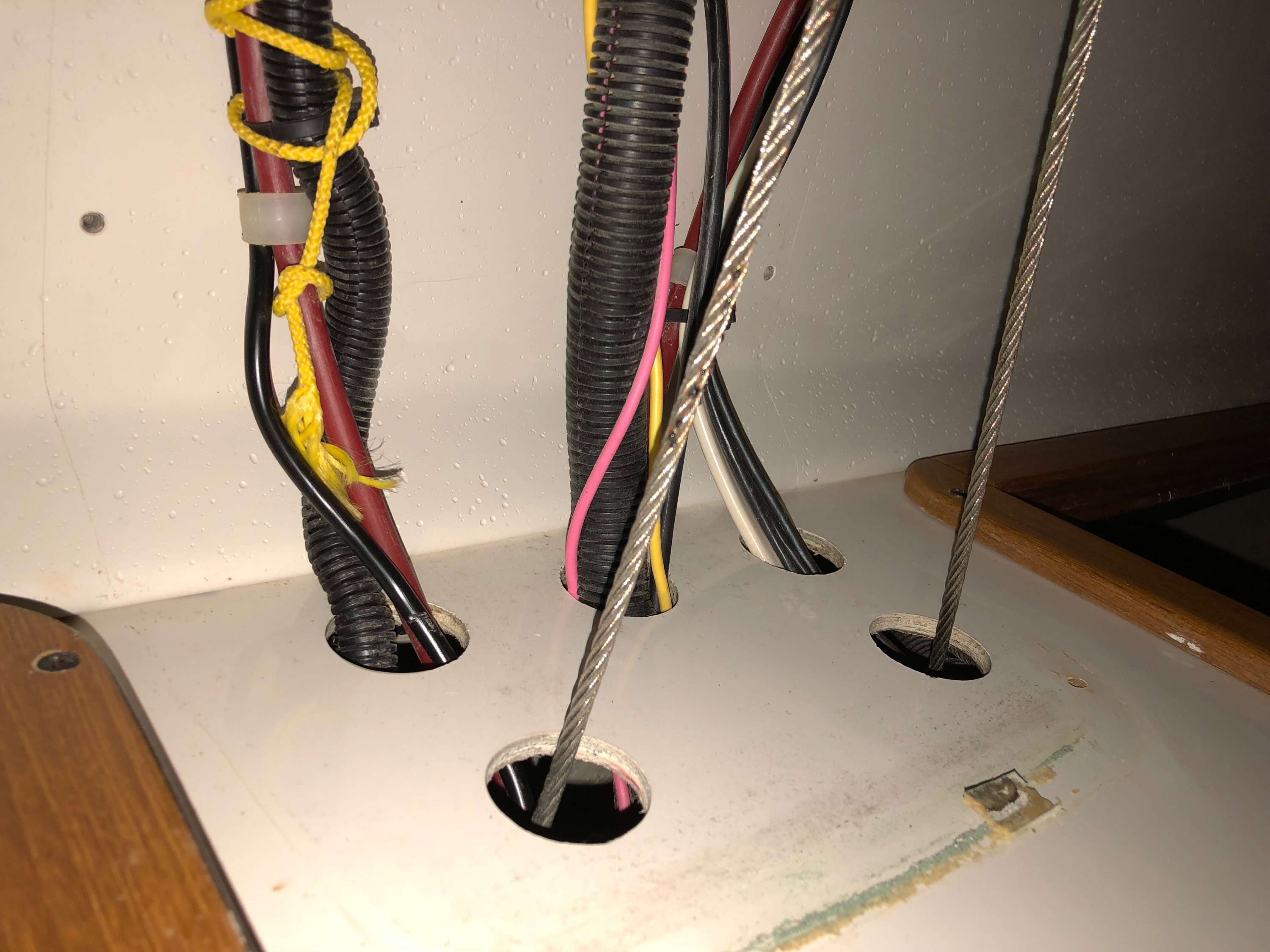

I have actually hired that project out, as it was worth (to me) paying for 2-3 hours of work rather than spending 4-5 hours of my time doing it. I already had an old Remote Mic in the cockpit, but it was paired with a really old VHF. I replaced the VHF myself in the nav cabinet, but it is one with AIS and the old extension cable was not compatible. The cables come down the binnacle pipe, out by the steering cables, back into the aft area by the water heater, then back out and along the starboard side of the boat and into the nav cabinet.
The issue I had (and why I hired it out) is that the new extension cable was bigger than the old one. So it didn't look like it would fit into the pipe without enlarging the hole (it turned out my guy just dropped all the other cables and then there was just enough room to get the extension up and through and then re-pull all the other cables back up.

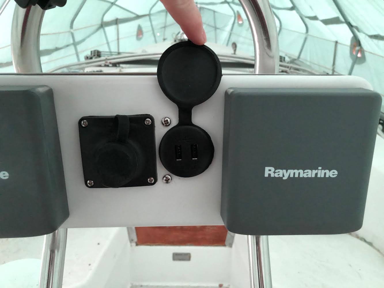

I've attached some photos of the project in progress. While he was doing that work I also had a USB charger installed as well.

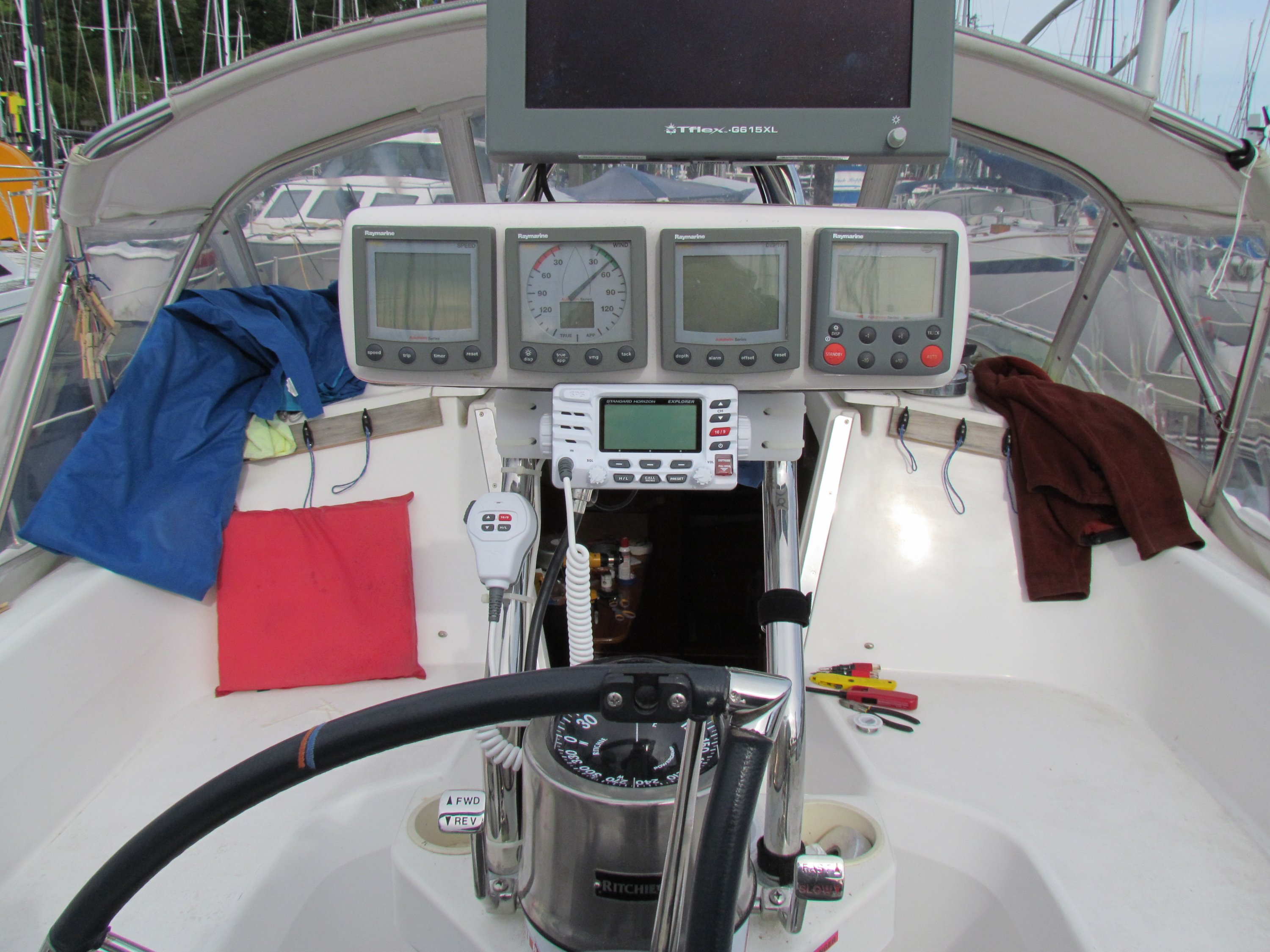

I mounted the connector to the back/bottom on my NavPod (3 Raymarine navpod) and also hang the mic on the side just between my navpod and my drink holder. This keeps it out of the way from being snagged or bumped. I tested a fair bit with the Mic powered up while moving it in and around the compass to ensure that it was far enough away to avoid interference. It WILL affect your compass if close enough.
As others have noted, I cut the cable to be able to feed it through the pedestal and to a junction box in the lazarette.
The Legend 35 (87-9?) has an awful pedestal guard (for wiring) in that it does NOT go down to the cockpit sole, and pulls a 90deg bend into the pedestal. Make wiring pretty tricky.
