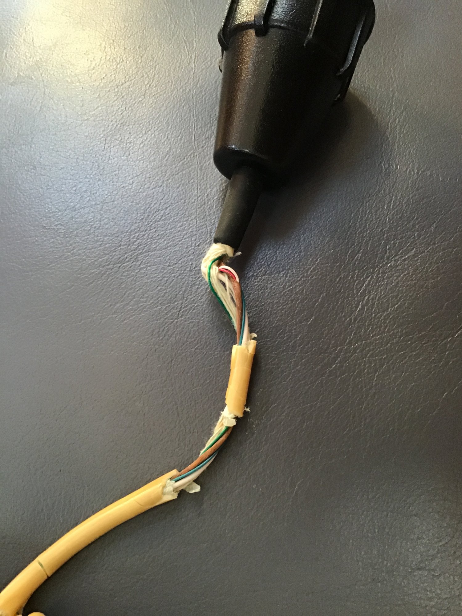

If it is just the outer cable covering that is disintegrating, and the conductors are still carrying all the signals needed to have complete functionality of the radio, why not wrap the cable in something? In effect, give it a new skin. Heat shrink, hockey tape, even electrical tape (yuck) come to mind, and they come in various colors. I wouldn't recommend black or a dark color, because of heat absorption, but this seems like a cheap fix if the problem is cosmetic and/or lack of protection for the conductors.

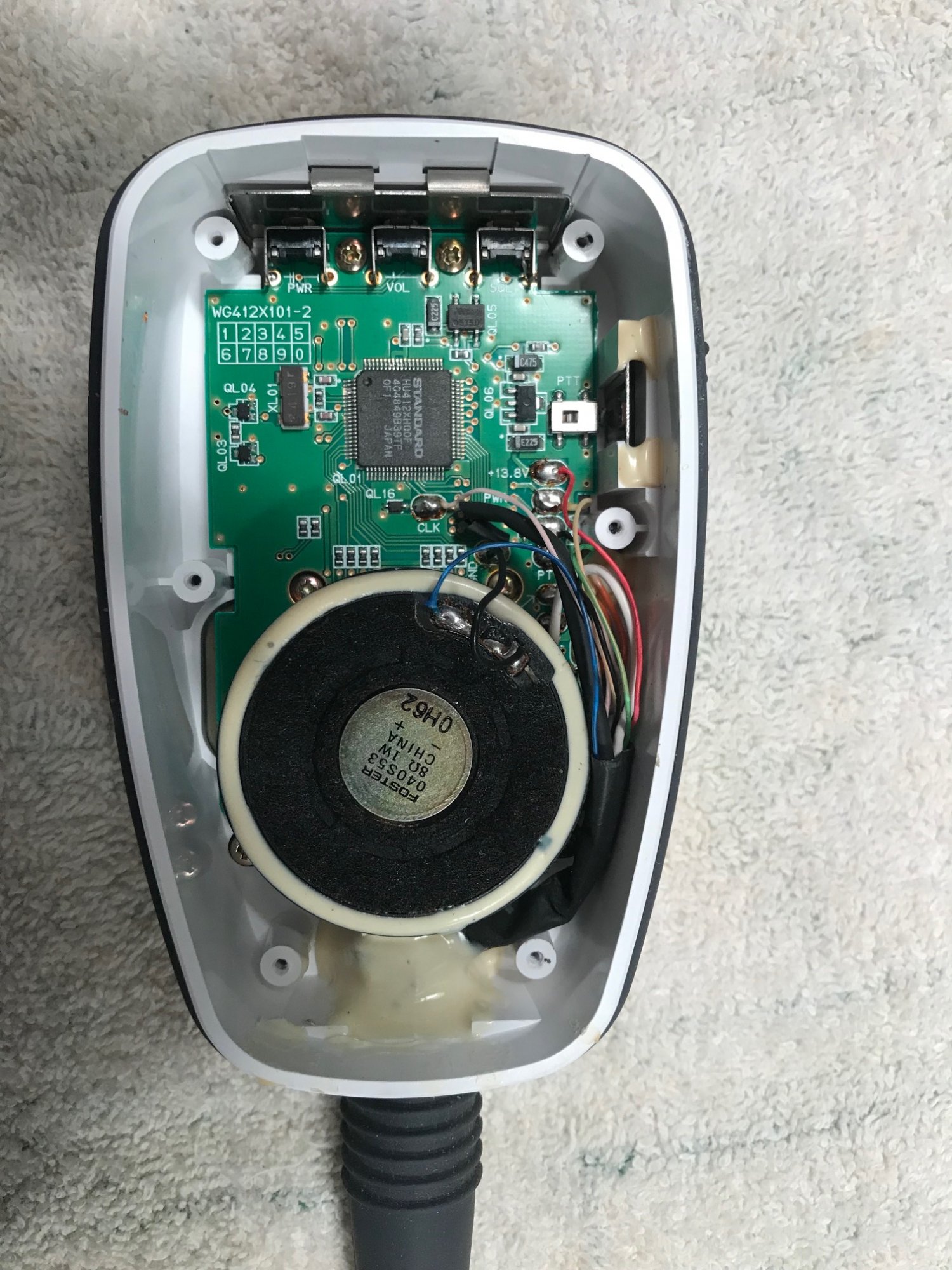

Here is a photo of the inside of the Standard Horizon CMP23 RAM mic. There are 8 small conductors within the cord.
Sep 24, 2018
2,599
O'Day 25 Chicago
There most definitely is. It's dealing with way more than just mic and speaker. I'm really surprised to see that they have a custom IC. Anyways, here's a couple that might work for you. The first link has options for a custom cable
