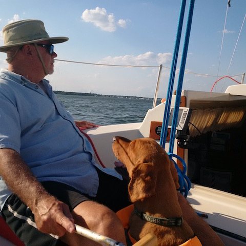

I used the RAM swing mount to mount my 547XS. It is mounted inside and swings out past the companionway. Only blocks the opening a little and saves putting more holes on the outside bulkhead. The photo shows it behind the main sheet.
Just another idea.
