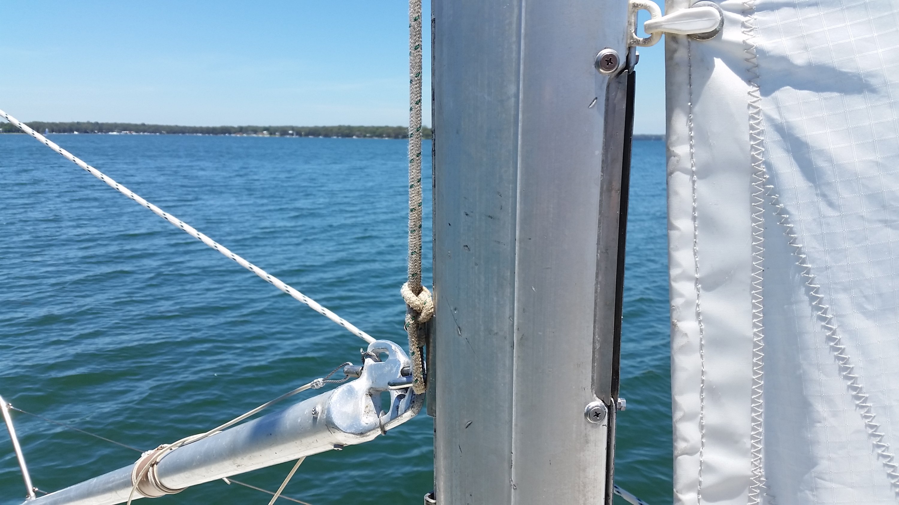

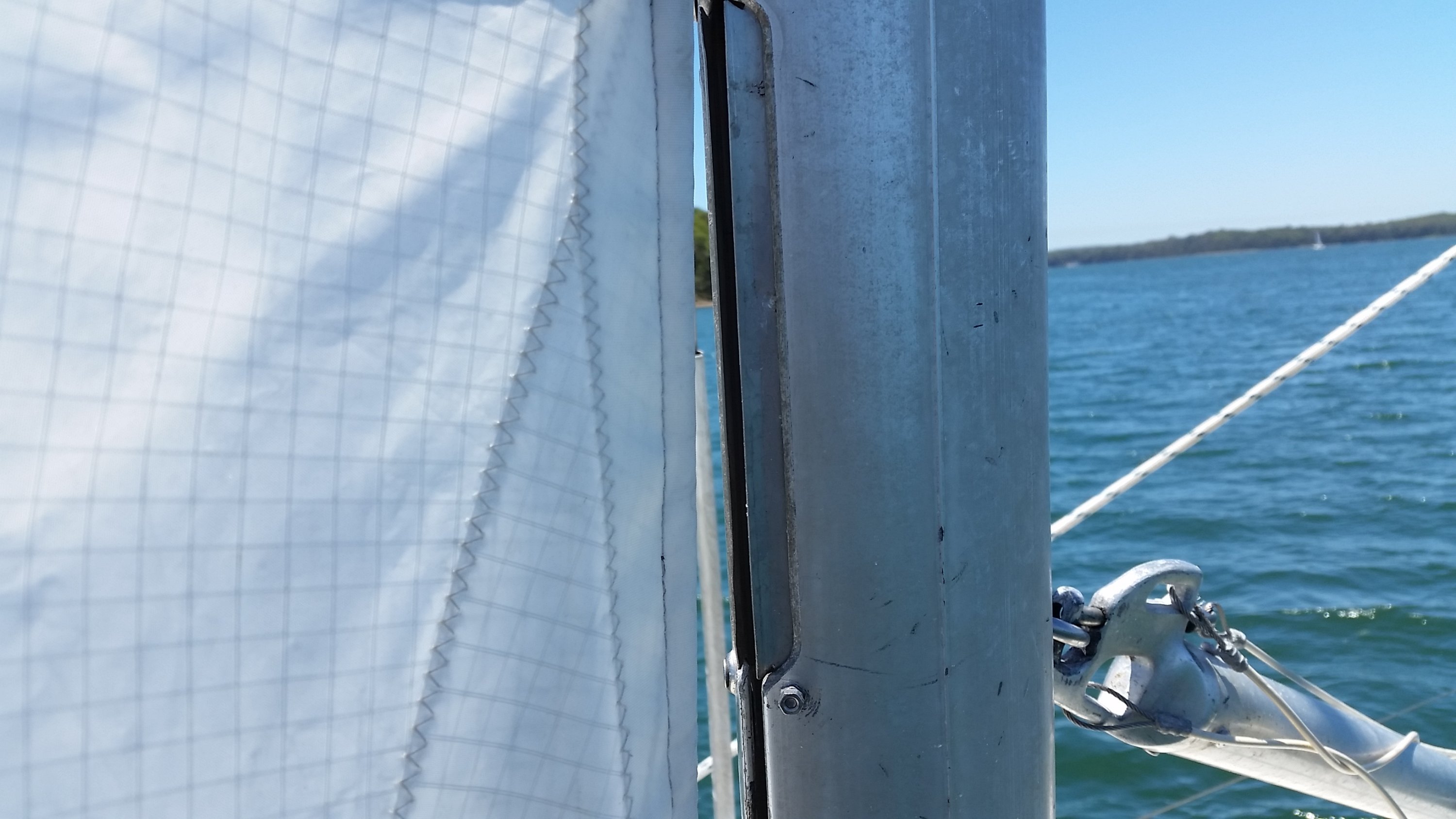

Y25,here is the way I've solved the problem of slugs comming out at the track'gate (see pics)
The trick is to provide a smooth run for
the slugs,cut(grind) out the inside end of the s
crews

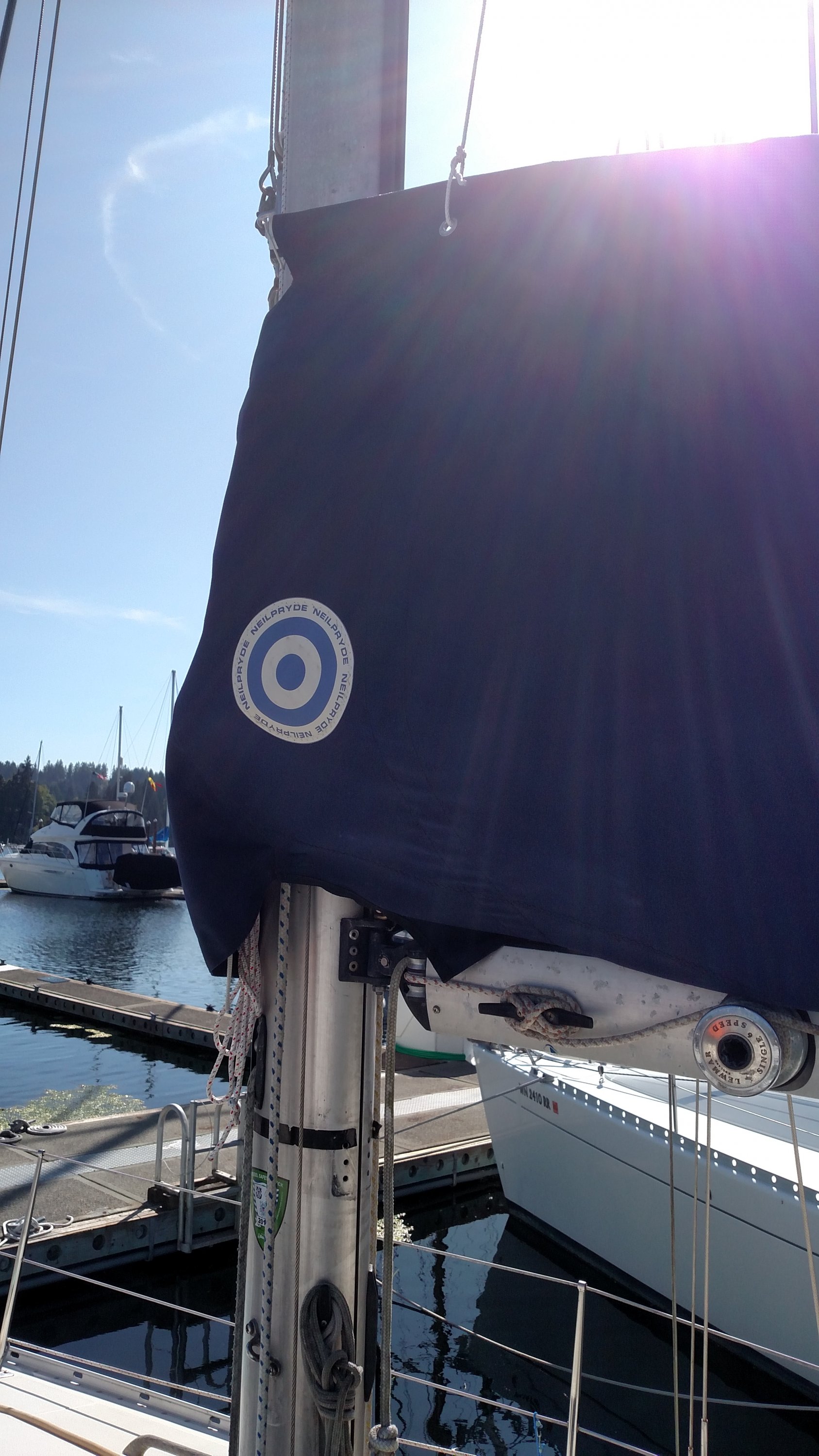

I realized that I never posted pictures of the boom move and new Lazy Bag, Strongtrack and sail. We love the new setup and I no longer have the possibility of the boom hitting me in the ear with an accidental jibe while standing in the cockpit.
