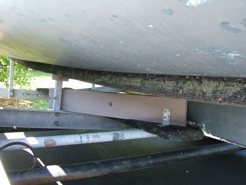

The aft part of my keel is currently sitting on the trailer cross brace. Evidently, the PO removed the boards that should be there to protect the keel. I got under the boat and tried to move, wiggle, or whatever the aft part of the CB and it would not budge. I am afraid it is putting pressure on the top of the recess it fits into, and may cause a crack.
My solution is to raise the bunks by 1-1/2 inches by placing a 6" piece of 2x6 pressure treated on top of each stanchion then replacing the bunks with new 2x8 pressure treated wood on top of the 2x6's, and bolting the whole thing together at each stanchion. Then add back 1x PT for the keel support. That should give me about 3/4" of space below the keel and the keel support board. I saw under the knowledge base where Pat Adam rebuilt his trailer but replaced the stanchions with 2"x2" steel to give 2-1/2 inch lift. I thought my idea might work instead of replacing the stanchions.
Comments are welcome and a picture of my situation is attached. Thanks..

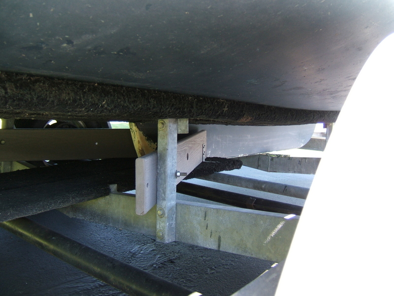

Here are some pictures I took some time ago. They show the "plastic" deck boards I added in a V to center the boat while loading.
I would ask Dave about how much weight the centerboard trunk can take and how the weight is balanced between the centerboard and the hull.
By the way, when I had the boat off last summer, I realized the boards the centerboard sits on were rotten. When I peeled off the carpet, they turned out to be 3/4 plywood. I was out of town and the local HomeDepot cut the plywood to size for me. I bought the new carpet there and tacks and a hammer and the install was easy.
