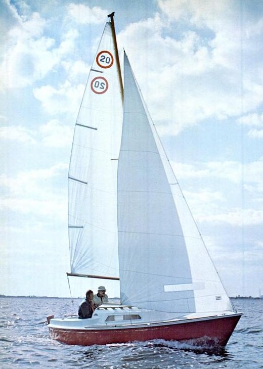

Oct 19, 2017
8,162
I would like to see pictures of your boat. Looking at images online of the O'Day 20, it looks like plenty of headroom under the boom.

14
Oday 20 Hilton Head
Hi Will, thanks for posting the photo. I agree it appears to show lots of space on this one. I believe they redesigned the rigging mid year 76. I have a fractional sloop with less clearance under the boom. I don’t have a good photo but will try to do some more research as well. Thanks again!
