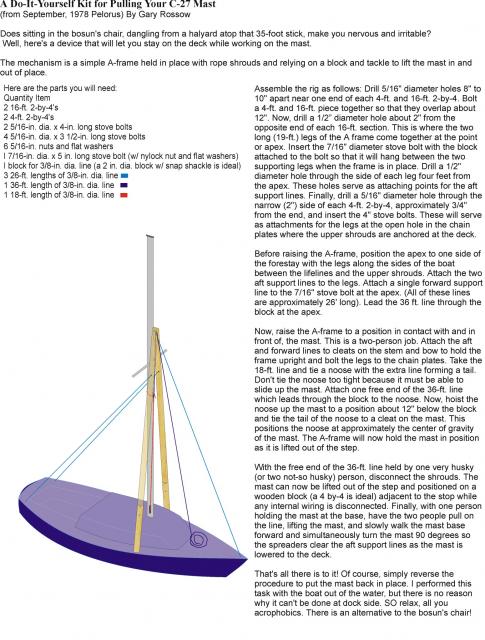

Just like everything else, the first few times will take longer, and if you really pay attention to the process, you'll find ways of shaving time.
We have prepping the 270 down to road ready in an hour and a bit, setup takes just over 2 because of the fiddle-farting with the loos gauges.
Oct 24, 2010
2,405
Hunter 30 Everett, WA
Similar to the link above, we used a pole on our MacGergor 26d. We could go from road to water in 20 minutes once we practiced up. That was with 2 of us working. Then we reused the block and tackle for a boom vang.

Well.... you could always try the A Frame method. But it might work better for you to install a hinged tabernacle mast base so you can rig some of the gin pole type systems if your planning on moving the boat often, If you park your boat in a marina they might be able to work something out for you....
