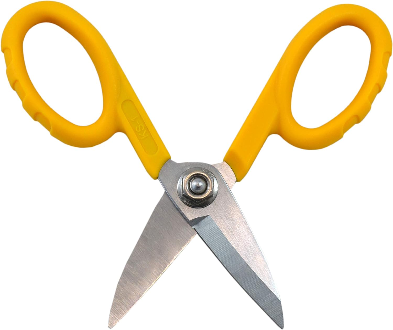

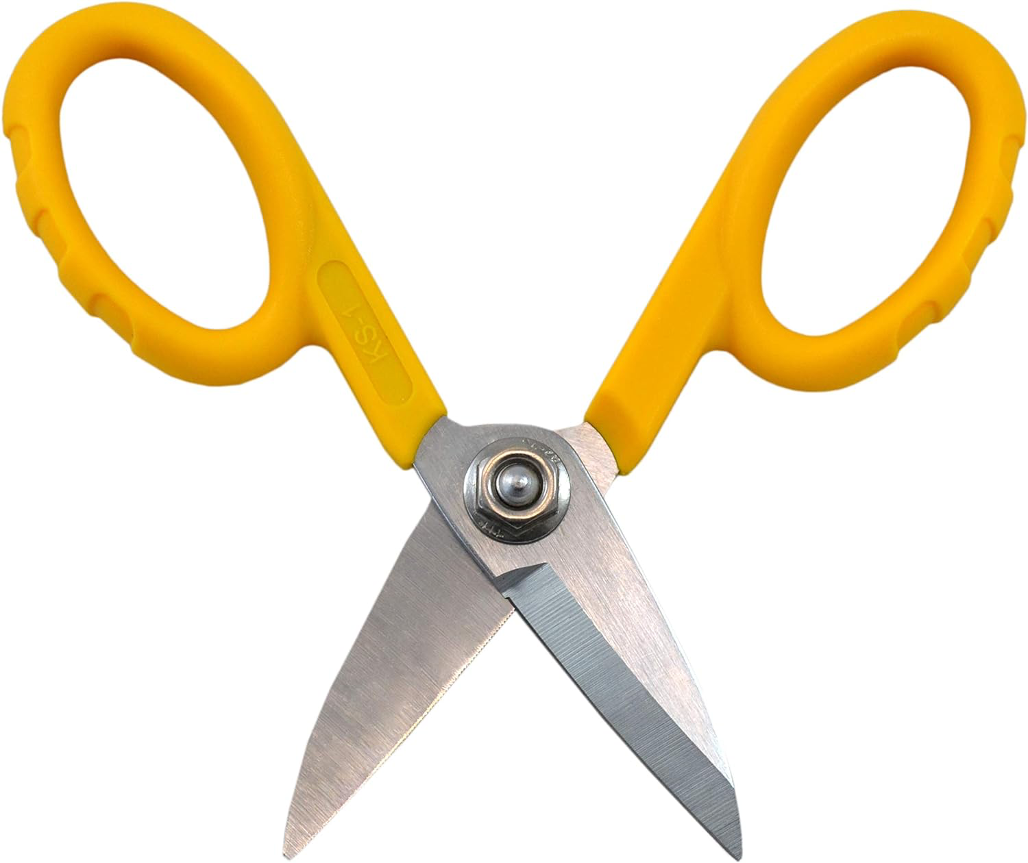

Great suggestion @Joe .
I have added these scissors to my bag.
Miller KS-1 Yellow Fiber Optic Kevlar Scissors
Safer than the ceramic knife I have been using. Go through Dyneema like a hot knife through butter. Maintain their cutting edge.
Might also add a couple of curved needles to your ditty. A stitch in time saves nine.
Awesome suggestion, I didn't know I needed those scissors until your post... ordered a pair just now, only $15 !

24,615
Just wait until you get them in your hands. It was an eye-opener for me. And I still have all 10 digits. Fewer nicks and bleeders on the lines.:biggrin::biggrin:
