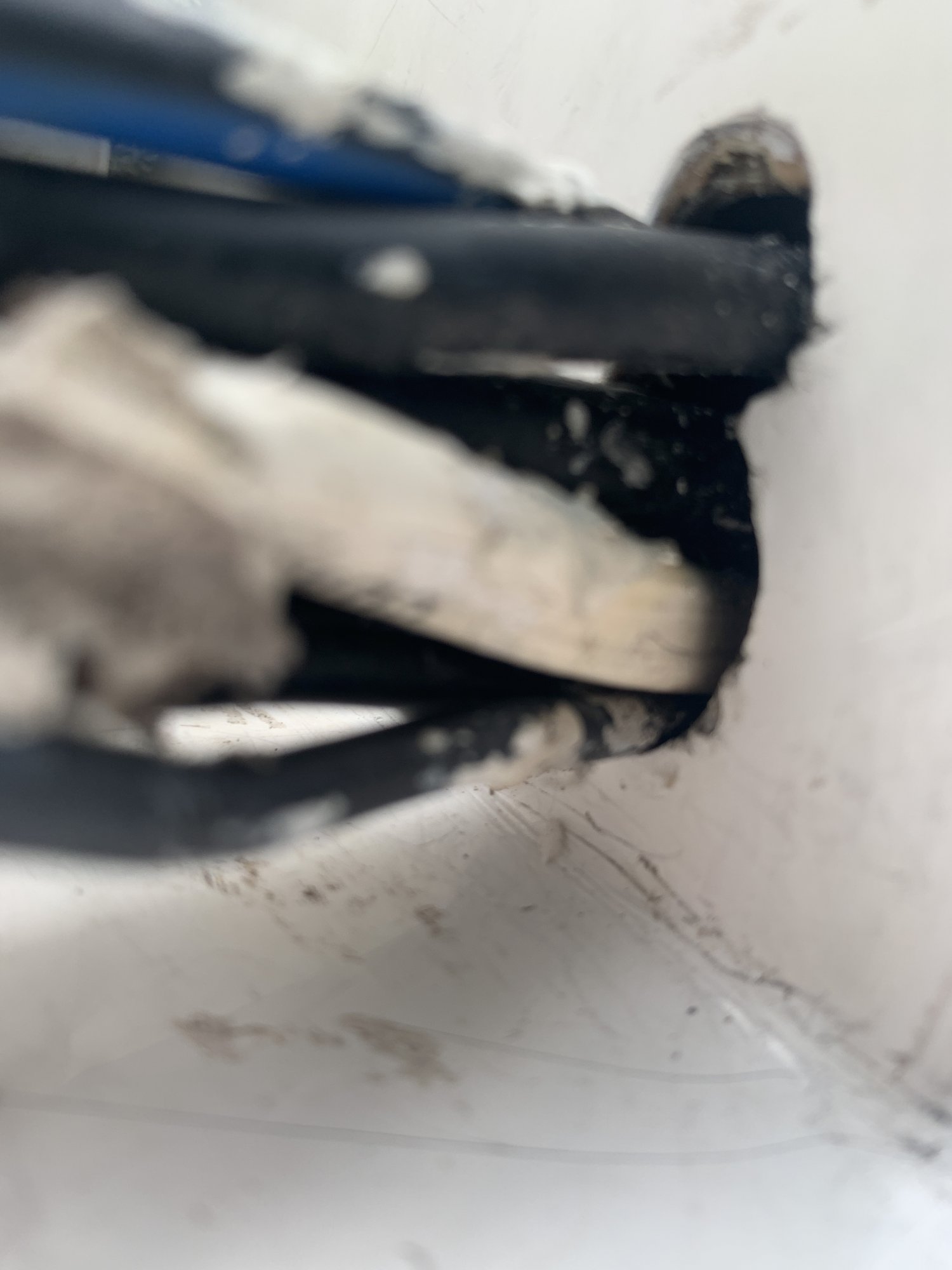

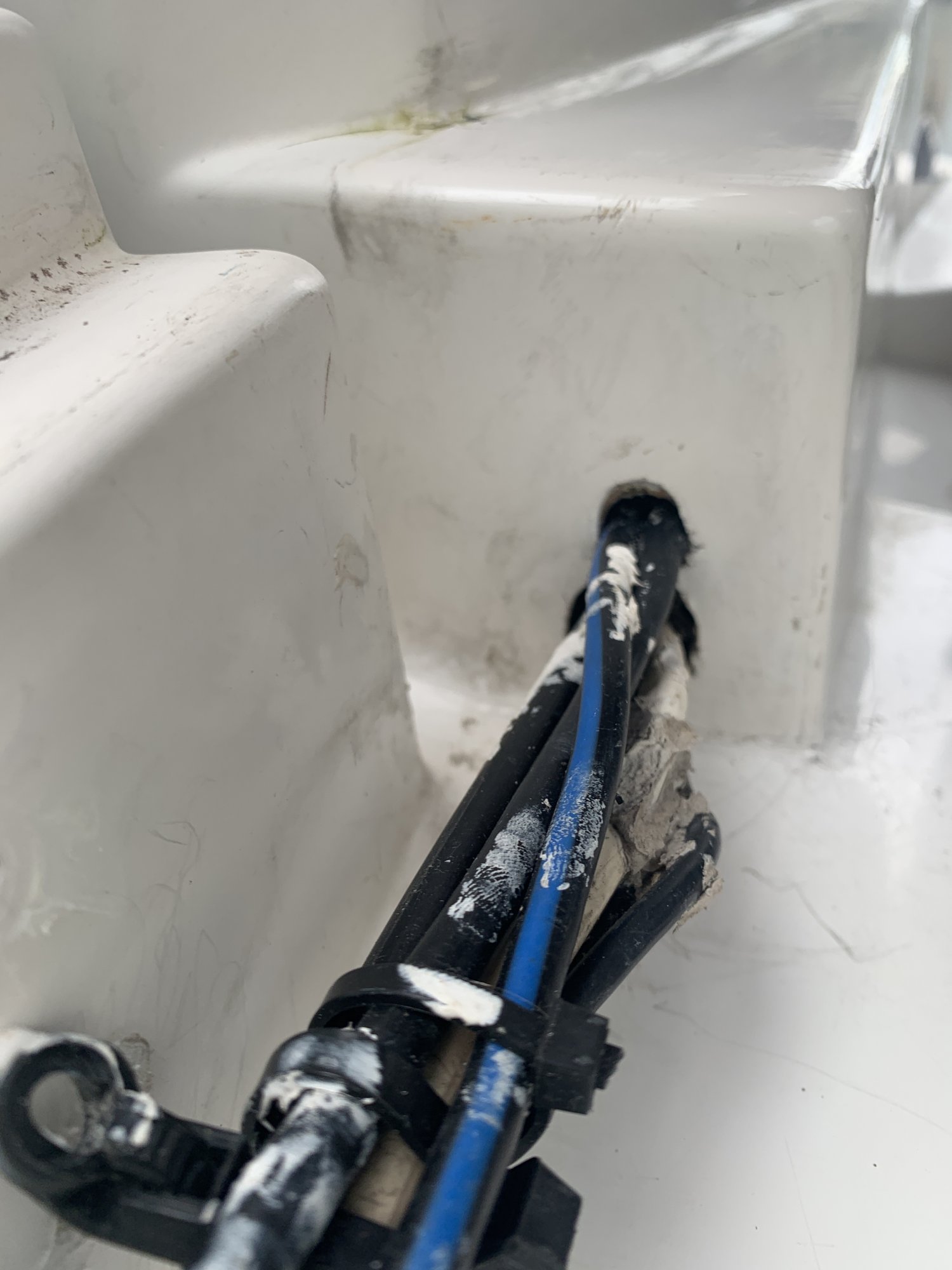

I finally got around to removing the old caulk around these wires. I found 3 different caulking materials that were used previously and no one had apparently removed older caulking before applying the new. The last layer was applied by the electrician who installed my autopilot (the blue wire) and I believe it was he who drilled the 2nd hole---the smaller one on top. After that the leaking started.
Wondering if anyone would alter their recommendation, after seeing the holes w/ the old caulk removed? I don’t necessarily need a “forever fix”....just need the best caulking or epoxy possible, something that would do the job for 2-3 seasons before needing to be removed & re-done. It was surprisingly easy to remove the old caulking, using a product called Re-Mov Silicone and Adhesive Remover.

Wow, you really do have a mess of cables! I am first thinking that it would be so much better if the cables passed through the deck under the pedestal where they are protected from water, but I'm guessing that when they are routed to the back they need go through finished space under the cockpit, so you don't want an exposed bundle of cables in your quarter berth for obvious aesthetic reasons. Perhaps there is a way to route it differently where they won't be in view????
My next thought is that I would try to first eliminate any cables that aren't necessary. You never know how many cables are added and abandoned in these routes over the years. I know on my boat I was able to get rid of several cables that were passing through in an unsightly bundle! And no, there is no way to keep water out permanently when water is traveling downward along those bundles. The silicone blob does work but is really undesirable for other reasons!
It looks like you could make a much neater bundle (or pair of bundles) with holes (or a hole) that are higher up that little wall. The upward passage of cables would eliminate that drip that you have going inside the boat. Instead, the flow would be backwards. I know, I know, who wants more holes! You would then need to fill or cover those existing holes ... but honestly, that looks like a butcher's job to me. I would definitely use those clam fittings for good measure. It may not be the easiest job, but I think you need to disconnect and fish all those cables out of there to start, and then do your repairs, prep and re-install (hopefully with fewer cables).

Scott--all of that is covered over by a removable section of cockpit floor. There’s only ~ a 1/4” between the lower hole and the “floor" of the starboard cockpit drain channel. (the close-up images distort the perspective....the “wall” there is only ~ 4” high). But a single hole could be drilled higher up, there is room for that. The problem is getting myself back to the connection points for some of these wires. I can’t shoehorn myself back far enough to reach the shore power connection (and I’m skinny, 6’, 160 lbs)...it’s right behind the fuel tank, with little clearance. The only person I know who could fit back there is my wife--and that will never, ever happen!

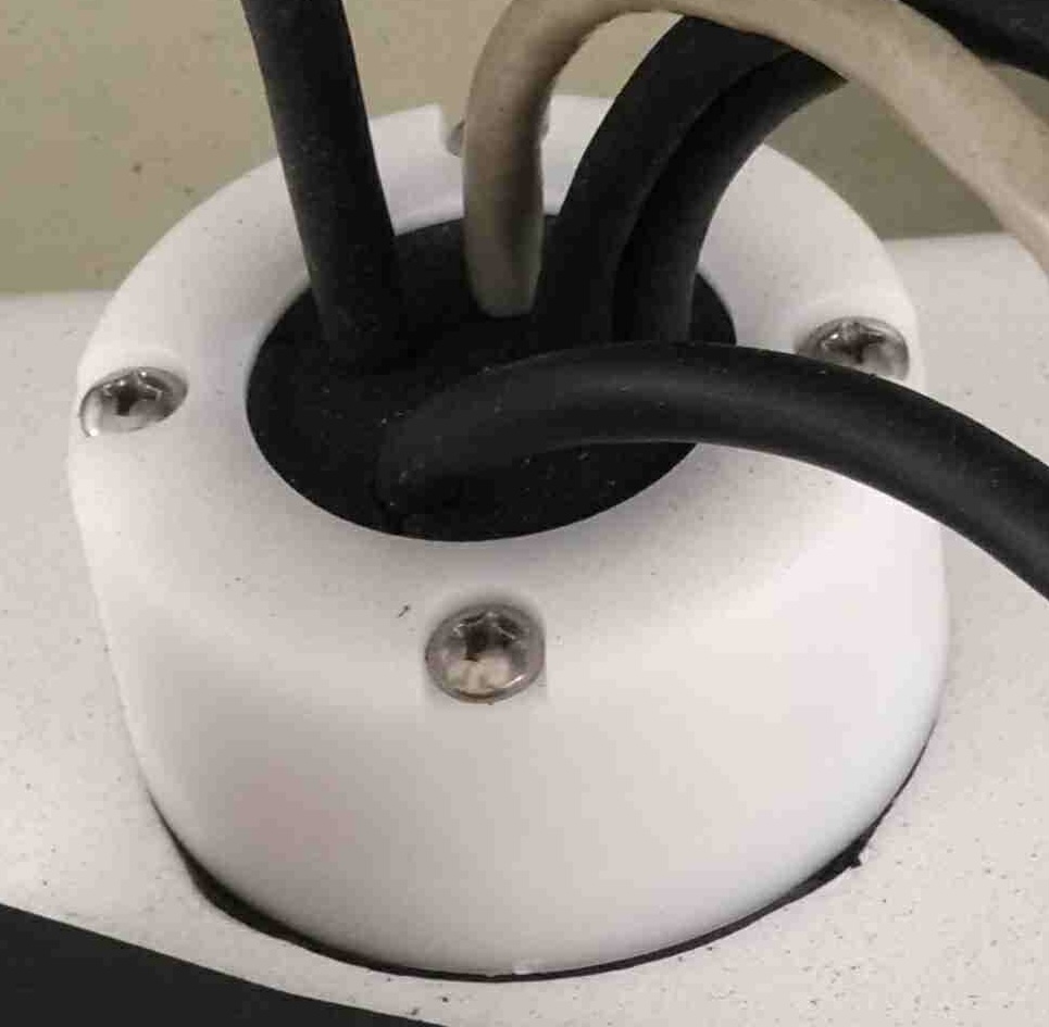

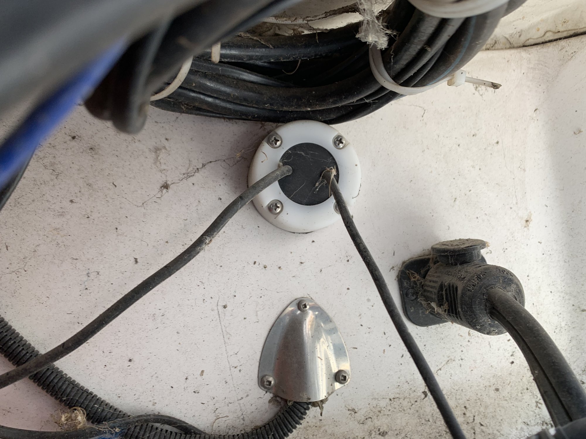

Cable clams can handle several wires per clam. Most instructions indicate to leave a minimum of 1/8” (.0125) of rubber between wires.
Not sure how many wires you have but suspect you could handle all your wires in 2 clams. The image with 2 wires is from my boat, you can see there is plenty of room for some additional wires. 5 or more are easily doable in the larger clams.
