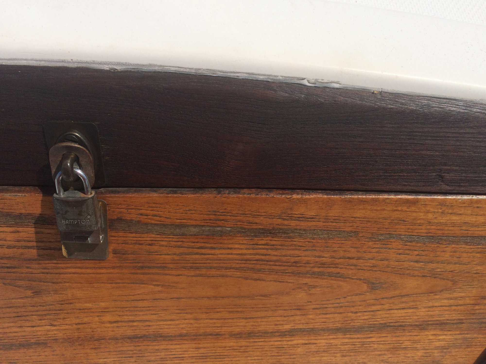

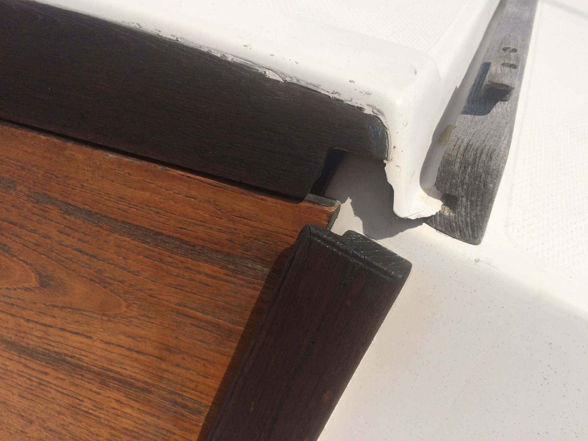

When it rains I get water coming in between the top board and the sliding hatch. The sliding hatch only closes as far as the middle of the top board. It does not extend over the top board. The rain also gets in at the aft corners of the hatch. I was wondering if anyone else has this problem and a possible solution. Thx

Ugh, that's gotta be annoying! Our hatch slides aft far enough to overhang the top board, we're not blessed with this issue.
Thicker weatherboard on top? Bevel the edge of the top crib board? I'll look at mine later and see if something else comes to mind. It'd be nice if that hatch just slid further aft!

Thanks for the input Gene! I like the idea of beveling the top board. As for the aft corners of the hatch so open I have to believe the fascia board on the hatch has to be post marketed by a previous owner. Looking closed it appears hand cut. Again thx for some ideas. Was hoping I didn't have to think so much after retiring. lol

Here's what I'm driving at:
The lips which support the sides of the sliding hatch gradually wear down over time and need to be built back up. Your lips look pretty thin, judging by the pic above. They will eventually crack when someone steps on the slider, especially at one of the corners.
If (when) you build them back up, it will raise the height of the sliding hatch, thereby allowing it to slide further aft.
It's not a difficult project, especially if done before the cracking begins. My own experience: Sliding hatch "lips" cracking

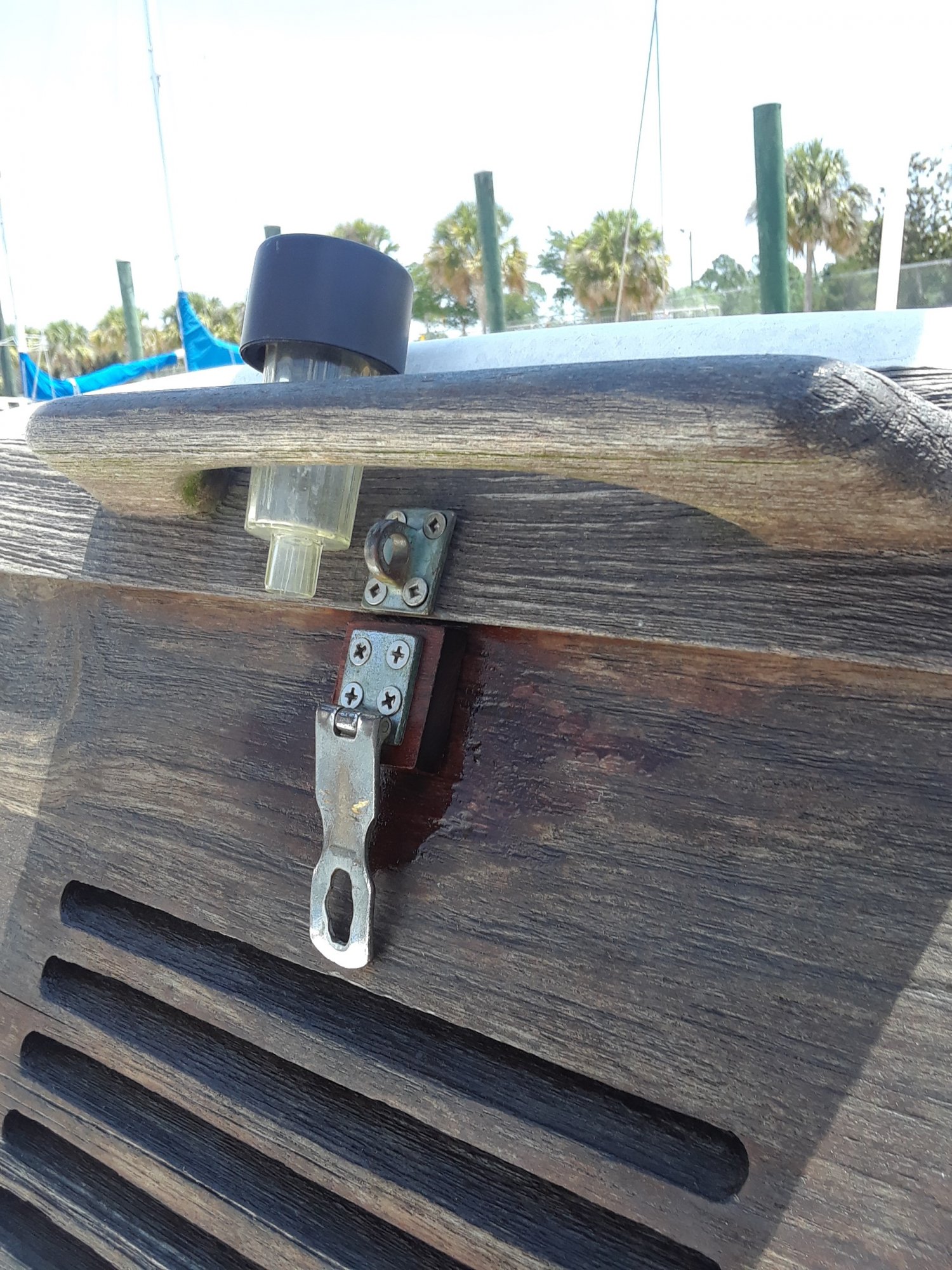

Put a small block under where the hasp mounts on the top board and when you lock it up the slider hatch will overhand and solve the problem , see photo. Bonus idea solar walk light in handle lights up combo padlock at night.

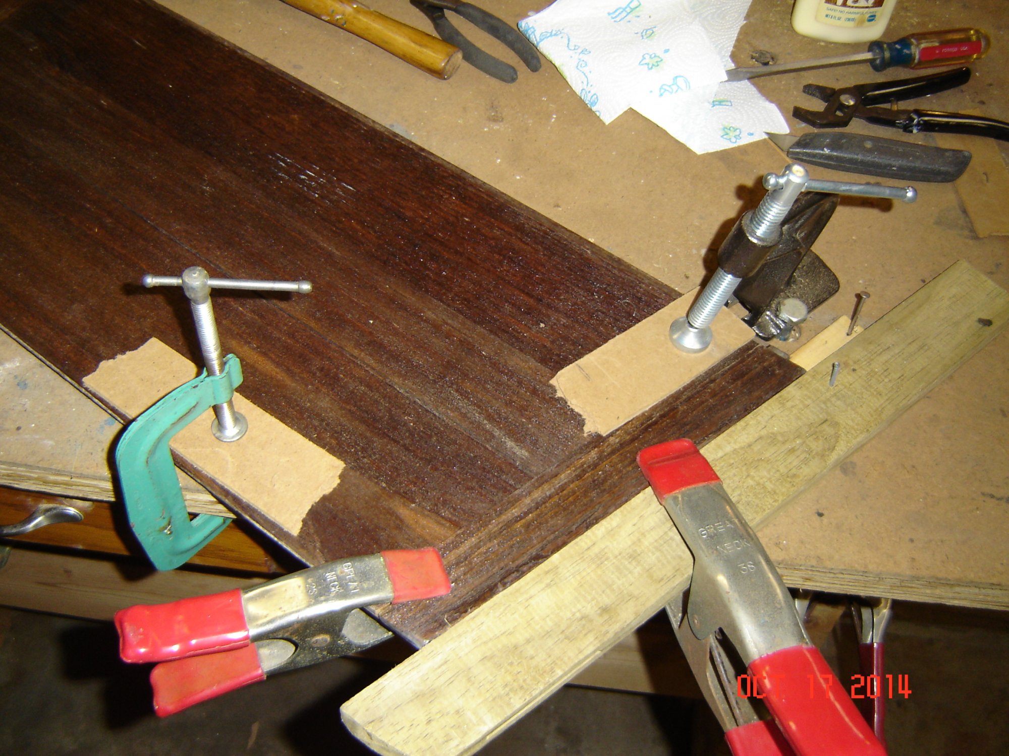

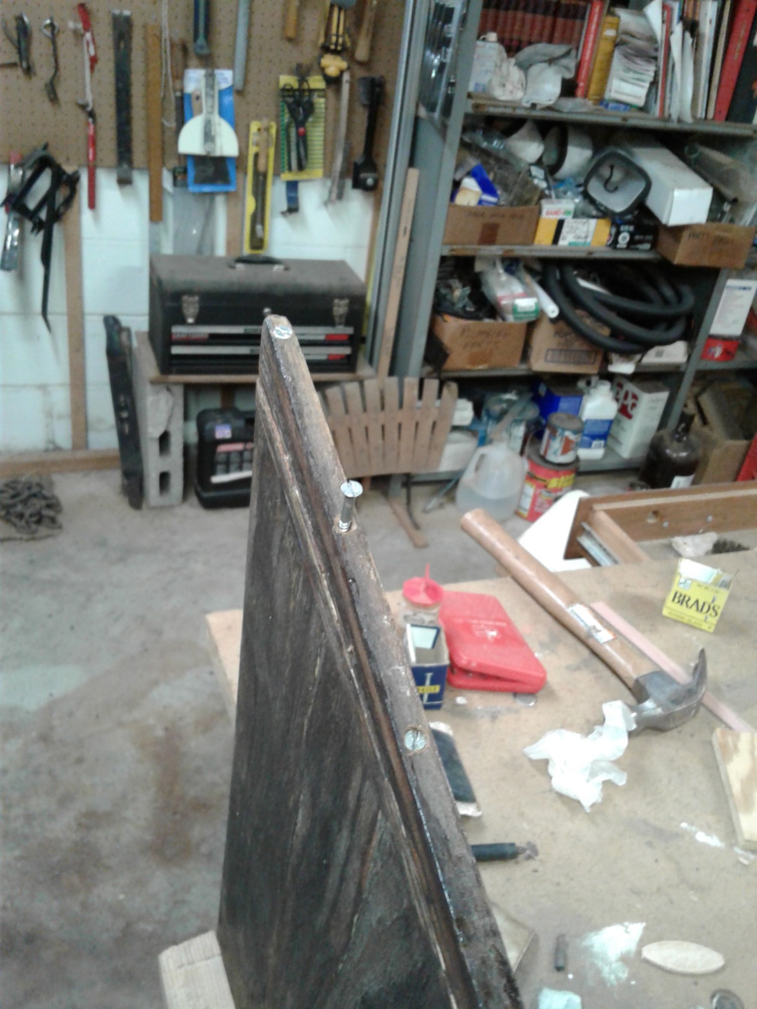

You lucked out because the sliding hatch board on my boat is thin from age so did not overlap properly until I put in the spacer so it slides a bit further out when I latch it. I have by the way had to rehab my crib boards several times including putting in biscuits to reattach the side boards to the middle, and screws in from ends, see below.
