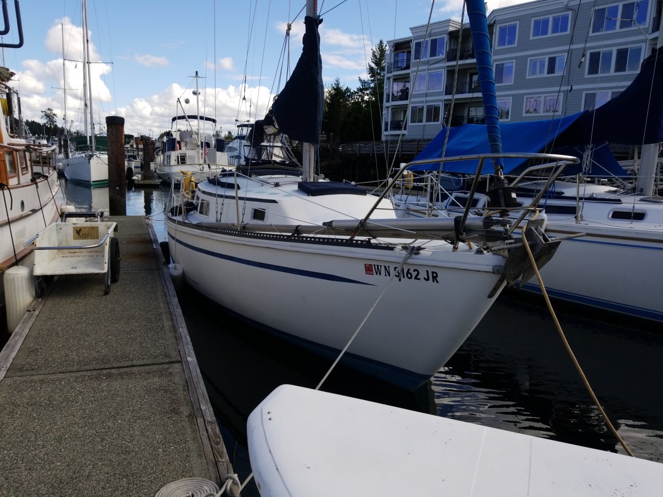

Day 3, super early and exhausted we fired up the Atomic, it started up like a brand new one, and off we went. The picture above was Manchester's little dock. Today would be the shortest of our days and it was a good thing. With last nights lack of sleep both Nick and I were feeling a little rough and morale took a little dip. Right about then we ran out of smokes and vodka. Terrible for morale hahaha! The only thing we had plenty left of was healthy stuff. We ran out of all the fun stuff. Some rain on and off and we found ourselves motoring along the west side of Vashon Island. Familiar territory to me from my Montgomery 17. Ahh theres the entrance to Gig! A nice sight. Nick and I agreed that a 4th day would have sucked. Probably just the sleep deprivation talking. Anyway we pull into Gig and my son met us at the public dock as he hadn't seen the boat and wanted to get to Murphys Landing Marina with us. That was a nice treat, and as it turns out, very fortunate! Deep into the harbor we find Murphys and start circling around the outside getting the lay of the land, and trying to determine exactly where the parking spot was. I had surveyed this just before leaving from the marina, but of course from the water, whole different ballgame. Care was in order and I made sure to know sorta where it was before proceeding! Just about to turn into the alleyway of million dollar boats and I decide to slow a bit with some reverse...nothing! No brakes mom! ABORT! ABORT! Quick turn to starboard before the water gets really shallow and out to the middle of the harbor we go. Once again I'm driving and Nicks diving, into the engine well. The problem was the clamp on the transmission cable had come loose and allowed the cable to move and not push the lever on the tranny. We messed with it a good half hour and just couldn't make a fix out there without dropping anchor and getting serious. This is when I remembered we had picked up a human clamp at the public dock! The little man goes down, and we practice him pushing hard on the cable when I needed reverse! Score! I wanted Nick up top to catch us if I was going to crash into the dock or a boat. Never too careful on your first docking on a new boat twice the size of your last boat! I cannot tell you guys the stress I was feeling as I eased into million dollar boat alley! I land 737s I got this... I got this...positive self talk. Turns out I did have it. The human clamp worked flawlessly and Ragamuffin eased into her new house. RELIEF. That last part could have gone really bad had I not discovered the reverse thing before turning in.
