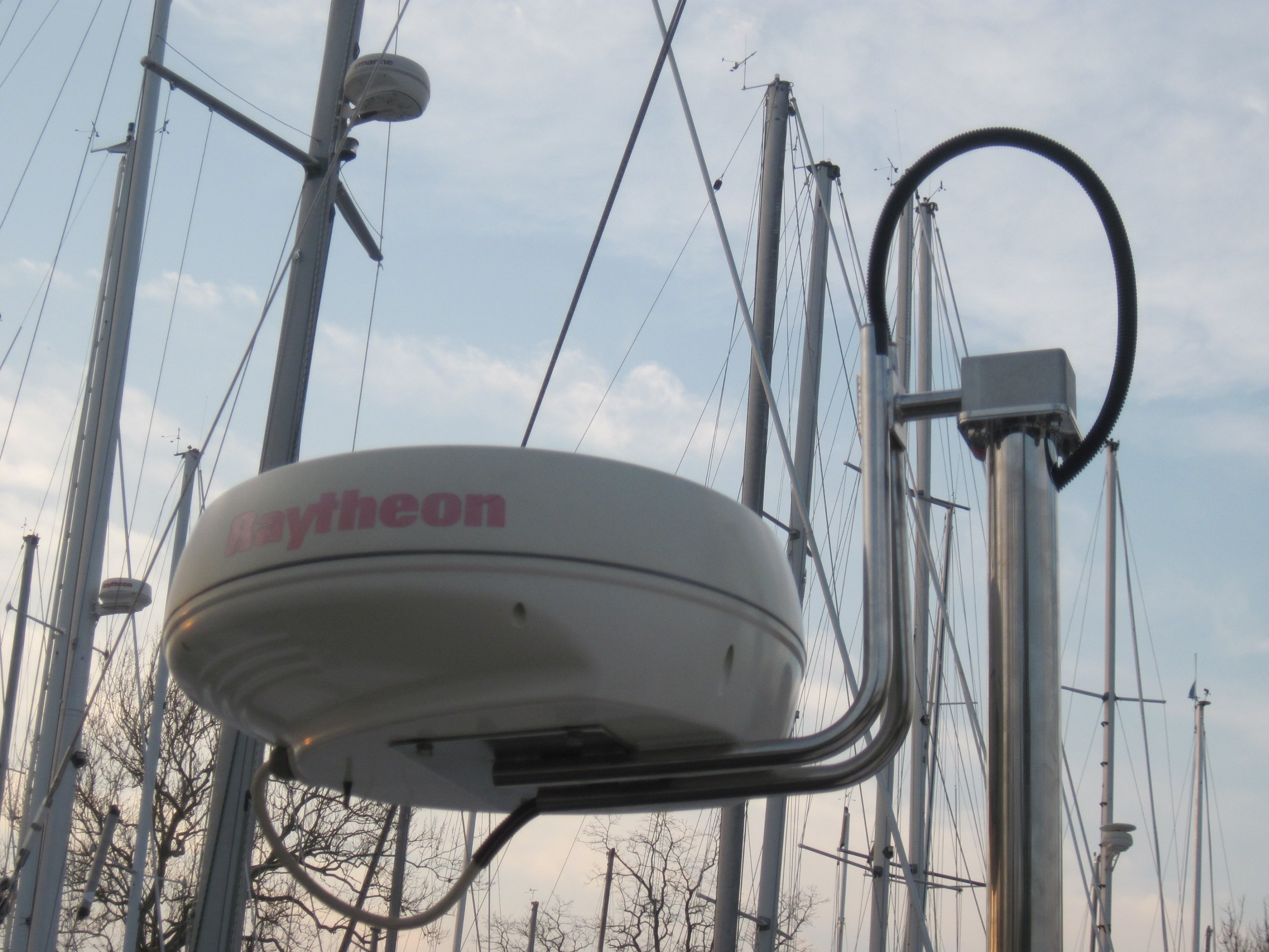

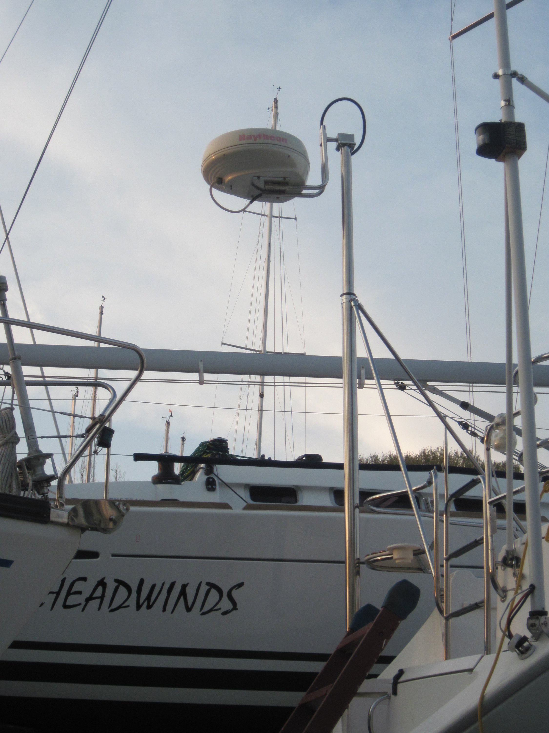

When I installed my radar many years ago, I chose a back-stay mount that was self-leveling. The self-leveling characteristic is excellent but the back-stay mount was problematic. The constant movement caused wear of the mount at the base and was a constant maintenance issue. I didn't want a mast mount because I didn't want to drop the mast to attach and run the cable inside. My boat remains rigged year-round.
I have changed to a Kato stern pole and could not be happier. I adapted my self-leveling mechanism from my back-stay mount to the pole so I still have that important feature.
IMO the advantages of a stern pole mount is that it is easier to run the cable to the helm and if maintenance is ever required for the radome (mine did require a repair) it is easy to get to the unit. The only con is that the max radar range is about 4.5 nm instead of 9-10 nm. This range is to the water's surface; the range is longer to higher land or a large vessel. Since I use my radar on a 3 nm range most of the time I don't feel that the max range is an issue. BTW, I routinely use the radar on the 72nm range to look for thunderstorms- no problem with range here because the storm clouds are high.
