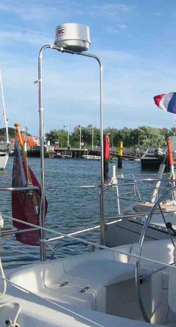

Much as I hate to buy just before digital units come out, I'm beginning to think radar is essential to my cruising plans this summer and starting to think about installation. Mast mount is out of the question this year. Too much major surgery for the cable runs to do in time. I'm not sure I want to drag my jib over it all the time either.
I see plenty of boats with the radar mounted on a stern pole. The Garmin manual says to keep everything out of the beam. How serious an issues is this?
There is no convienient place for a pole mount on my boat with all the real estate taken up by the wind vane and narrow side decks. The weight of the vane gear also makes keeping addional weight to a minumum a priority. I'm thinking about using Bimini tubing and hardware tubing to make a light arch mounted on the stern pushpit railing. I haven't had my hands on a Bimini in years but it seems that, if they can hold the canvas tops in place in a sailing breeze, they should hold an 18" radome. Any Bimini owners have an opinion?
I would probably need some additional stiffening struts that are not shown on the drawing above. Whatever it is, it's got to be quick and easy to construct if I'm going to do it this year.
