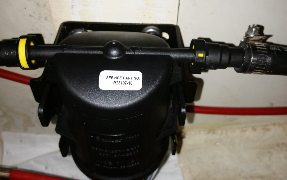

533
Catalina 270 Ottawa
I got tired of the leaks and the expensive replacement filters. I switched to Racor's SNAPP filter. Very easy to install and change (it has quick connects on both ends).

@SFS - prices are waay different up North here. My replacement elements for Racor 250 were around $60-$70 (CAD) and the SNAPP filters (I cannot order a replacement unless in 12 packs), are around $50. I had to replace the filter (the 250 leaked badly), so I went for the ease of maintenance. I had to work with the limited supply that was available.
If you are cost conscious, the best way is to use one of the filters with a replacement filter element (cartridge) that is just the paper element that resides in the glass or metal housing. Any spin-on or disposable filter would be more expensive.
