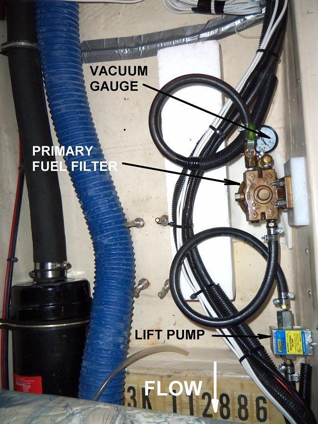

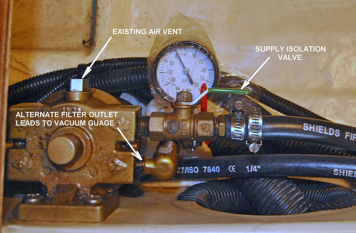

I tore the whole thing out and cleaned it up making it easier to change out the filter element:
Top notch job too.:clap:
You even have 2 loops in the fuel lines.
Those loops allow you to remove/inspect the entire Filter unit without removing the hoses.;)
Jim...

Mine is close to that hence the insertion of the local shut off valve before the primary filter following the second filter element change.
