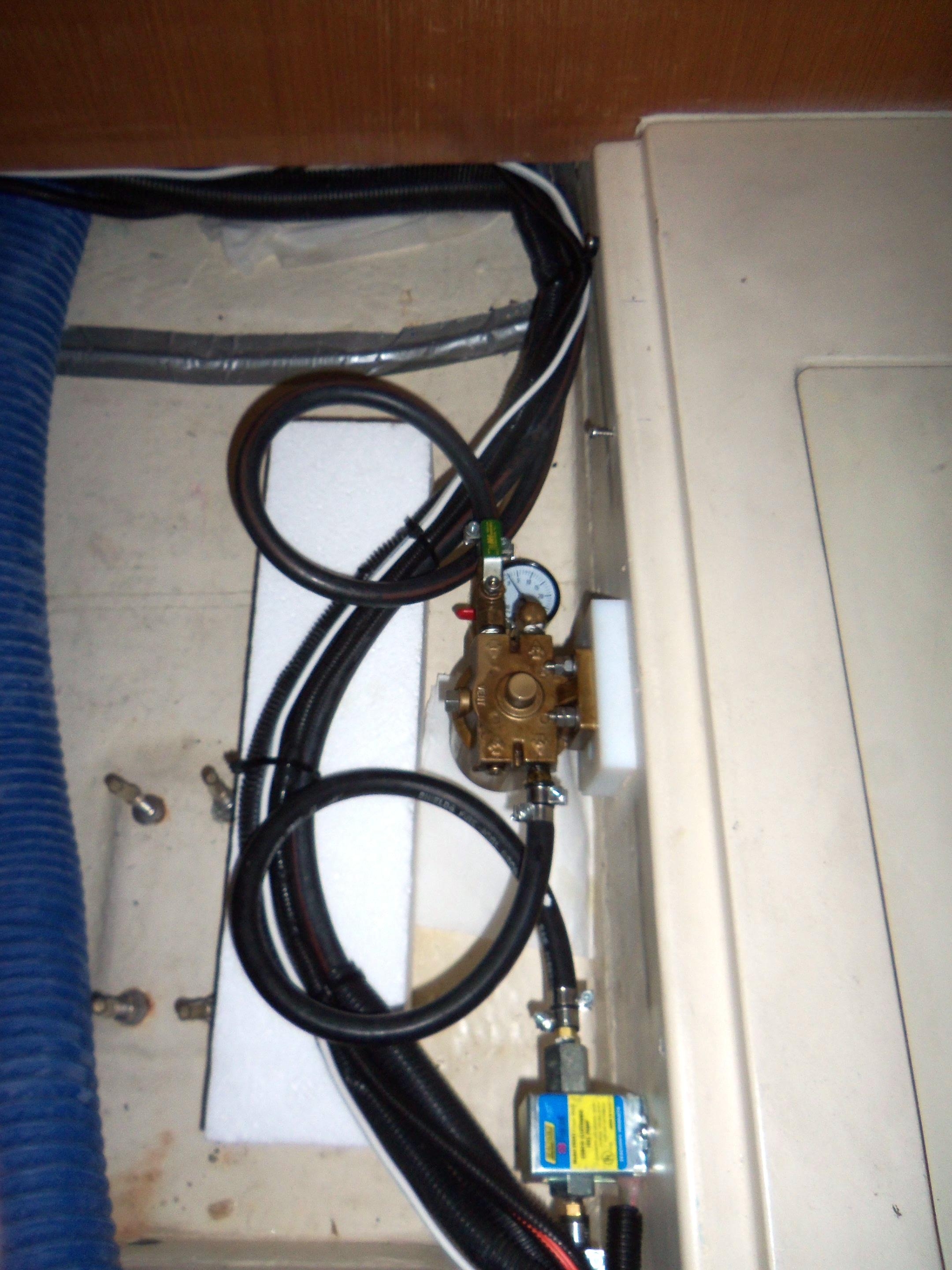

Here's an idea which may or may not work depending on your filter location. My factory installation was difficult to deal with in that the filter sat over a bundle of electrical wiring going to the engine. It was all jammed together and a real bear to cover the wiring with poly and rags before opening the filter.
When I installed an electric fuel pump last year, figured that was the time to change out the filter for better access. Installed a plate of 3/4" Starboard with a few studs sticking out of it and mounted the filter on it. This is about one meter aft of where it sat before.
Now it's just a case of undoing a couple of nuts and the filter sits in your lap where you can work on it without slopping fuel around. At the above point, there is only about 1/2" under the body so the element can't come out unless the whole filter is removed. (The double nuts were only temporary until I could find some lock washers). I have a short bar to which I attach the filter in order to get a good grip on it to loosen the housing. The white block is styrofoam to support the wiring and other etceteras.
Still seems like a real pain for a simple filter change, but far, far better than what was there before.

Nice touch with the loops Ralph. That makes it really easy to change!

Ralph, maybe put a hinge on the mounting board? You could tilt the filter to drain and remove.
