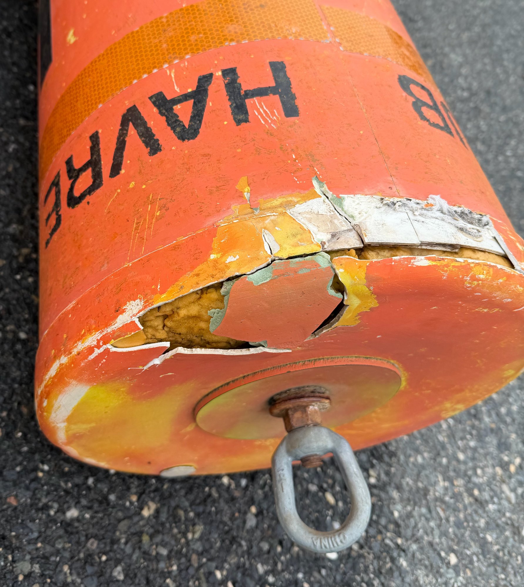

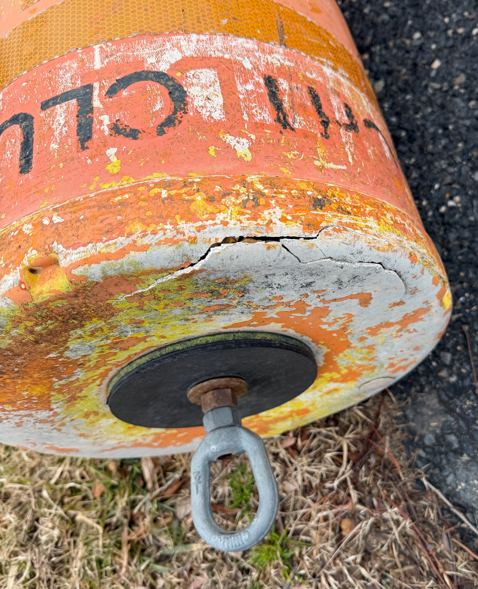

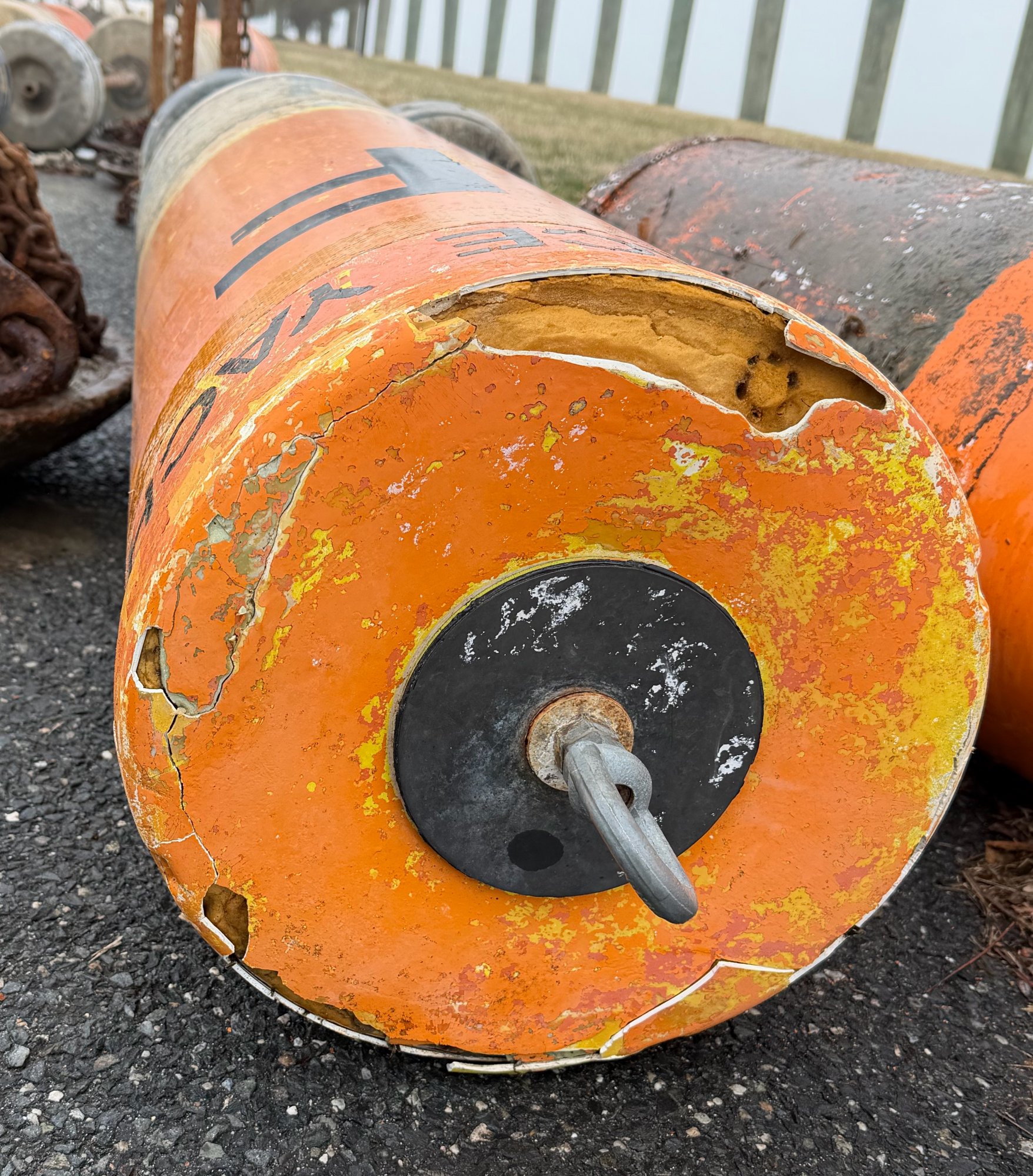

Three of our club’s racing buoys had a tough winter and developed cracks around their upper edges. The mark shells are ABS plastic, probably about 1/8” thick. The foam inside and bottom part of the shell seems to carry most of the loads from the chain and ballast; I don’t think the upper edges do too much structurally, though I’m not sure.
We’re going to try to repair them next weekend. My plan is to use two layers of 17oz fiberglass tape wrapped around the cracked parts of the edges and TotalBoat 5:1 epoxy. I’ve used 17oz biax and the 5:1 before on fiberglass dinghy repairs but never on plastic like this. I see West Systems recommends sanding and flame treating ABS for best adhesion. TotalBoat seems to say either flame treat, sand, or acetone wipe. I’m definitely going to sand; I’m not sure about the flame treating.
Anyone have experience with something like this and know of any gotcha’s I should watch out for?

Try using West System G-Flex epoxy, it will adhere to plastic.
The shell should not be carrying any load, there should be a metal rod connecting the eyes at the top and bottom of the mark.

I've repaired plastic kayaks, sailboats, and fishponds. Some of the repairs are 20 years old.
I doubt the ABS is rigid enough to take a fiberglass patch. Conventional epoxy will peel off. G-Flex will do much better. The plastic is old and sunburned; welding won't work.
On something like that, I've had the best luck laminating using polyurethane sealant (Locktite PL S40 Window, Door, and Siding is cheap from Home Depot and adheres better to plastics than Sika or 3M, PS testing) and used Sunbrella (new Sunbrella has coatings that interfere with bonding) as the fabric. Sand. Flame treat. Then slop on lots, sort of like papier-mache.
(PL S30 is the same project in black. This was 10 years ago. Other repairs have lasted 20+ years. Use lots and prep carefully.)

I agree, most epoxy will not adhere to the plastic, g flex should do better. Be sure to paint afterwards. It is not uv stable.

I wouldn't use fiberglass. ABS is weldable with acetone, and the job is super easy. A solvent-welded repair will be stronger and more permanent than fiberglass. For the same thickness, it will be as strong or stronger than the existing structure.
Get some scrap ABS from anywhere. If you have to, you can buy sheets of it for cheap, but chances are you have some laying around.
  1. First, sand off paint around the repair.
  2. Shred/cut the scrap ABS into the cheese-grater sized pieces.
  3. Mix in acetone a bit at a time to dissolve the ABS and create a slurry of the desired thickness.
  4. Wet out the area of ABS surrounding the damage until the ABS develops a generous sticky layer (dissolved ABS).
  5. Use the slurry to fill cracks.
  6. For your large area(s), you might need to lay in a piece of sheet ABS cut to the approximate shape of the hole. Just wet both surfaces until well sticky, then stick them together with slurry.
  7. Fair everything out with slurry.
  8. Let it sit for a couple of hours to completely dry
  9. Sand
If you fill and sand well, and paint over it, your repair will be invisible and permanent.
Looking at that pattern of damage and not wanting to repeat this repair every so often, I would be tempted to cut a circle out of 1/4" ABS with a diameter a few inches larger than the buoy and, with a heat gun (and good ventilation) form a cap that goes completely over the top of the bouy. Then, solvent weld it the top of the buoy - completely covering the damaged area and making it much beefier.
