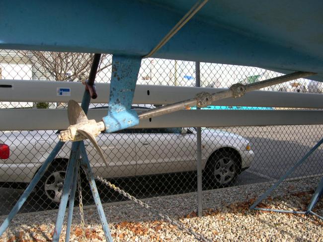

I would like to replace the two blade 16"x10 prop in the photo with a three blade, most likely Kiwiprop, feathering prop. For what its worth, boat is Pearson 34 1985 w/Yanmar 3GMF 21hp & Kanzaki KM3-A transmission, Ratio 2.6/1. 1.125" shaft. Because the boat is 5 hours away & I will have one trip, in a couple of weeks, before she goes in the water, I am wondering about pitfalls on this seemingly simple job. I have a variety of pullers available at my shop (I run a WW business). Shaft is stainless, I think the existing nut is bronze. Am I likely to run into corrosion problems holding the nut fast?

Stuff to bring: Wrenches of correct size, propane torch, pliars to pull pin, hammer. You will need to find a way to keep the prop shaft from turning. Using a spare boat stand attach the prop in such a way to prevent it from spinning while removing the nuts. Do not try and use the strut as this could bend it out of alignment. Use the hammer to lightly hit the wrench to break the nuts loose. Back off inner nut til it is flush with end of shaft(prevents mushrooming). Use puller to apply moderate pressure tot he prop. heat the body of the prop only. Tap the end of the puller which is applying force to the end of the shaft. Be carefull as the prop could suddenly pop off during any part of this procedure. Nice Audi in the background. I have owned a few. My latest is an original '95 A4 in mint condition. Tim R.
